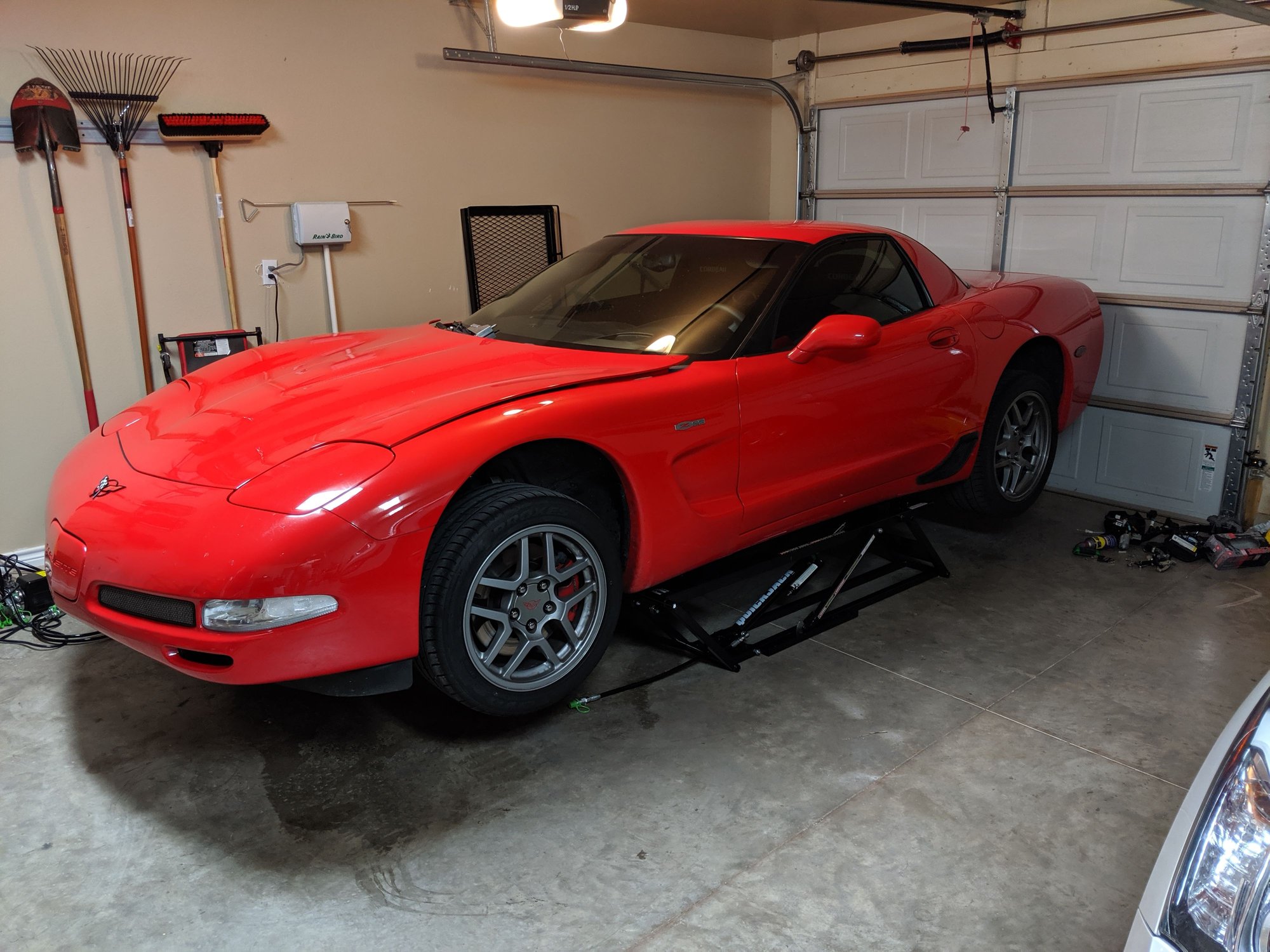

I just saw your follow up posts. I've used a friends 3000 model and now my 5000 and I've had no issues. The SLX is the standard model and the EXT is the longer version-- are you sure it's the SLX? Here's a pic of mine recenty

Yes I have the standard 5000 SLX. So yours covers both puck points?

I went out and did some quick measurements. It's around 37 38" between jacking points. Minimum spacing distance on the quick jack seems to be around 35 36" on mine. So not a lot of wiggle room and Jack placement has to be spot on but no issues getting it work and line up.

You're right damn I'm an IDIOT! The double tray in the back (or front depending on how you orient your jack) had me fooled. The one end has a single tray and the other end a double. I was trying to mirror the one tray end, not not noticing that they're different. Thanks for helping me through this.

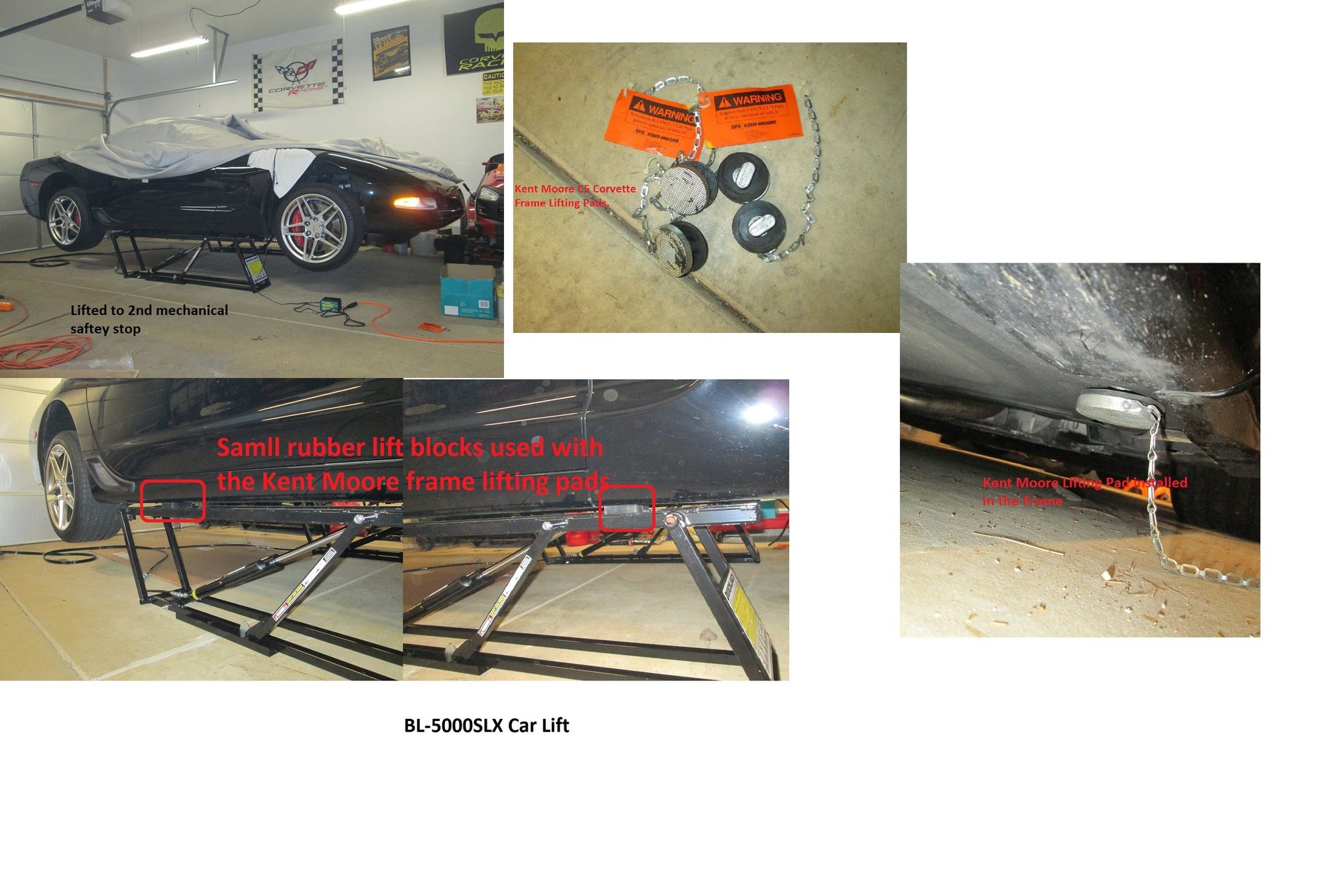

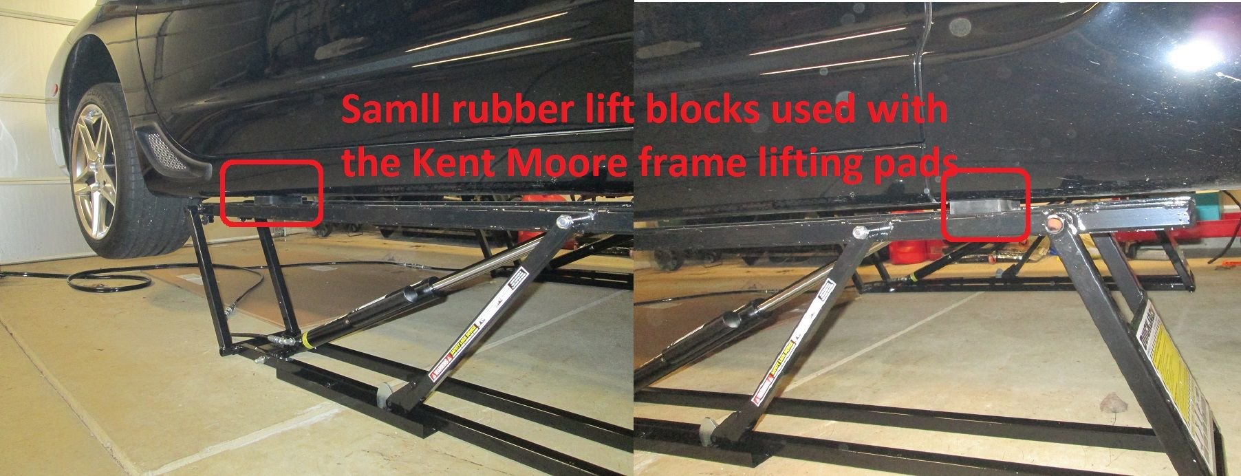

This is the best pic I have showing the spacing that I use.
