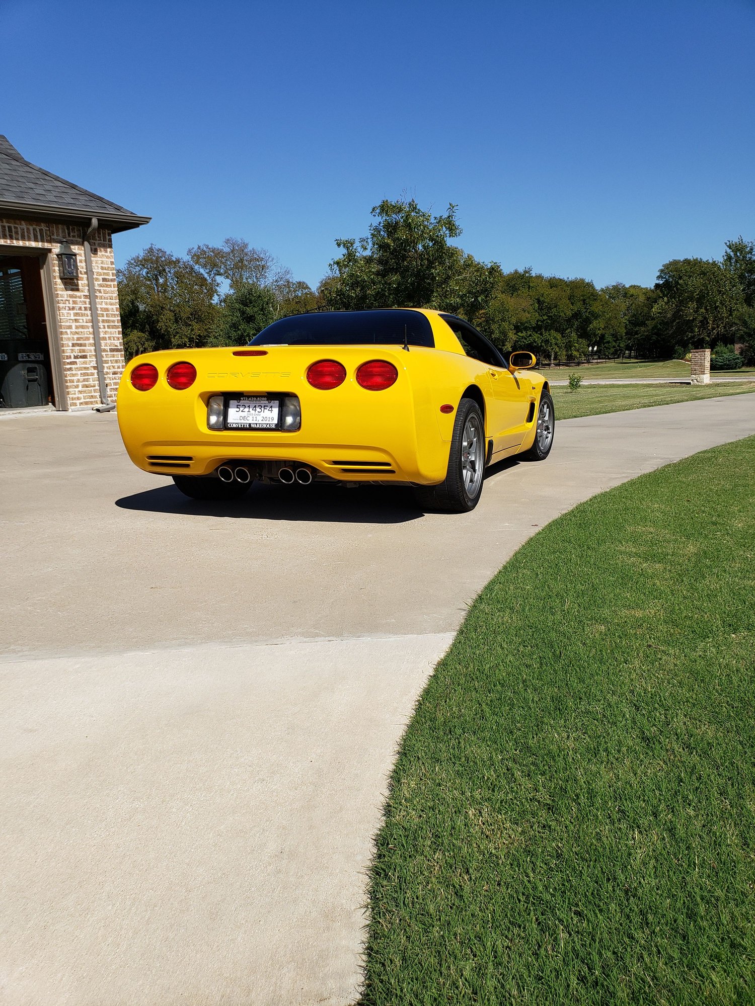

Originally Posted by robski2
That's good to know Clint and Mellenium. I thought I was missing something. And I guess BIG TIME it's how to treat and take care of the car. Mellenium I live in Rowlett and have a copy of your Z. Let me know if you go to any car shows or cruises.
Small world, I'm in South Garland around the corner from you. Mine is yellow with mod red interior as well. Freaking sweet!
