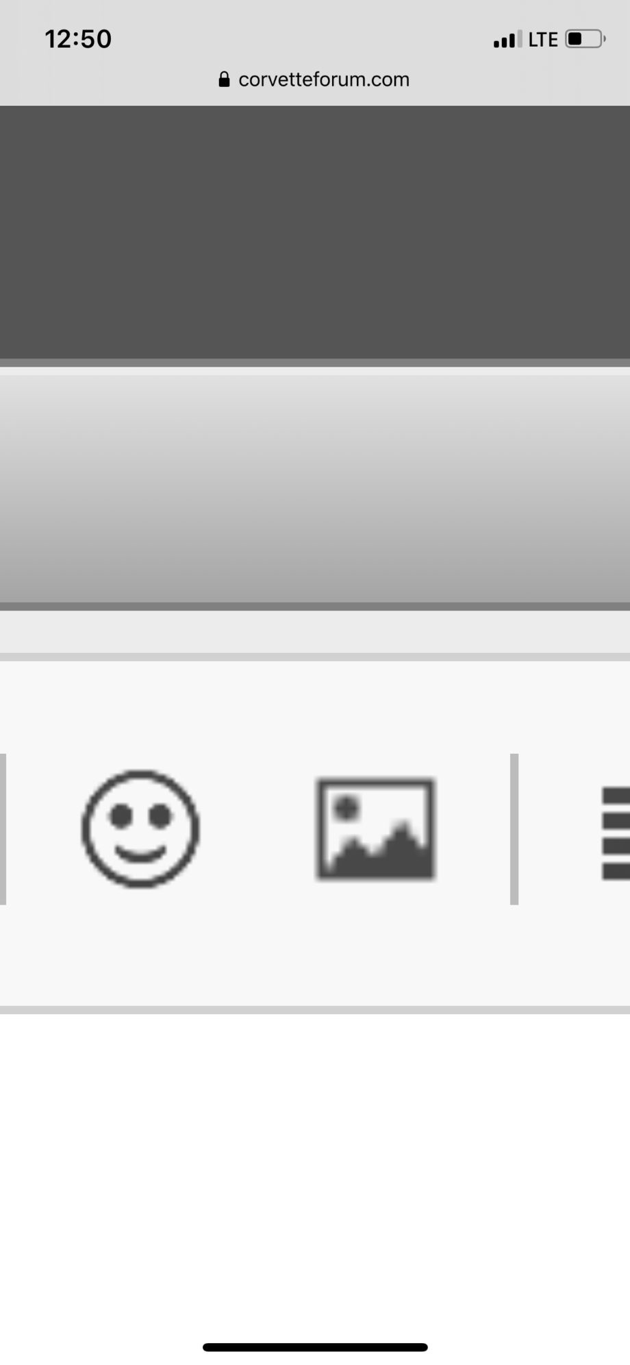

Originally Posted by 91quasarblue
Haven’t been on this forum in a long time how do I post pictures
If the picture is on your phone...
click reply, touch the picture icon an select From Device, choose picture(s) you have and when it loads 100% click the top right button Upload and it will be hosted here.
Old Jan 6, 2020 | 12:54 AM
~Josh's Avatar
~Josh
Banned Scam/Spammer
Joined: May 2007
Posts: 15,685
Likes: 1,330
From: Machineguns, because I don’t compromise
the picture icon next to the smilie face.

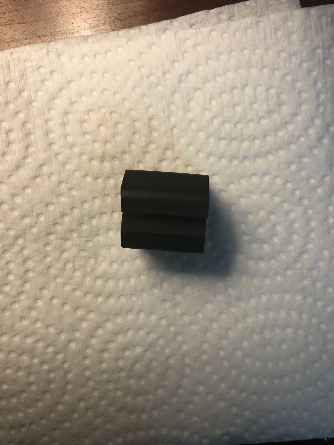

This is the rubber grommet im talking about

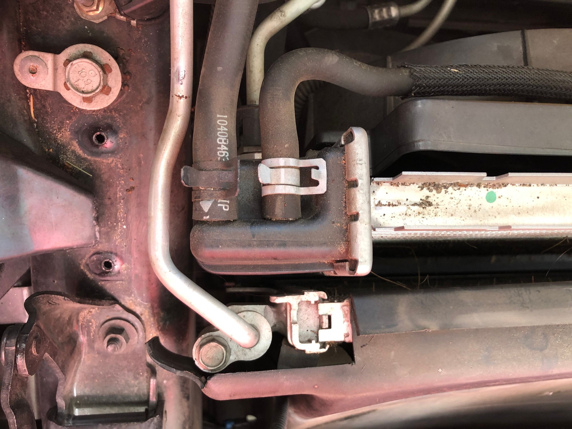

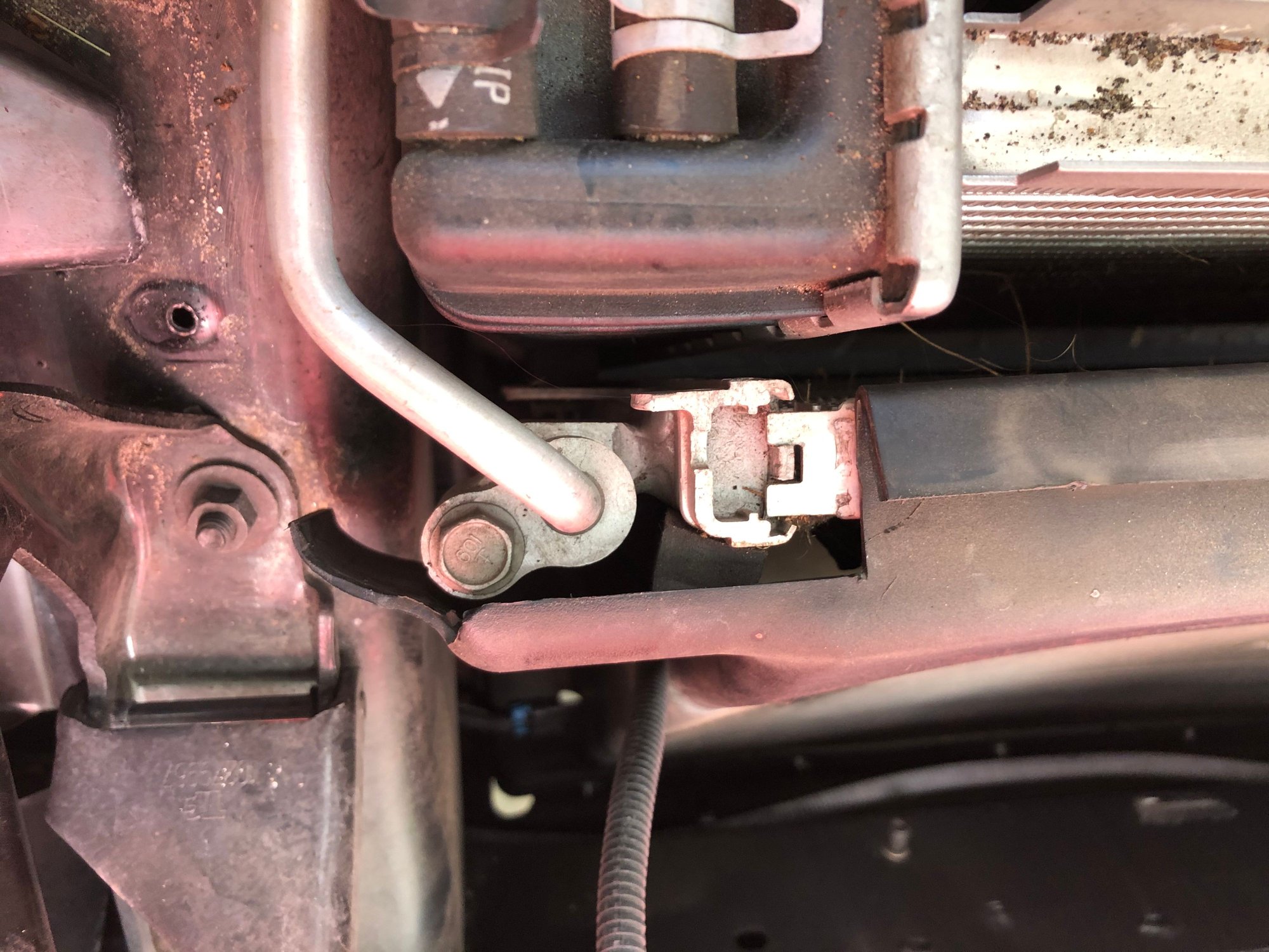

That goes on the radiator shroud where the top AC line goes under it. It is to prevent damage to the AC line.

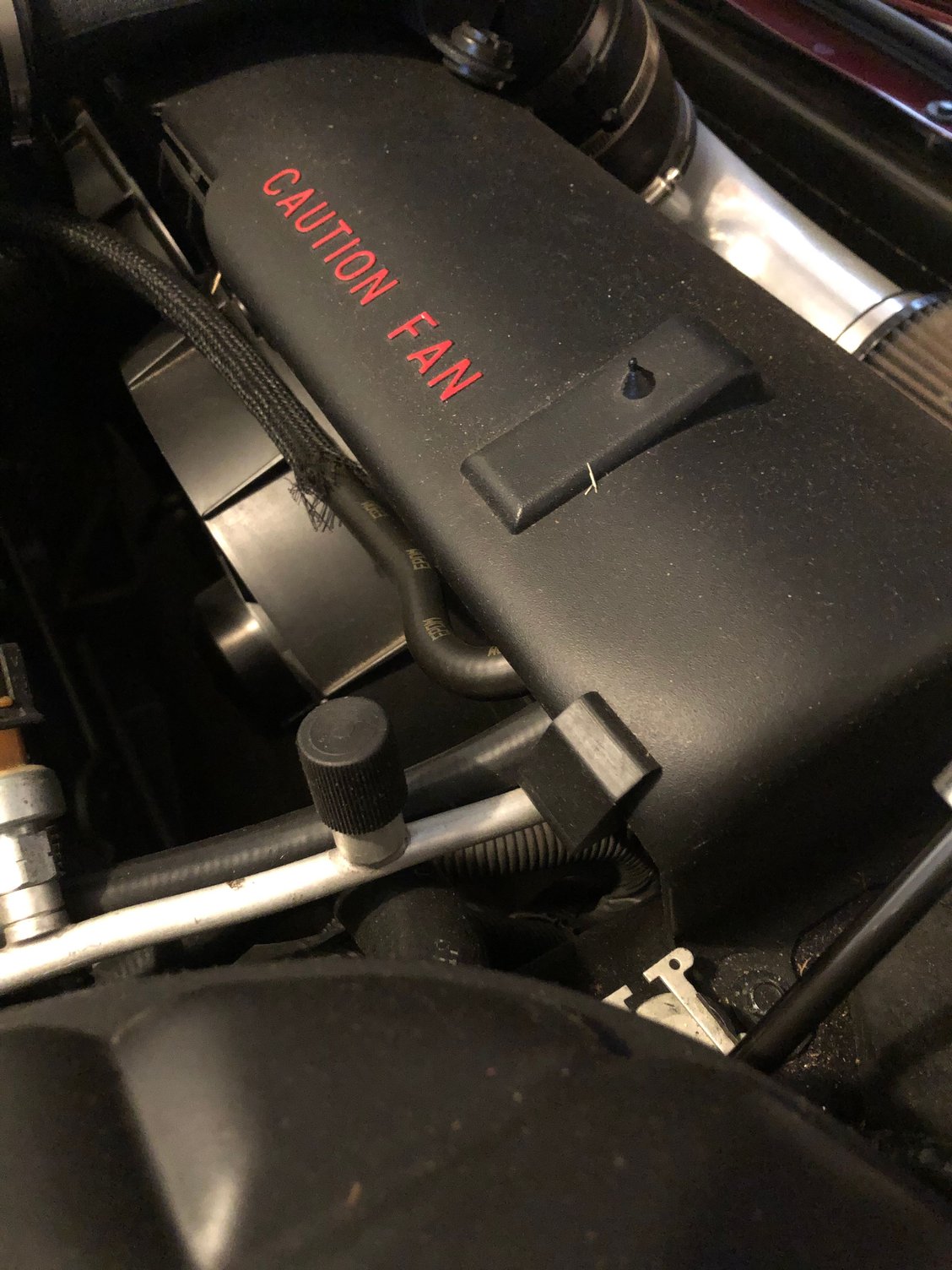

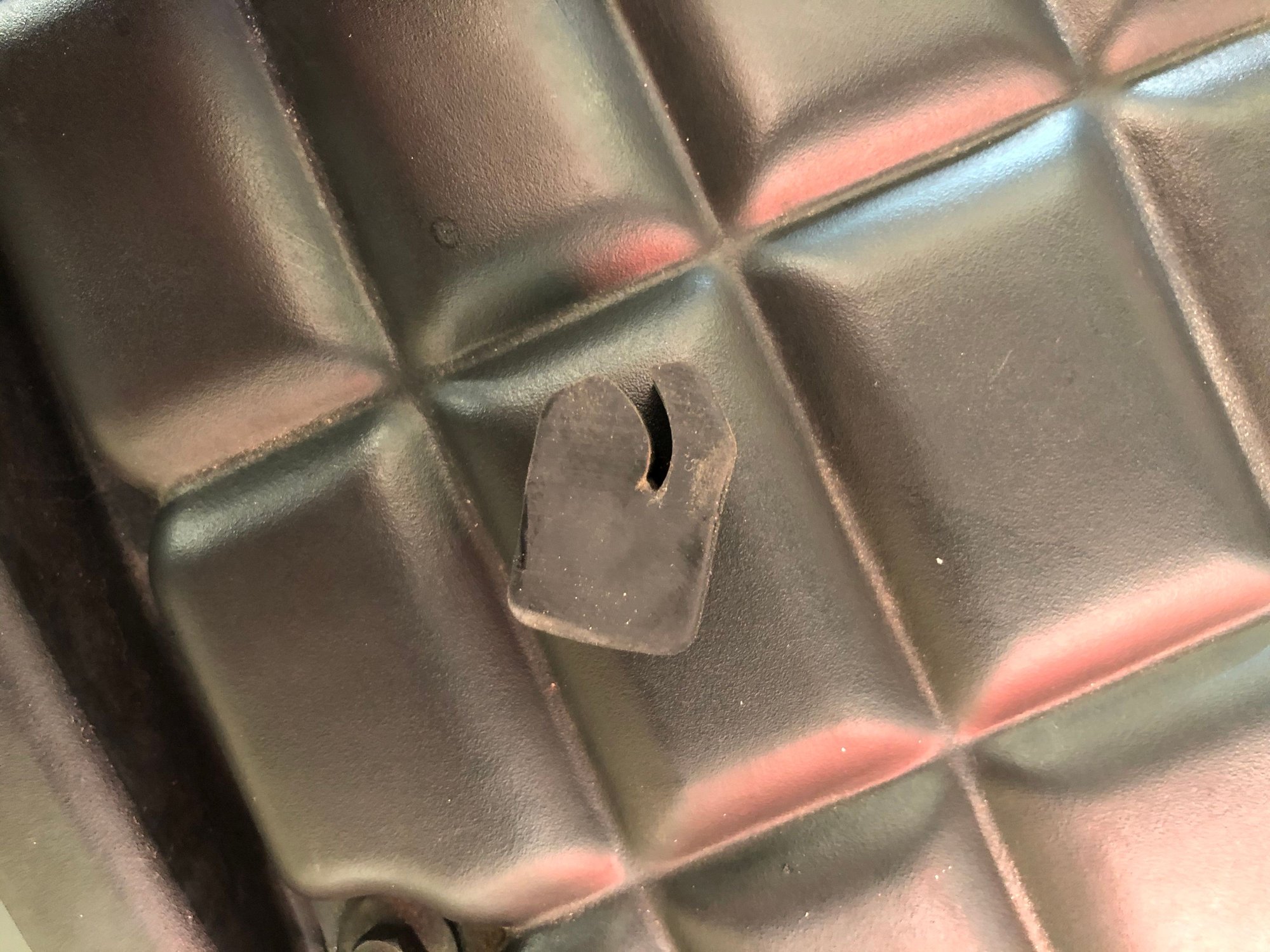

Sorry to be a pain in the *** but can someone tell exactly where this rubber grommet goes Thanks
Or does it go directly on the top cover?

The grove in the grommet goes on the edge of the rad shroud with the other end of the grommet wedged against the AC line.

Exactly. It is just a pressure fit.
