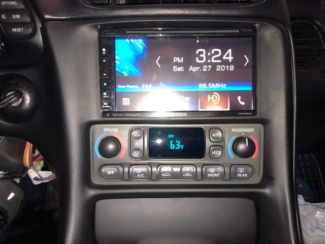

Could you elaborate on how you drilled out the rivets for the center bracket? Did you use a right-angle adapter on your drill? What size drill bit(s)?
TIA
Old Jan 14, 2020 | 10:44 PM
Ron71's Avatar
Ron71
Joined: Mar 2003
Posts: 892
Likes: 166
From: Oswego IL
TIA
Sure. I did not use a right angle adapter. I simply used a cordless drill with a 3/8 bit. I centered on each rivet and just drilled at an angle, so the rivet head got chewed away by the end of the bit as well as a little of the side of the bit. I also put down some shop rags to catch as many of the shavings as I could.

Awsome descripsion. I am about to do the same conversion. I need to ask you. What screen size wil fit. 6.8" - 7.0". What size have you put in.

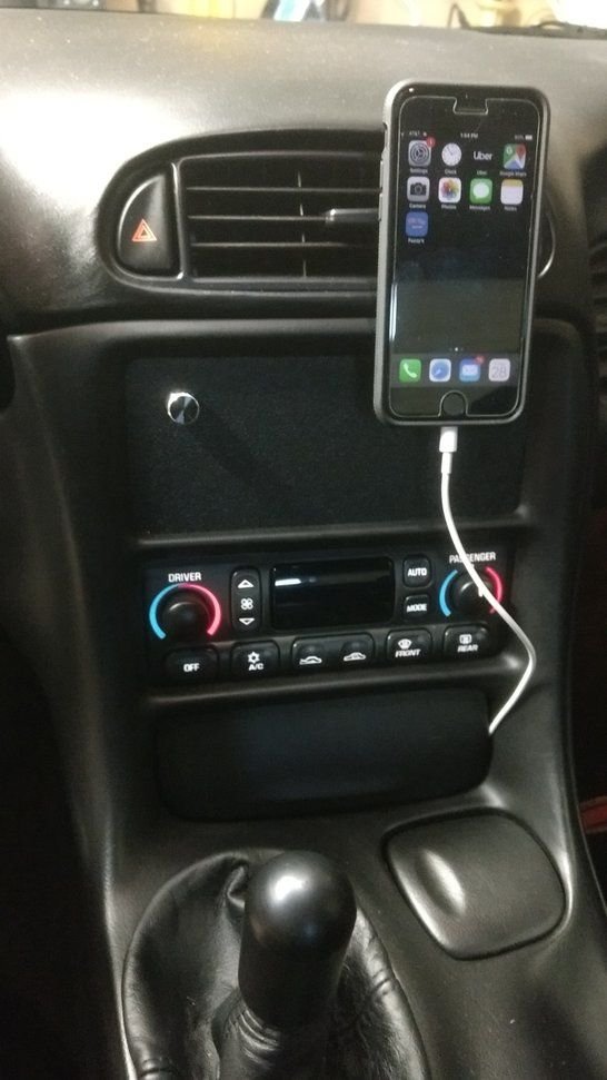

I actually did a headunit-less install about a year ago, just use my phone and BT for everything. works a charm. Backup cam is really the only thing missing.
https://www.corvetteforum.com/forums...ss-system.html

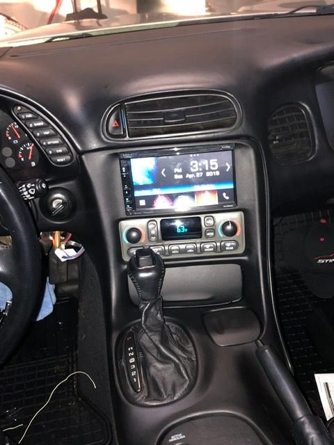

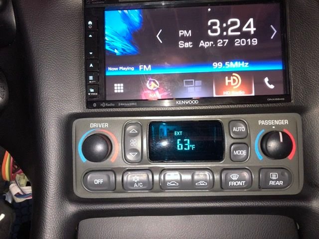

For the head unit I went with the Kenwood DNX694S. It has a 6.8 inch display which was pretty much an exact fit. I think a 7.0 inch may fit but would likely require some additional filing of the inside of the bezel opening. I have attached some additional pictures that show some better closeups of the fitment. I needed to tweak the opening just a bit with some minor filing.

I was thinking of doing something like this but slightly different:
- Keep stock head unit but add aux adapter
- Slide stock head unit further back in cavity in order to place a small Android tablet in front of it.
- Use plastic panel sheet (like what you have) as a nice/flush surround for the small tablet. The aux and USB power hookups to the small tablet will be hidden behind the plastic panel.
- Extend the length of the power/volume **** on the stock head unit since it's now farther back, and will stick out through the plastic panel like in your photo.
Is that doable with the amount of space that's in the cavity? Not sure how much farther back the stock head unit can slide in the cavity. Maybe you're not sure since you never had a stock head unit in the first place, but maybe others can answer on that part of the question.
I'm looking to do this because by the time you buy a new double-din console, new double din head unit, and either an adapter for the stock/amp speakers (which I'm reading requires a lot of labor to get tuned right) or replacing the speakers, cost will be way too much.
