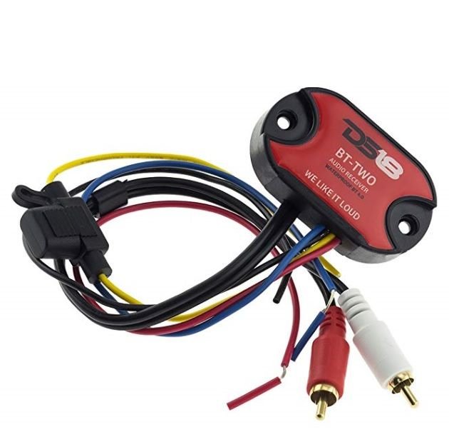

  • DS18 BT-Two Bluetooth 'dongle'. This is a BT 4.0 receiver/adapter meant for boats etc. It is switched on with switched DC and included amp turn-on output. Amazon $35

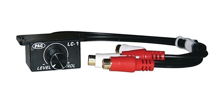

  • PAC LC-1 level controlled. RCA in and out volume controller, taking signal from the DS18 and sending to the amp, that's it. Amazon $8

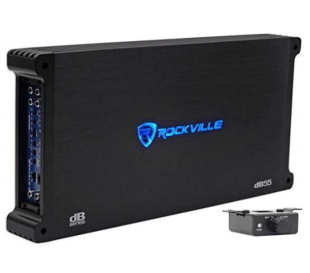

  • Rockville DB55 5-channel amp. 4000 watts!! In reality about 4x80 and 1x300. Amazon, $160

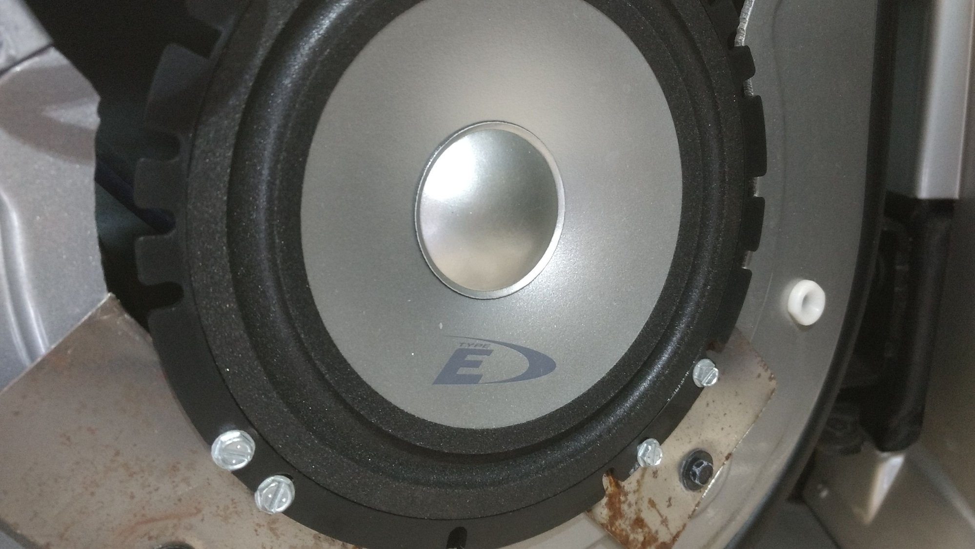

  • Alpine Type E separates (front) came with car

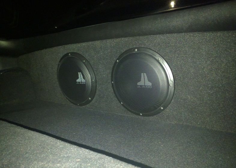

  • Dual 10" JL 10w0v3 subs in 'partition' box behind the seats $250 used

DS18 Bluetooth receiver

PAC LC-1 Level Controller

Amp
Sub (not mine, but identical)

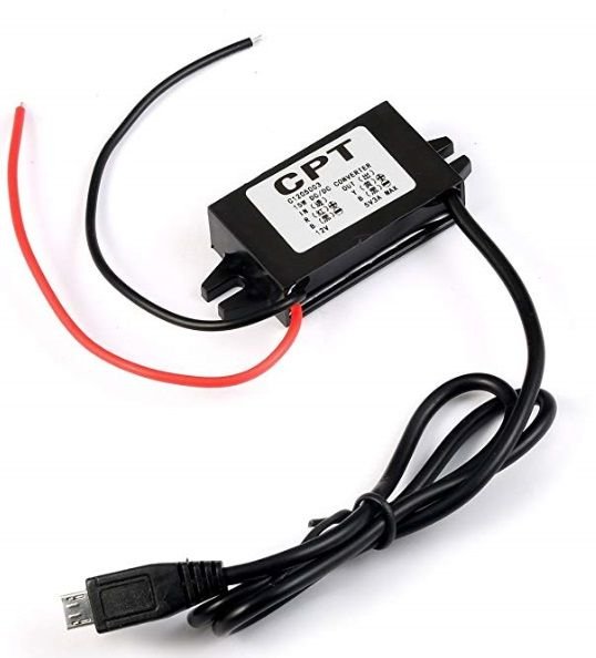

5v converter for dash cam and USB power. not identical but close enough. I lopped off the USB end and spliced in Android, Apple, and USB C cables to power phones and dash cam.

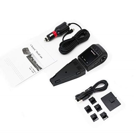

Finally, the dash cam. B40 A118C 'wedge' cam. Cheap, reliable, super stealth. Capacitor, no battery. I've been running these in 3 cars for years, like them a lot. Installed right next to rear view mirror on passenger side. 5V power supply run from dash up passenger side trim and tucked into headliner. Darn near invisible from inside and outside the car.

Alpine separates in doors. Very high quality AudioPipe crossovers. Sound damping added to door cavity. Tweeters mounted in door handle surround.

  • The BT pairs immediately. But there is a 3-5sec pause before music starts playing. The DS18 is 'alive' and listening all the time with car switched 12v power, but it switches the amp on and off with music input. So for instance, if you hit 'pause' or for any reason the output stopps, it switches off the amp. I may wire the amp remote turn on straight to switched power so if the car is on, the amp is on. The delay is unnerving and there's no need to cycle the amp on and off like that.

  • Volume control is easy. Set the phone to about 1/2 way. The dial on the dash goes basically from 'off' to 'plenty loud'.

  • I am very favorably impressed with the amp. I bought a Rockville compact sub a few years back ($80) and was rather shocked at the build and sound quality. They are American owned and designed, Chinese manufactured. Their literature and owner's manuals are conversational, informative and are obviously written by people who love car stereo. The 4 channel section is A/B while the sub section is Class D. They provide CEA, RMS and Peak power ratings. This $160 amp even came with a 'birth certificate' of measured values of this amp. I am impressed! It has many available configurations for the 5 channels and is smart enough to split up a single 2-channel input to 5 channels, 4-channel to 5, etc etc. Multiple crossover functions, etc also. A lot of power and flexibility for not a lot of money!

Cool job man! If you're ever in the door panels again you may want to move the xovers to the kick panels because they can get wet.
hmmm interesting I was not aware that side of the door panel could get wet, the other (window) side for sure

Between the door card and the door panel is a dry area if the factory vapor barrier is in place. First piece of mind you can put them in plastic bags with the opening pointed down. I prefer not to mount them in the door especially if there is any crossover adjustment on the crossover itself.
Oops yeah you're right, I was thinking of the other side for some reason. Carry on
