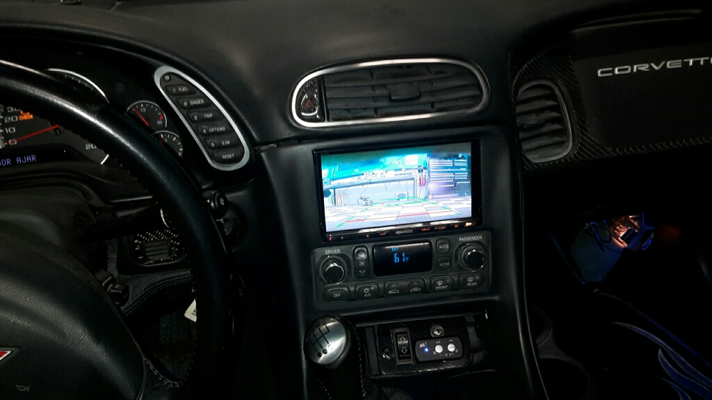

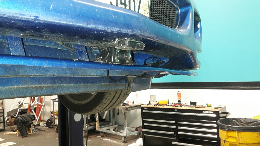

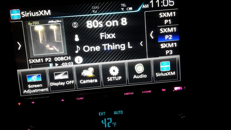

You hook the Curb Alert to a switched positive wire not a constant one or the battery.
The instructions are wrong.
If you have a Double Din with 2 camera inputs you can use a front camera like the one below my laser jammer module which has a longer range and is better

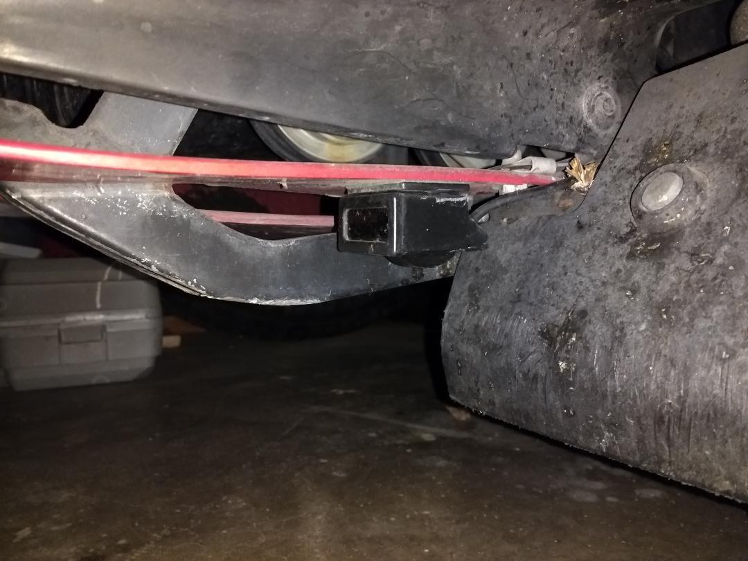

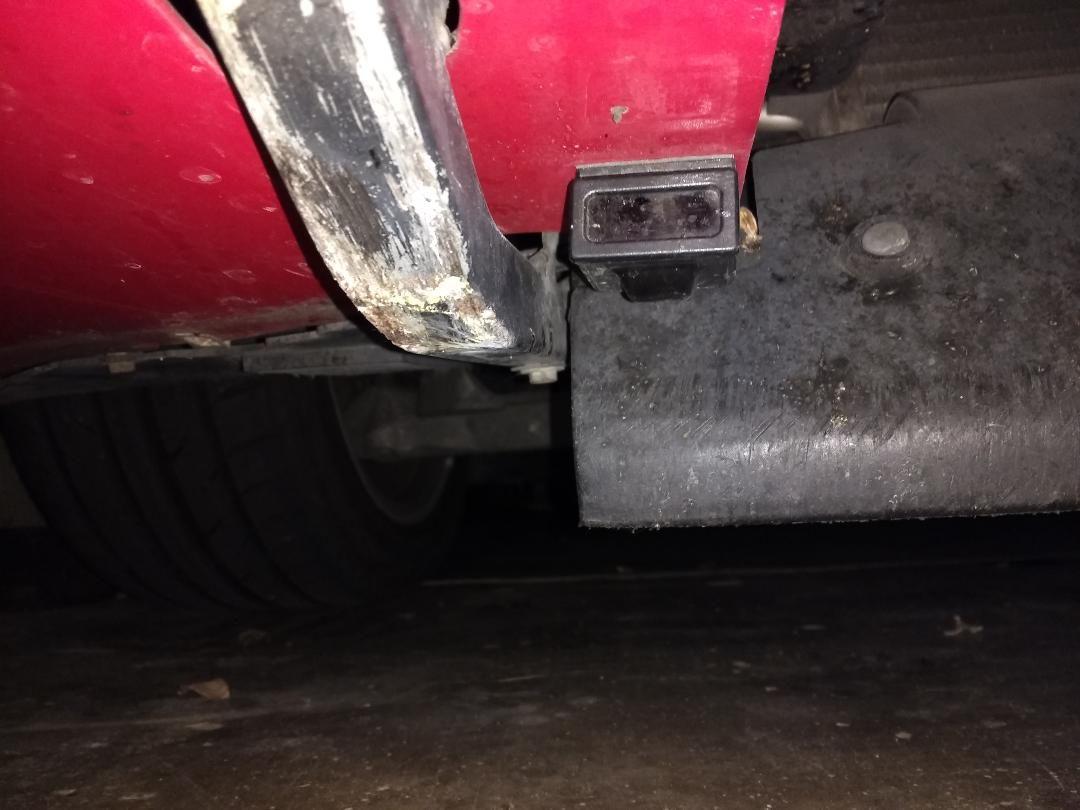

Oh hell braved the cold

Very sano installation. Thanks for the effort!
And thanks to rat123 for posing the question.
