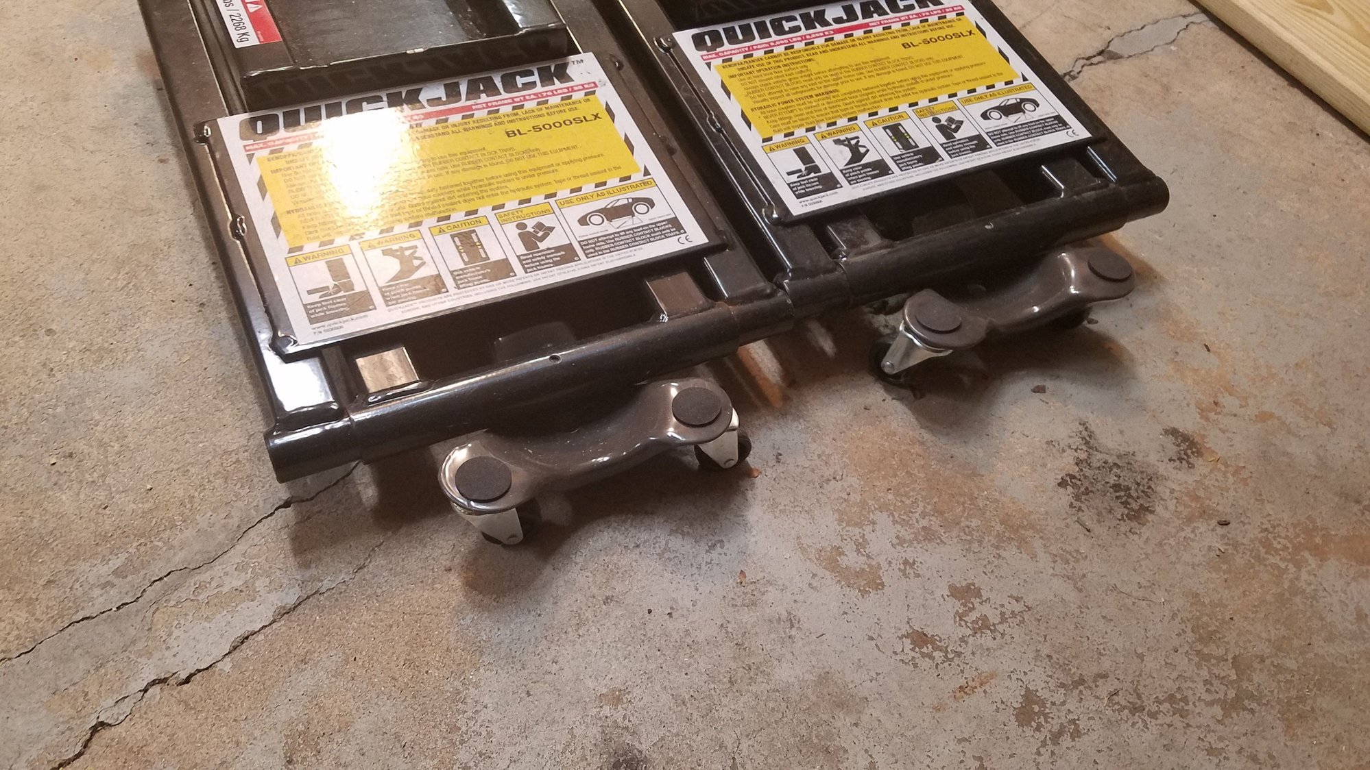

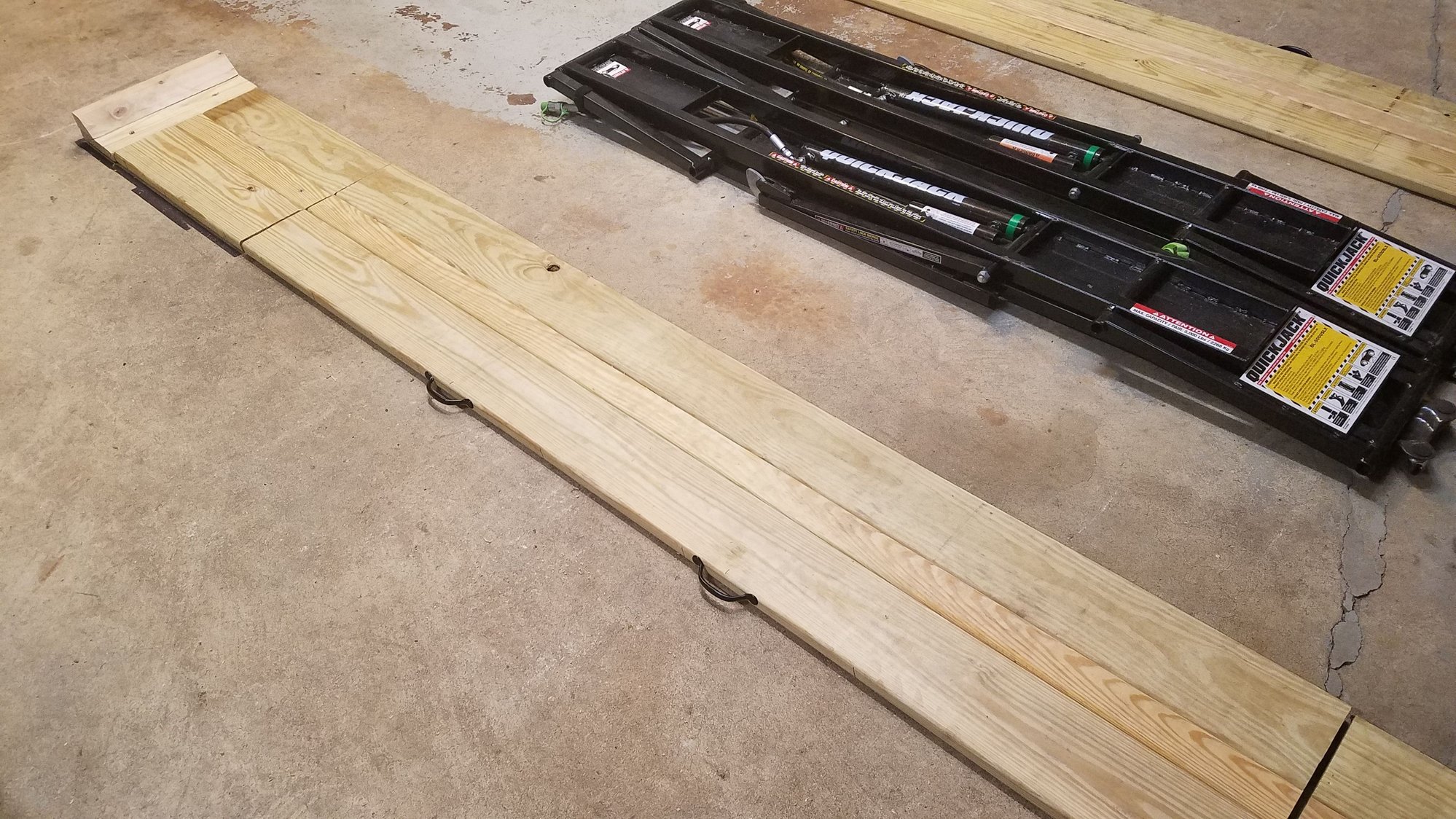

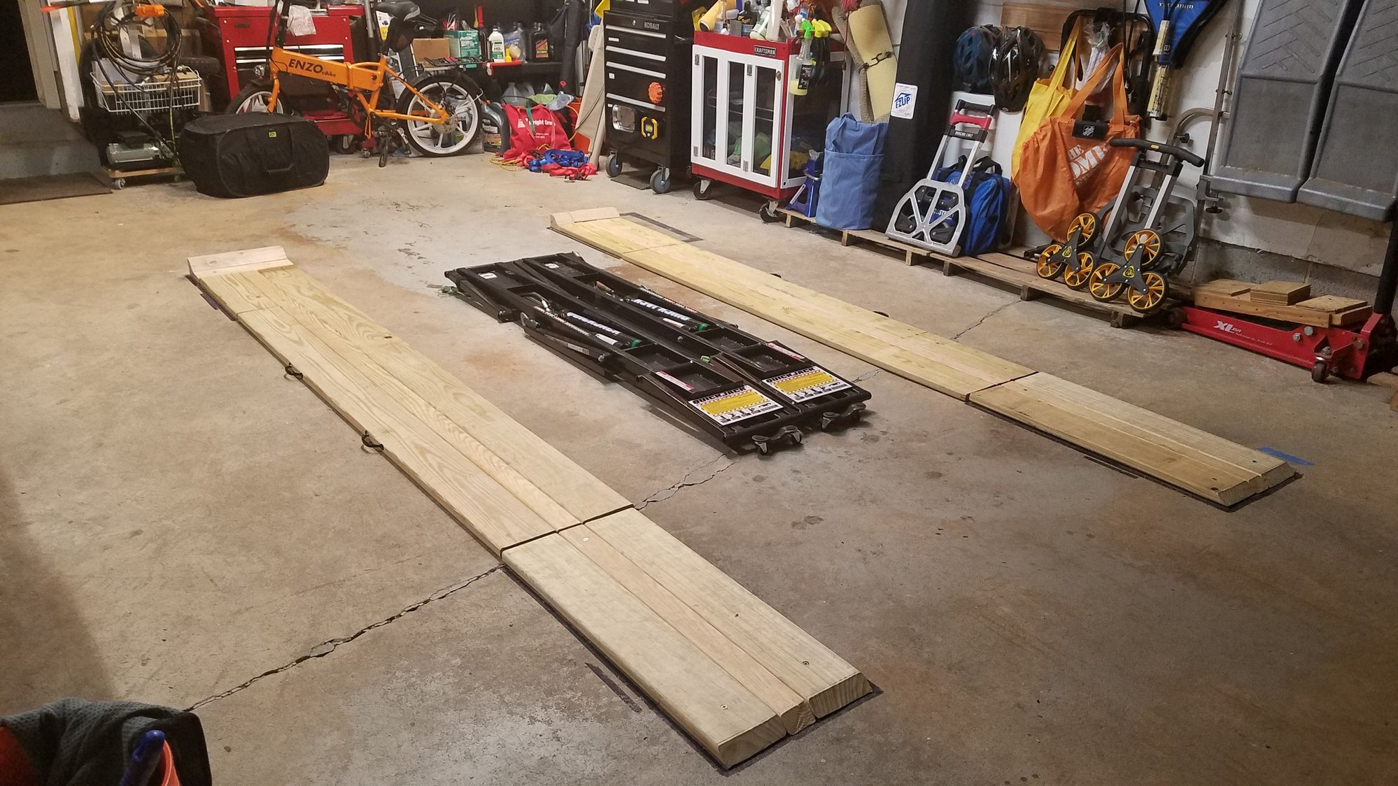

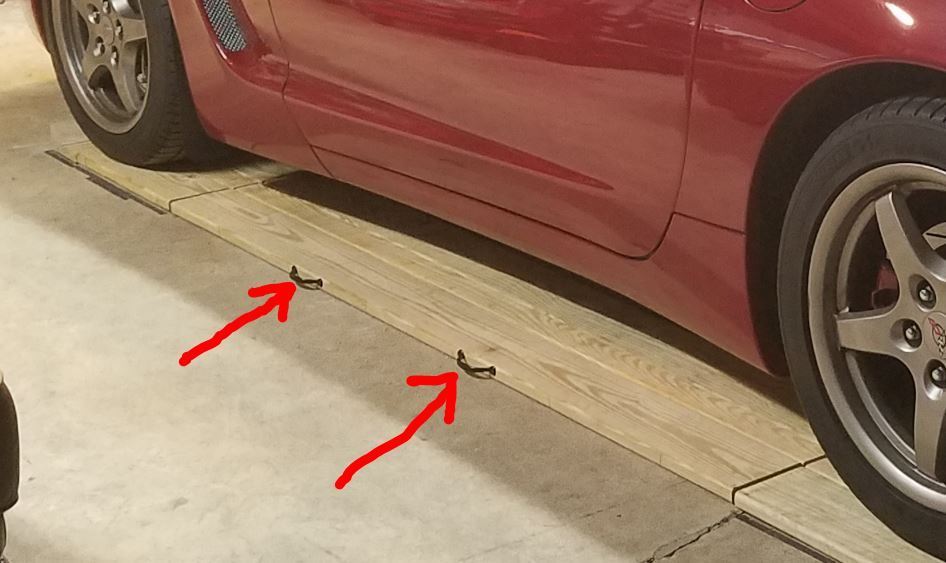

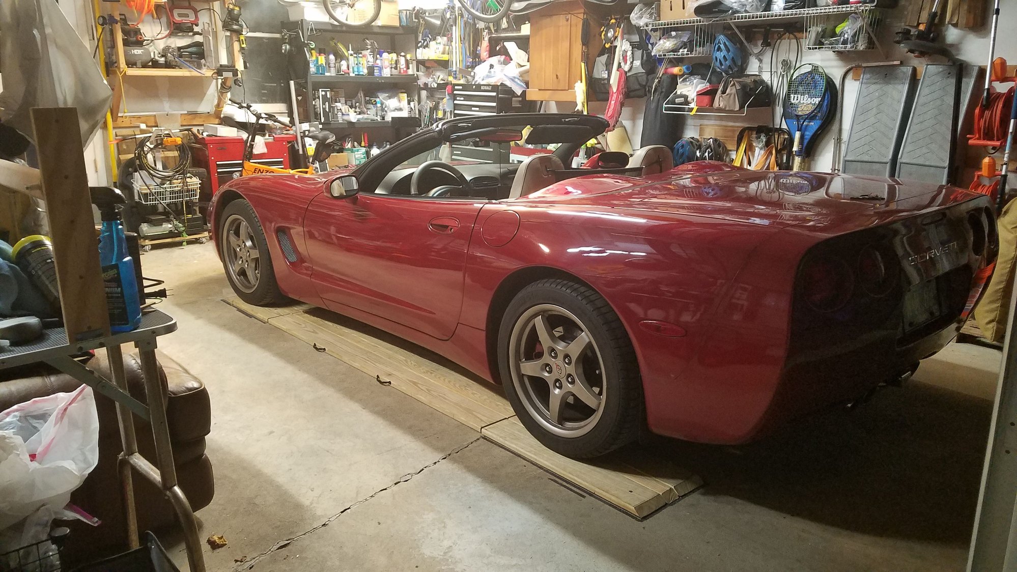

I park my Vette over the QuickJacks. Mine is not lowered, a '99 C5 convertible, on Z06 shocks. My car cleared with no problem. However, I wanted to make it easier to slide them in and out (garage floor is concrete and just rough enough that they don't slide easily). So I put them on small three-wheeled dollies so they would roll around easily. But, the car would no longer clear. So I devised a low ramp set up that the car parks on, using pressure treated deck boards. The nice thing is that the stops on the front put the car in the same position every time so set up is pretty quick and easy. The center section of the ramps has handles so I can pull it out from under the car to slide the QuickJacks into place. The parts under the wheels are removable, too, once the car is in the air.

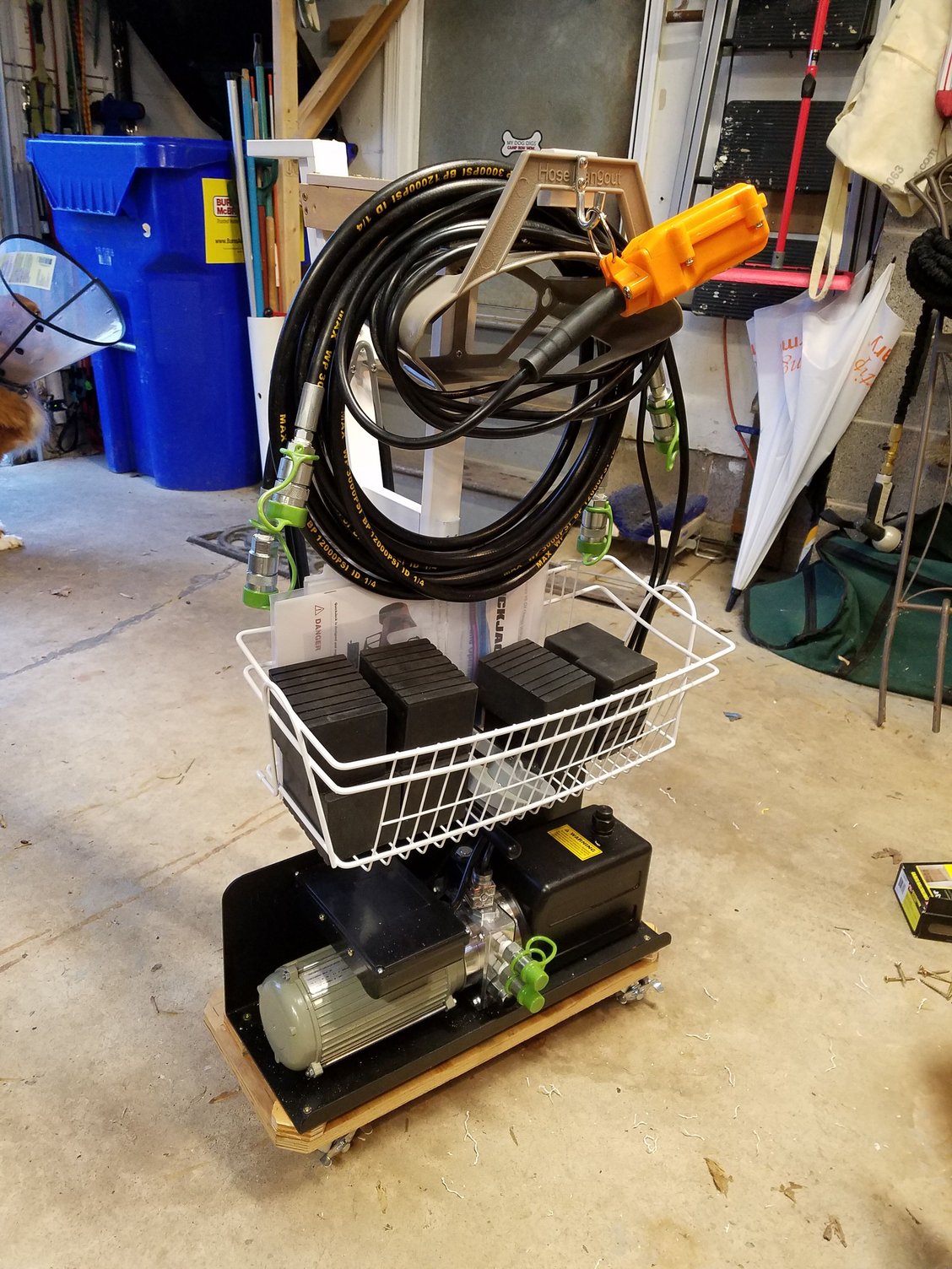

I also built a wheeled cart for the motor and with storage for the blocks and hoses:
