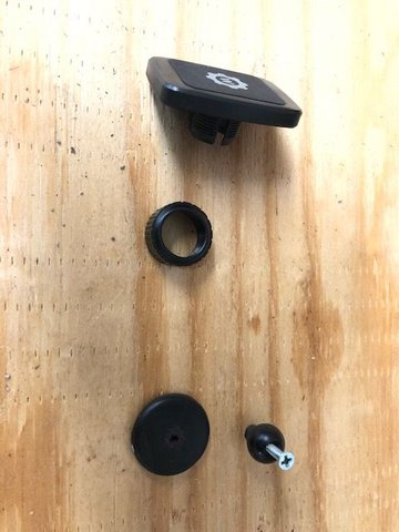

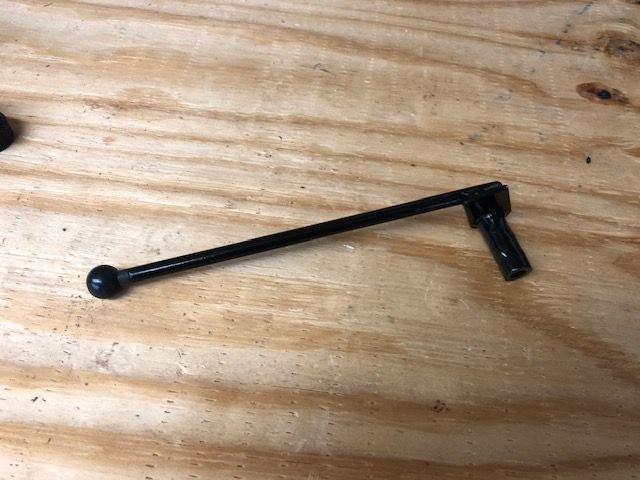

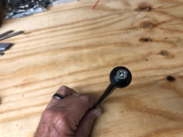

made this, just 1/4 round stock and the ball from a vent mount holder !!!

Is that a magnetic holder? Will it work if the phone has a case? How did you mount it in the car?

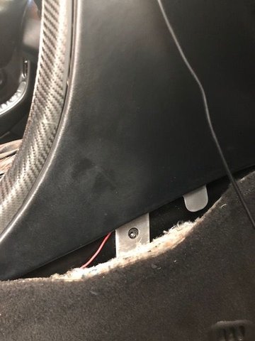

yes magnetic holder and does work with a case, also can use one of these,
mounts to the lower center dash cage lower mounting bolt, right side,

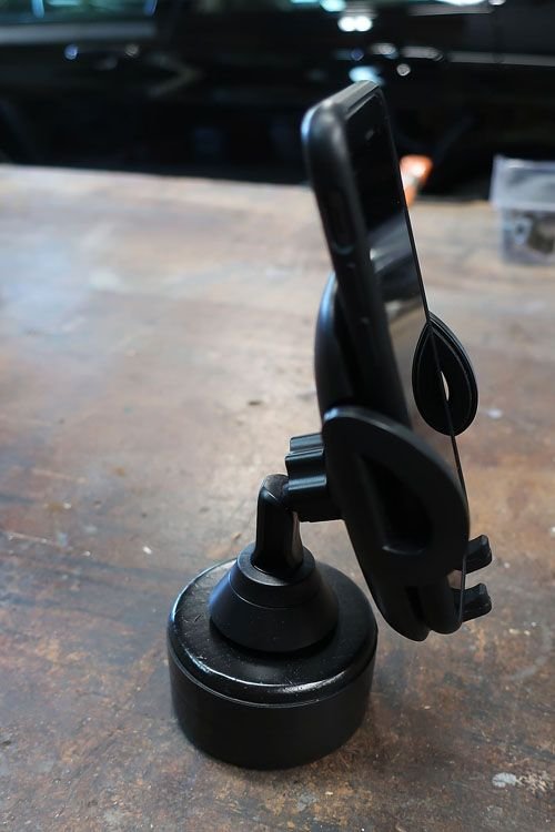

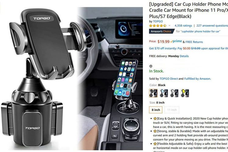

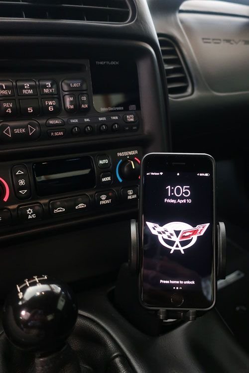

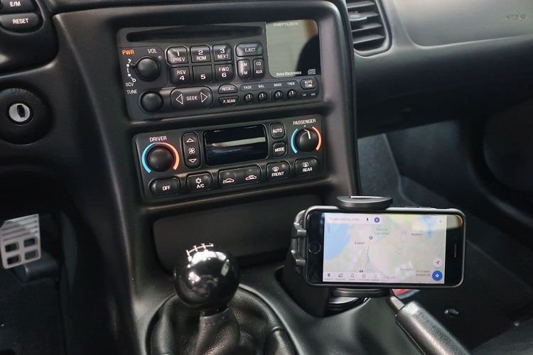

This is what I did and I think it works great after trying several other failures. Since I did not intend on doing a "How To", I don't have all the pics necessary however if you are a little capable, you can certainly do the same if you like what you see.
I started off with this gadget from Amazon:
Of course it didn't fit the shallow cup holder so I removed the adjustable bottom section via a small nut from the bottom. I then used a 3" hole saw and cut a donut out of a clean 2"x4". I routered the edges with an 1/8" round-over bit and painted it black. I then inserted the top section of the phone holder into my home-made, black donut and it was almost perfect. To take up some of the play, I then wrapped my donut with 1-1/2" black electrical tape until it fit snug.
For me, it's exactly what I was looking for. Portrait, Landscape, Low Profile and stable!

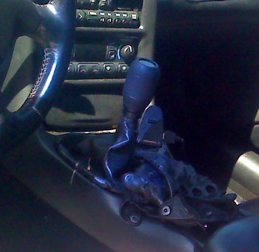

What I did (albeit for a Garmin mount, but basically the same) was double sided tape the cupholder shut, then double sided tape the Garmin mount on top, worked great, but in reality, was too low for the sightline of the driver to be considered 'safe':

This is the best phone holder I've seen for the C5, compact, clean and simple. Great job ericba! I'm going with this as well. The price on Amazon dropped to $16.99 to boot!

Thanks for sharing this, and ClassicAuto for mentioning the current discount.
Has anybody seen how the 11" version looks in our cars? I'd want my phone a little higher than the 8" version. Also, they have a 15% off coupon on the 11" version which also brings it's price to $16.99. I just bought the 11".
