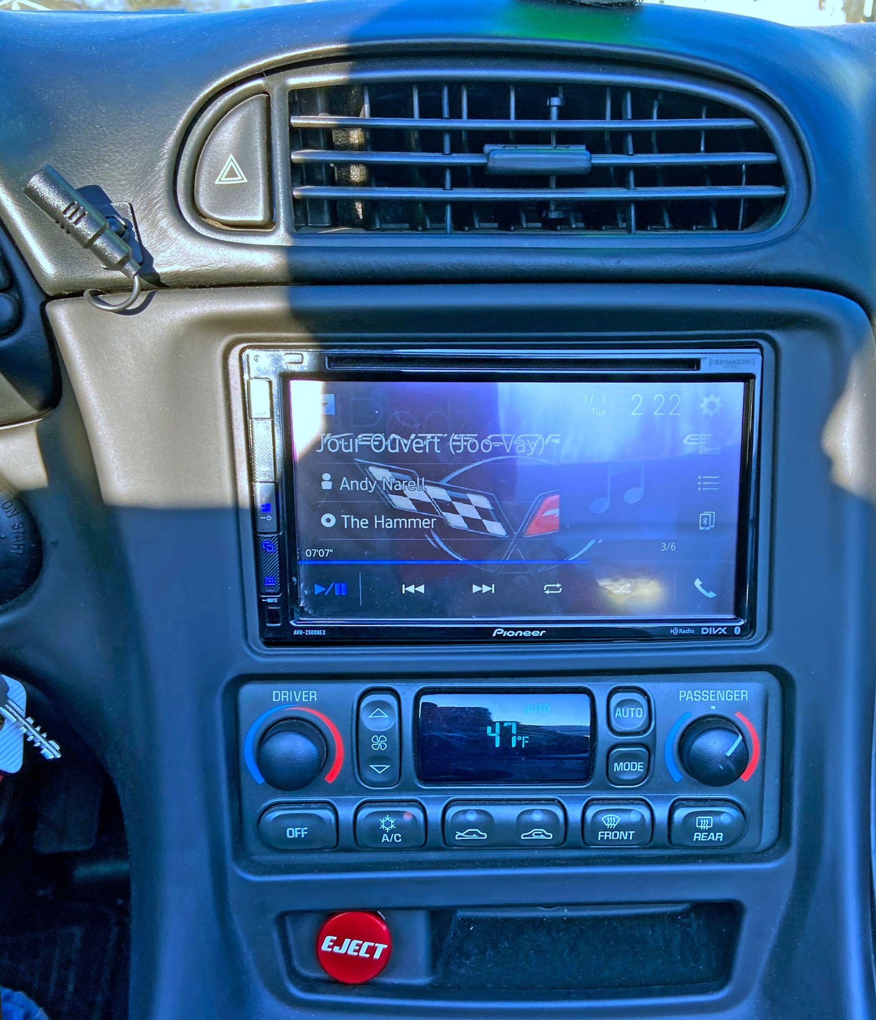

When I got a DD radio I had a pro install it because I didn't want to take a Sawzall to my baby But he asked ME where I wanted the mic for the phone! How should I know? That's why you go to a pro.
So here it is. I rarely use the phone while driving but once in a while the wife calls and that's a priority. Trouble is, she usually can't hear me (the top's always down).
So where's the best spot for the mic? Pictures would be appreciated.
Thanks
