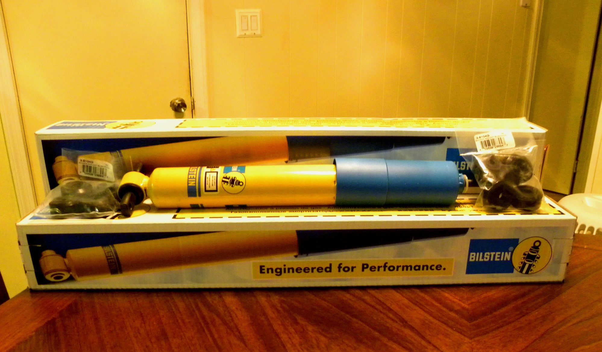

My Shocks came today...
anything I need to know?
anything I need to do?
I've got the F-45 now (still works but ride feels dated)
you guys like em'?, hate em'?
just shut up, put em' on and see for myself? (LOL)
seriously, will I tell a difference?

I've had those same shocks since April, 2016. I love them. Seven track days since installation, I like a firm ride on the track.

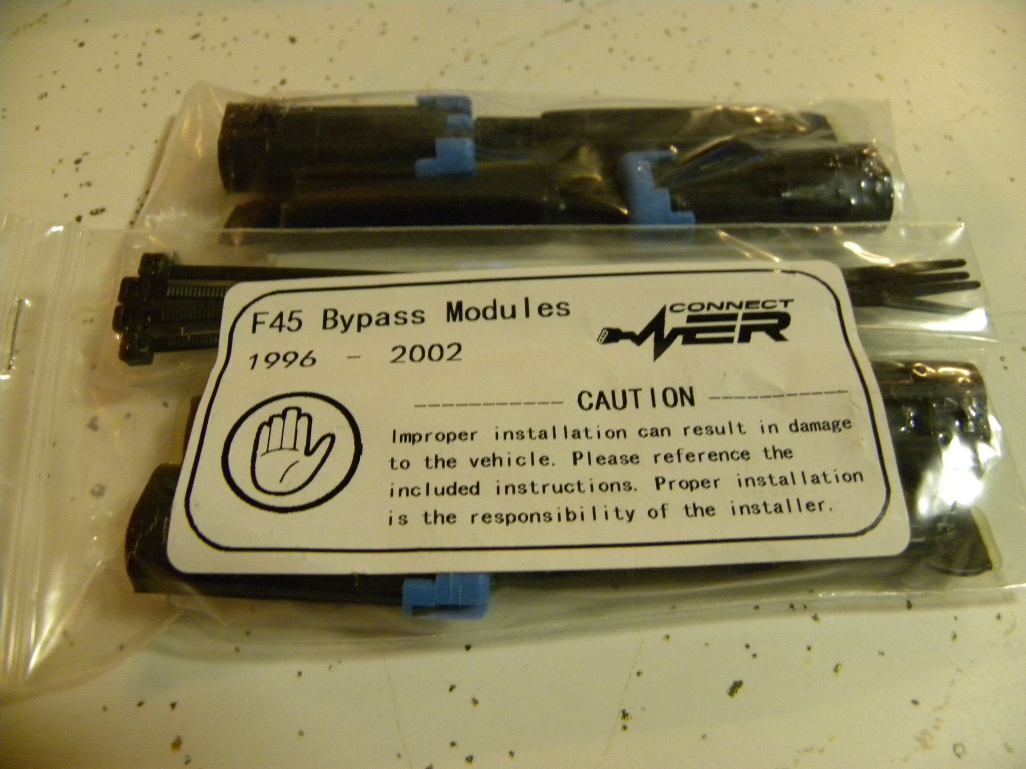

Here is some info on deleting the F-45 system:
https://www.corvetteforum.com/forums...imulators.html
For more, search F-45 delete in Tech.

these are the ones I bought (hopefully they work)
their supposed to just plug in

I should also mention that I have no experience in F-45 bypass, but I presume those should work.

The DRM Bilsteins are known to provide far better dampening than stock, I'm sure you'll notice the difference.

DRM stands for Doug Rippie Motosports, vendor, into track racing upgrades cooling etc..
They 'revalve' Bilsteins specifically for Corvette application - contact them to discuss, it has advantage in better 'shock curve' than regular bilsteins...very successful, and a less expensive alternative to Koni Yellows..

Iv'e had them for 3 years on my lowered Z and they seriously keep the car planted and keeps the rear tires from bouncing when you go over bumps. Smart purchase! Installed these from the factory shocks after car was lowered.

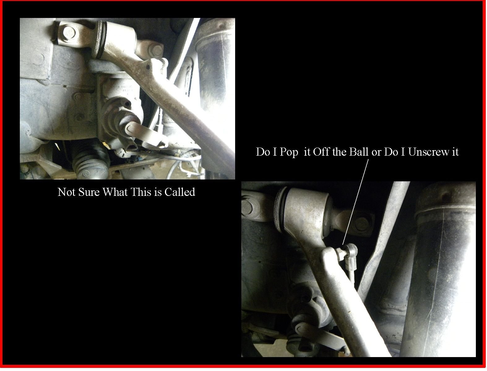

so off to a great start...
got the wheel off anyway (LOL)
so the question is...

I just unscrewed it and continued on...
got the shock out, ready to go back in
