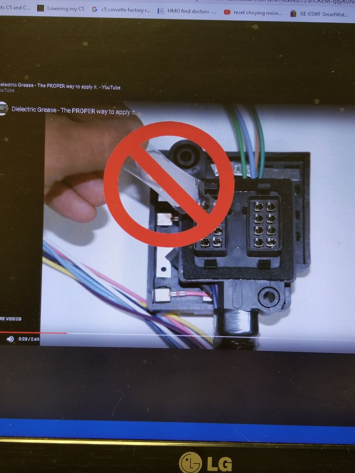

I started to clean the grounds on the engine bay the two on top of each frame rails. The front ones behind the headlamp is connector style has male and female connector housing . I put in dielectric grease inside the female connector generous amount and on the male connector pins in the mating pins and sockets . I just read about Dielectric grease on the internet :The grease does not conduct electricity, so it shouldn’t be applied directly to the mating surfaces (pins and sockets) of an electrical connection. Stupid me, didn't read the instructions.But I didnt see this writing on the dielectric grease tube anywhere. Do I need to clean and remove the dielectric grease from inside of the connector and male connector pins or is it ok if i leave it in ?

I sprayed down with corrosion x inside the contacts and male side of the pins applied dielectric grease. I did skim through the dielectric tube before I used it it didn't say anything about not to apply to connector pins etc.'ll take a another look at the tube to see what it says. I saw a quick video on youtube on how to use dielectric grease it showed not to use it on connector contacts.
