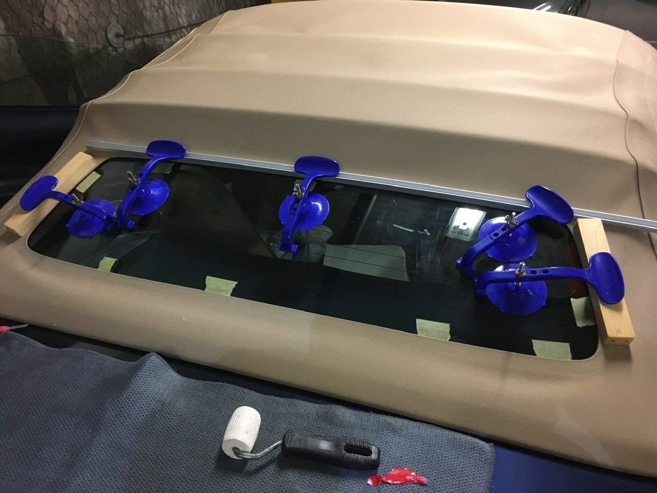

Glad you got your window glued back together! I used 3M WndowWeld, but it sounds like the adhesive you used should give you great results, too. One thing that helped me is I used a set of suction cup clamps to hold the window to the edge of the fabric top. I had never seen them before, but a search on the forum led me to ordering them from Amazon. Here's a picture of the clamps in action (Not my Corvette, so I can't take credit for the picture). they were a big help. Keep active on the forum and you'll read lots of posts that will help you get a lot of enjoyment out of your Corvette.
it is mine, and after 4months (cold 0C, rain) and 2000km, the 3M tape 5952F is still solid.
