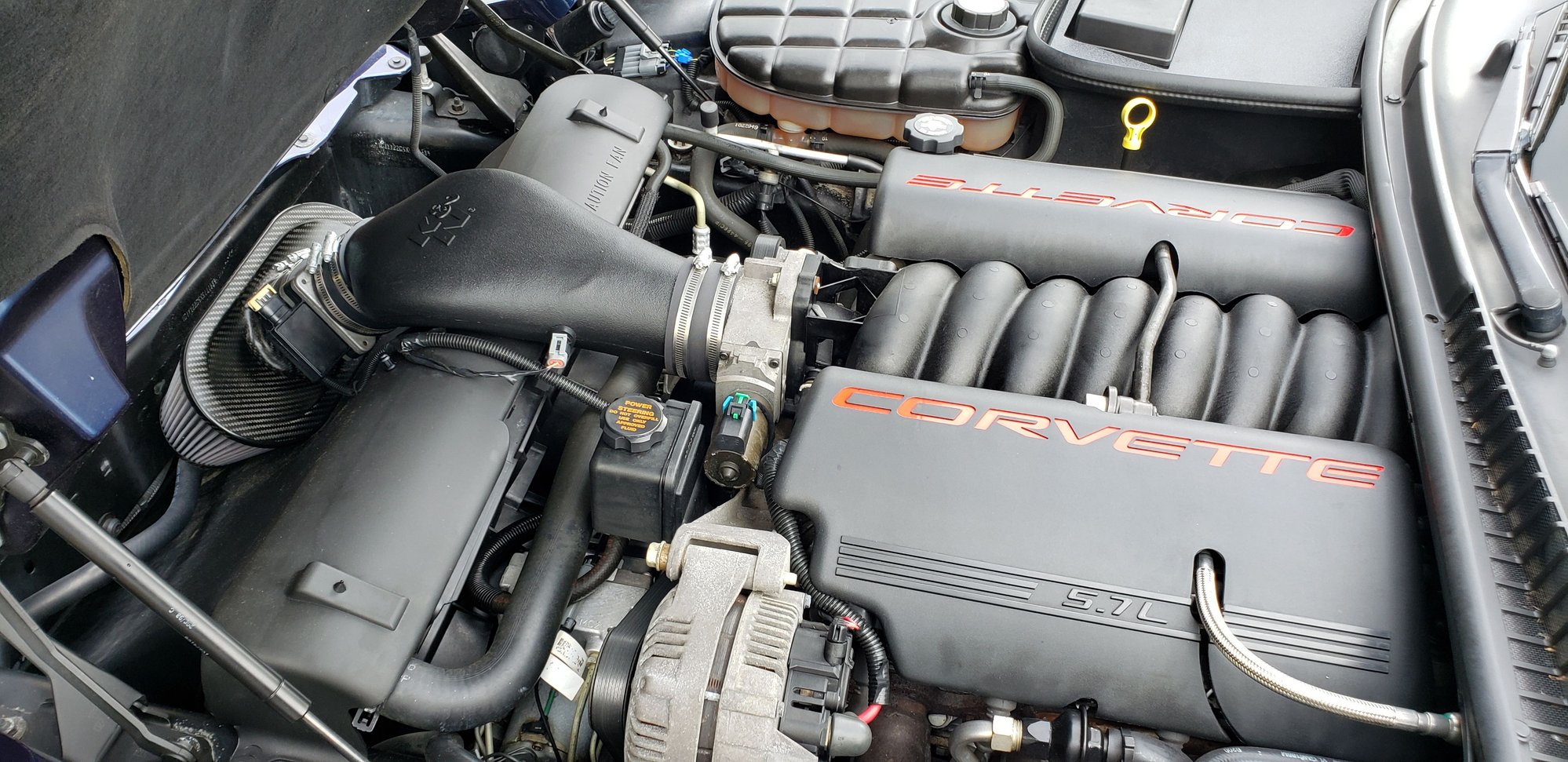

So here is what I've decided after listening and doing considerable research. Thanks for all the input.
57-3020 K&N PERFORMANCE AIR INTAKE SYSTEM

It is a nice looking unit which makes it a nice upgrade. As others have mentioned, not much HP to be gained with CAI over stock.

o2bnkc's Avatar
o2bnkc
Joined: Oct 2005
Posts: 2,989
Likes: 352
From: Carson City Nevada
That is not a true C.A.I. In fact it's not much better than the stock system that was on there. It looks fancy though.

I have a Blackwing which is very similar to the K&N ,they are less restrictive and you can clean them.They may give you a couple HP gain but they do look good.

Yeah, that K&N is not a cold air intake, but it will help some. I ran a Blackwing on my last two C5s and while I really couldn't tell a difference in HP, it did look good in the engine bay and I think it flowed a bit better than the OEM unit.
