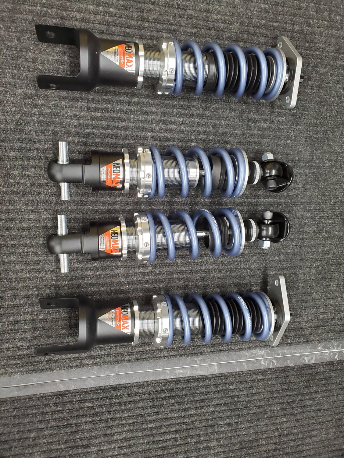

Old May 20, 2020 | 07:59 PM
Tbair64's Avatar
Tbair64
Joined: Nov 2017
Posts: 443
Likes: 140
look what showed up today. So many more things on the way for this make over

From: Swartz Creek MI
Which ones are those and how much?

Old May 21, 2020 | 12:11 PM
Tbair64's Avatar
Tbair64
Joined: Nov 2017
Posts: 443
Likes: 140
Silvers neomax is the brand. I ordered them with upgraded Swift springs 1589.
without the upgrade 1149.
