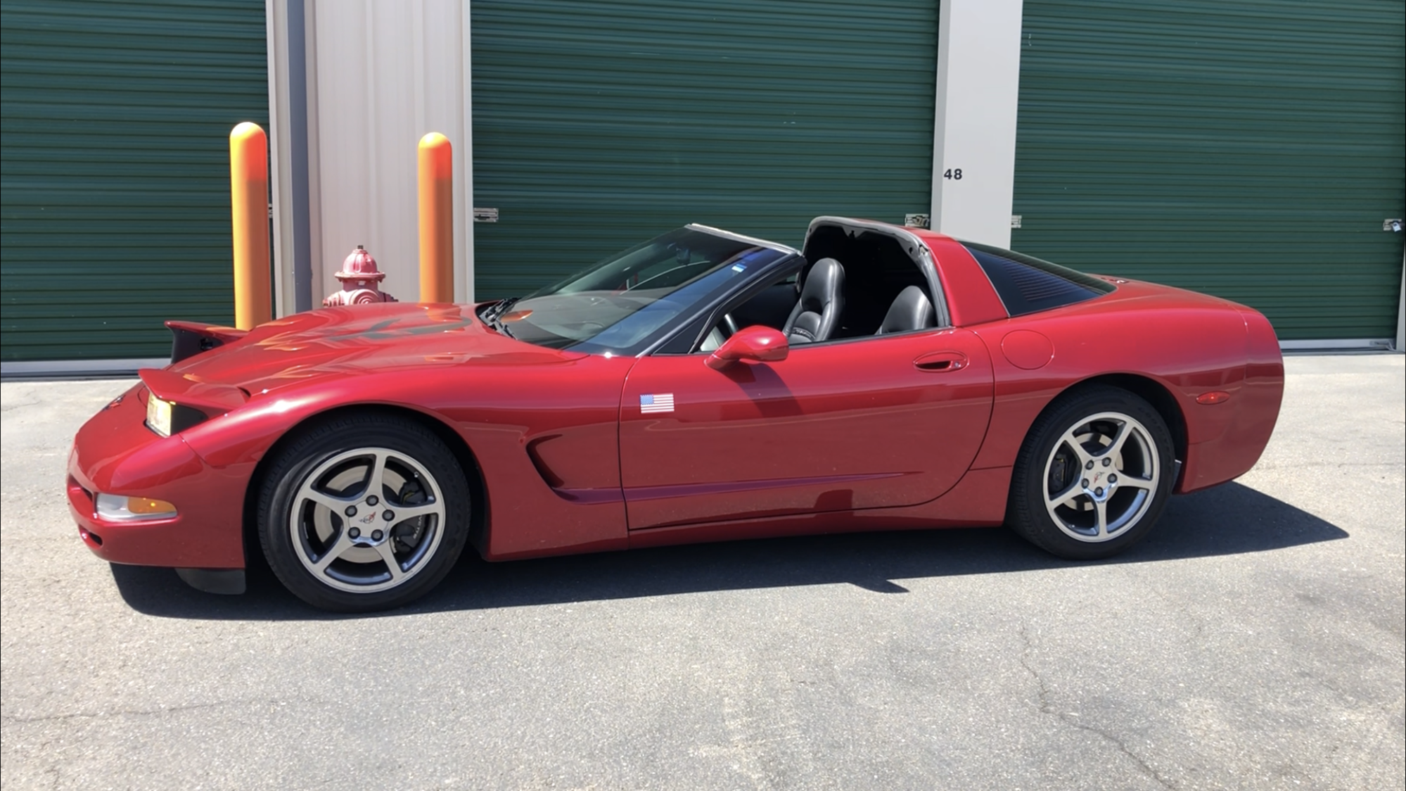

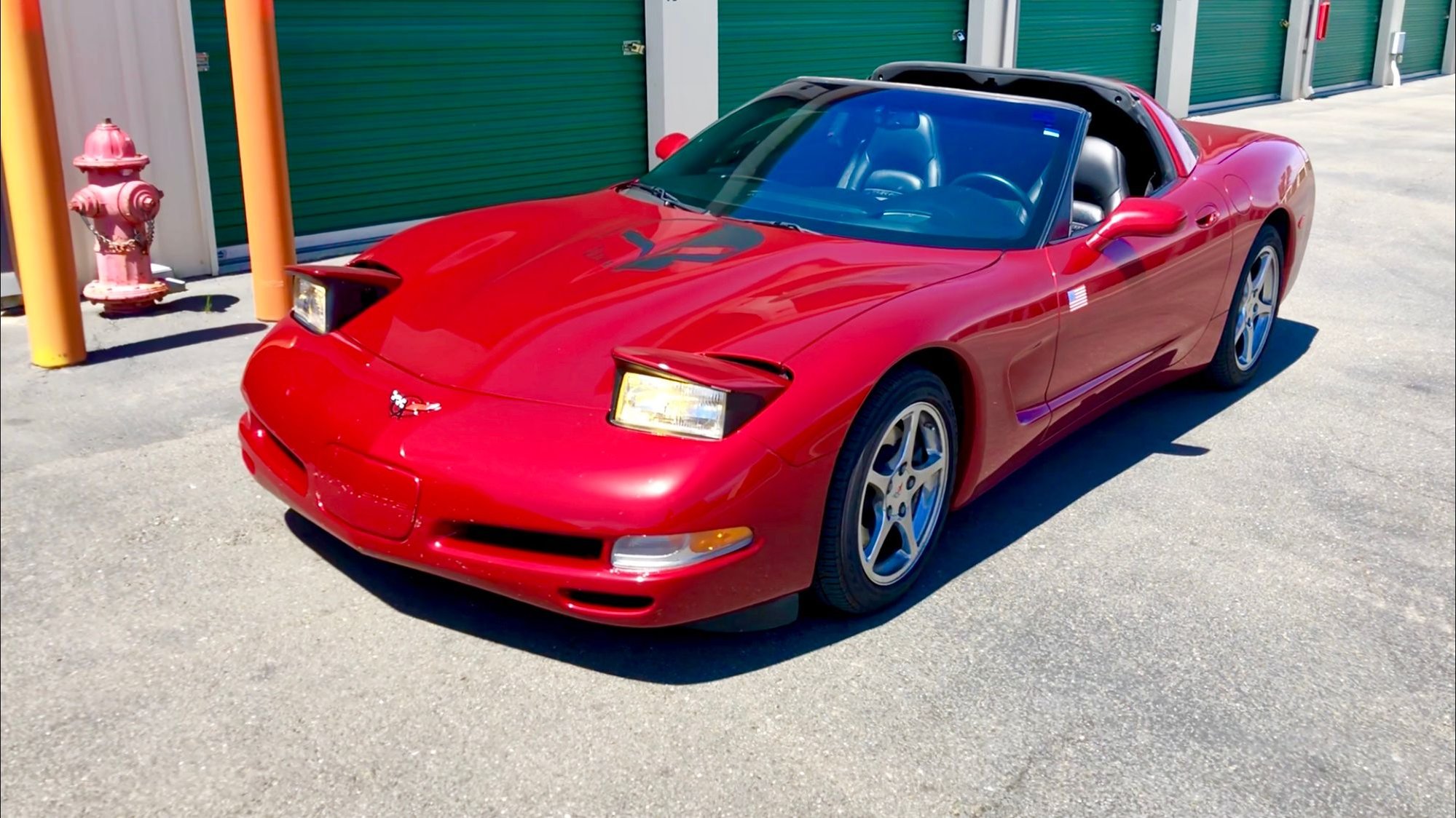

Guys I am putting together my new suspension setup, I need some technical help,
i got a new set of hyperco stage 2 Springs from Van Steel,
front and back adjustable hotchkins sway bars,
Moog sway bar links,
of course I wanna replace the shocks as well to c6 Z06 shocks at the same time,
my corvette is 2001 with early style adjustable damper? Is that what’s it’s called ?
is there anything I need to do electrical to bypass when I am replacing the original shocks with c6 z06 shocks ? Or not needed.
next question is, can someone post me a link of where to buy those c6 z06 shocks
and whatever electric item I need to bypass the old setup? Please
thank you very much.
