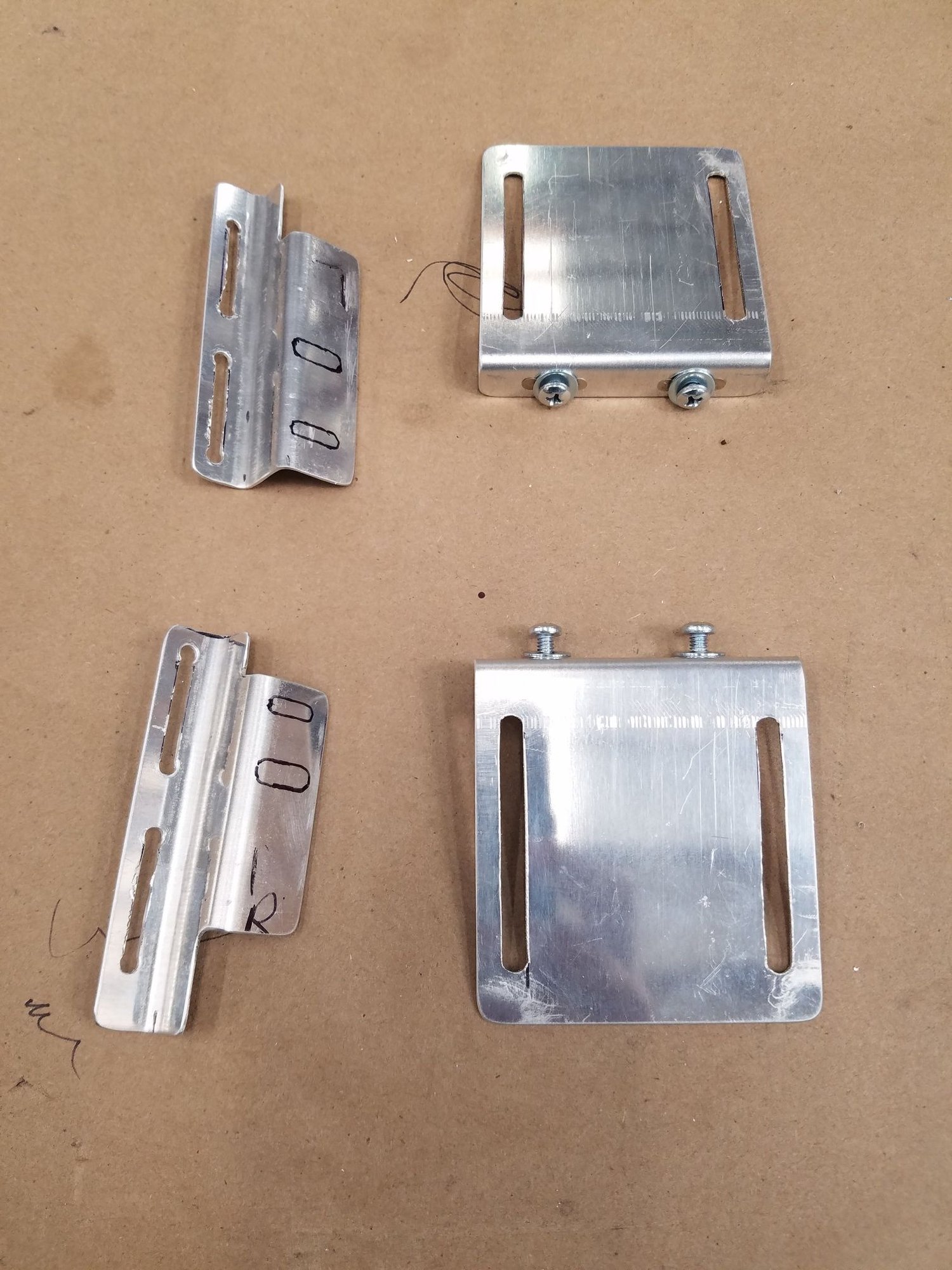

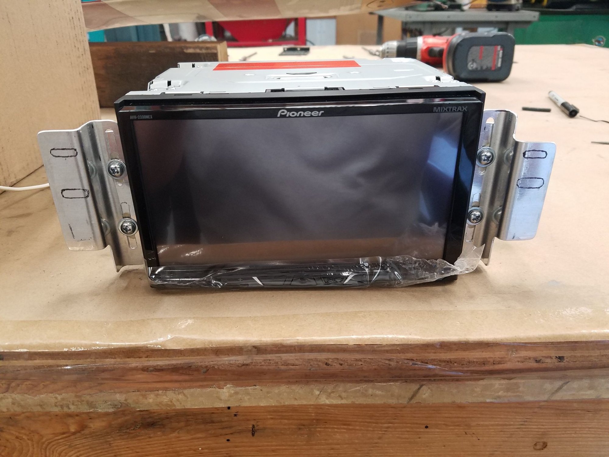

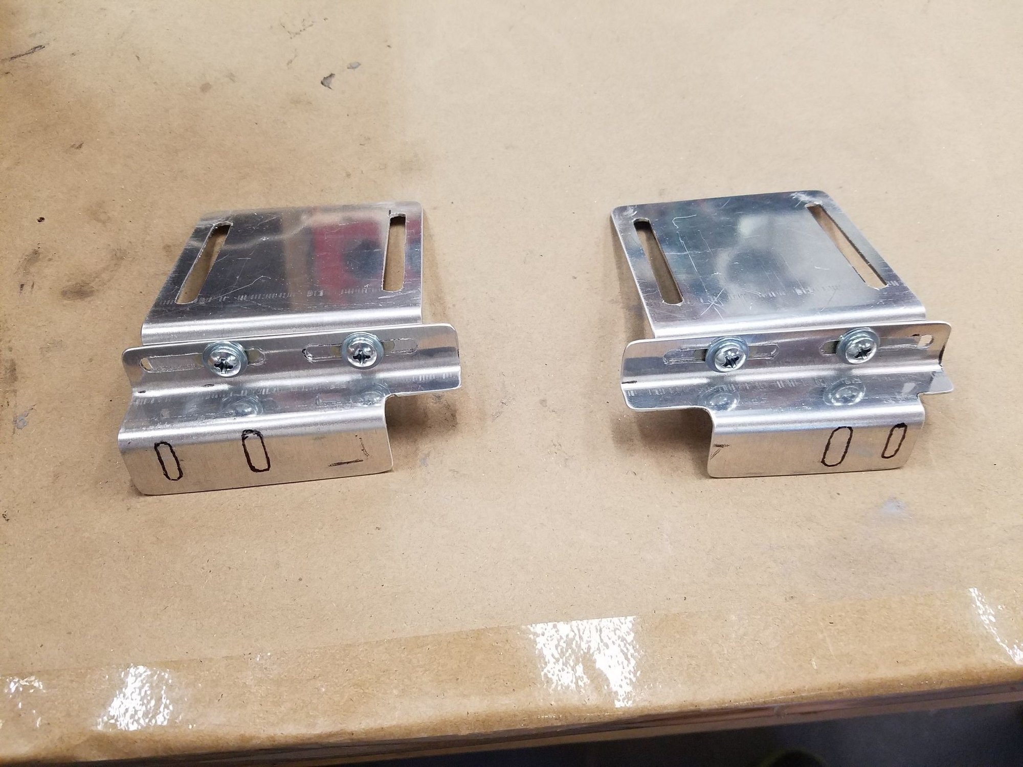

I will second or third that the Vettenuts mounting brackets are garbage. Some people have broken them just staring at them wrong.
I ended up making my own out of aluminum.
If I had it to do all over again I would have bought the ebay brackets but that seller doesn't seem to be making them anymore.

I also made my own. The plastic brackets just break. I don't know why Vettenuts and others promote plastic and "carbon fiber" brackets. I just used simple 90-degree galvanized metal brackets designed for installing fencing from Home Depot and modified them to meet my needs. Took a bit of measuring and testing but once done are every bit as strong as the very expensive aftermarket mounts. But I worked at a car stereo shop back in my young & stupid youth when there was only 4 track and 8 track car stereo units. We had to make every bracket by hand to fit every car we installed. Then came cassette stereos and still no aftermarket custom brackets. My 90-degree galvanized metal brackets took several trial and error fittings work very well and are very sturdy
Here are my homemade ones.
I think it would be different if they were using injection molded plastic as they would be stronger, but the printed plastic ones will disintegrate especially if you have to remove to adjust. I found some DD metal brackets from china that I ordered.

Great work, those look very sturdy.
