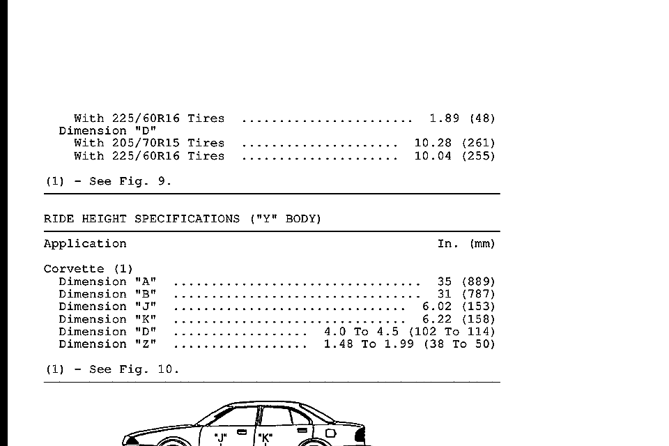

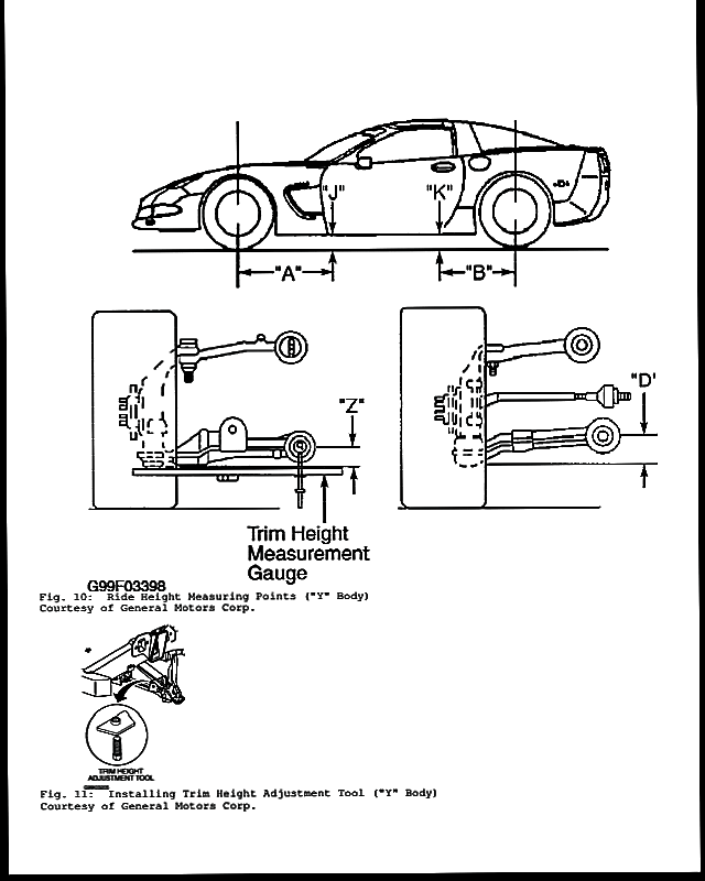

OP says he has lowering bolts installed. Is it possible the lowering bolts (they are longer than OE) in the rear are not allowing the full range of upward height adjustment OP is looking for in the rear to give him the rake he trying to achieve? Perhaps installing original, or at least original length, rear bolts would allow the adjustment OP needs to raise the rear where he wants it.
Just my opinion: Most Z06's I've seen around sit pretty high, which to me looks right. Additionally, the rake OP is looking for is excessive per the spec at the measuring points, which is approximately 0.22 inch IIRC.
Edit: 0.20 inch rake at measuring points
measuring points
measurements

Hey Big Mike, l know the way of which you are measuring the ride height is the correct ' by the book ' way and is what should be used when one is serious about tracking their car. But as far as the casual enthusiast who just canyon runs their car or will only see limited track time (l fall in these categories) l truly believe the 'fender' measure is just fine and a acceptable method of height measurement. That being said, l'm not sure that putting the stock or stock size bolts in the rear will change anything as screwing the bolt in raises the ride height, and that being the case, it shouldnt matter if the bolt is 5" long or 10" long as long as it has threads all the way down to allow it to be screwed tight to raise the car. l cannot say for certain if this bolt has threads all the way down it to allow me to raise it as far as stock, l have not checked this. l will do so today. Thank you for bringing that aspect to my attention!
You're welcome and good luck. I mentioned the lowering bolts because the lowering bolts I have seen advertised have a longer unthreaded shank vs originals which increases the distance between the leaf and the control arm, thereby lowering the car beyond the limit of stock bolts. Like you I'm a casual cruiser, canyons, etc., and if I'm being honest I am pretty unlikely to see an autocross or a track day but I did notice a slight difference in handling at different rakes when I raised my car from the lowered state I bought it in. I think it had to do with weight distribution. My suspension felt like it worked better too.
I personally prefer to do things by the book, and I like knowing the proper procedures, but I agree that fender clearance is good enough. I figured you knew the procedure too, I was in no way trying to school you or anything. And based on your reply it sounds like the "rake" you refer to is the difference in wheel well lip heights from the ground for which around an inch or so is about right. I misunderstood--my bad.
Hey Mike. Well l checked the after market rear lowering bolts and you are indeed correct! Thanks for bringing that to my attention. l never once got the impression you were trying to school me or were coming from a place of superior intellect. Even though l was a tech at Burbank Chevrolet for a few years and then again at Glendora Chevrolet, l will always consider myself a student of the technical arts haha. The moment one stops listening to others advice/suggestions/perspective/ideas is the moment you close your mind and stop learning. l always am open to hearing any advice/suggestions from anyone who has any on an problem or issue l am having, so bring them on! Thanks again for your help!
