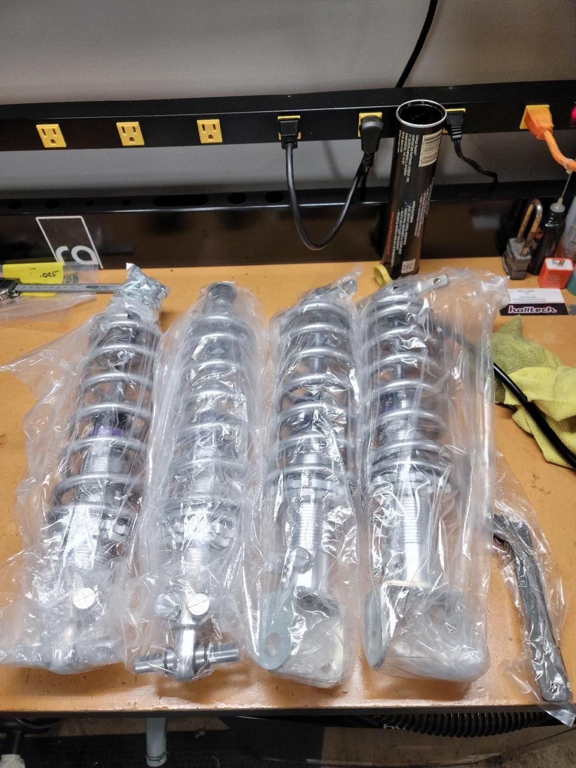

I did the assembly it’s easy but I think I still have anti seize on me from weeks ago

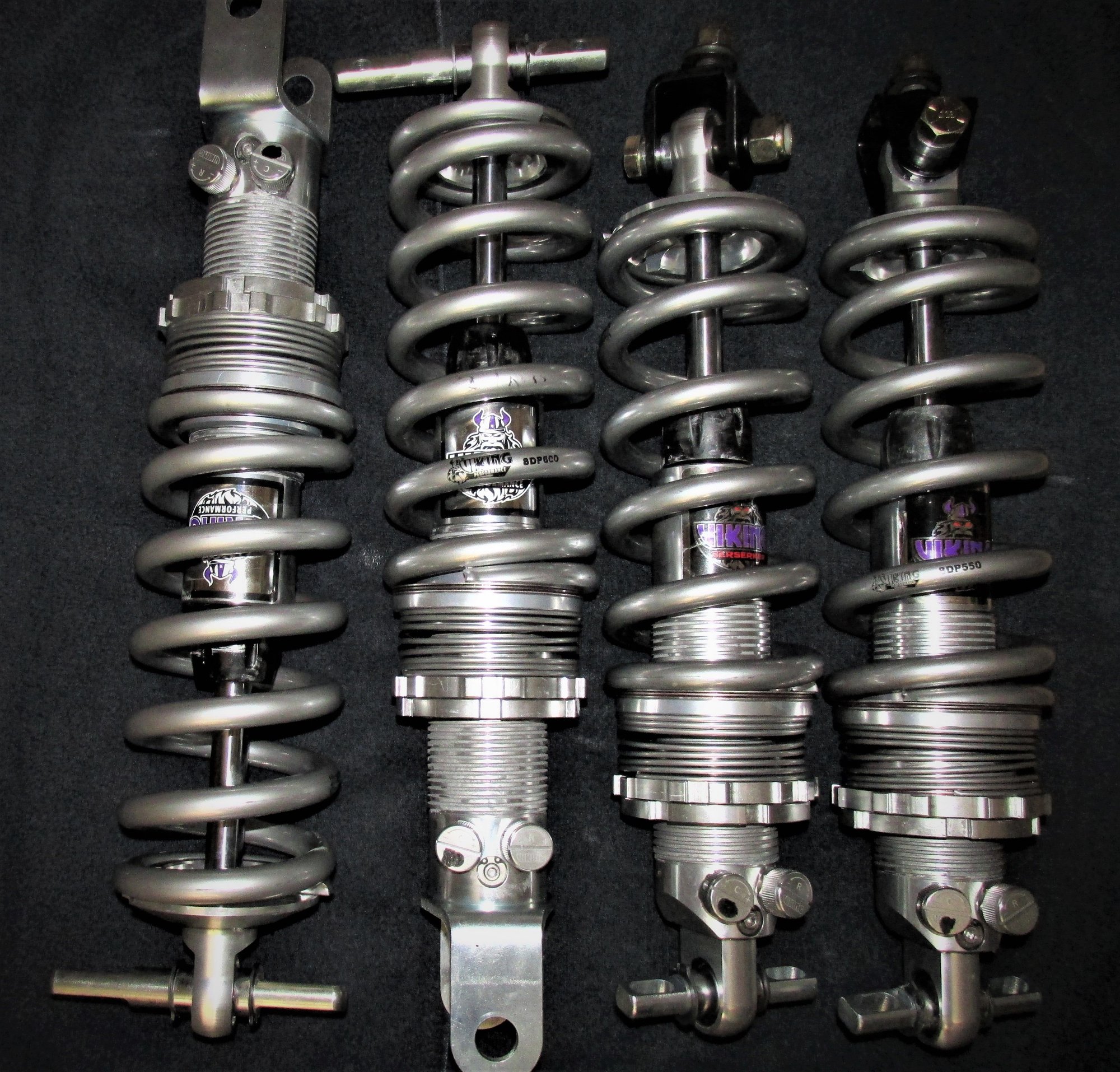

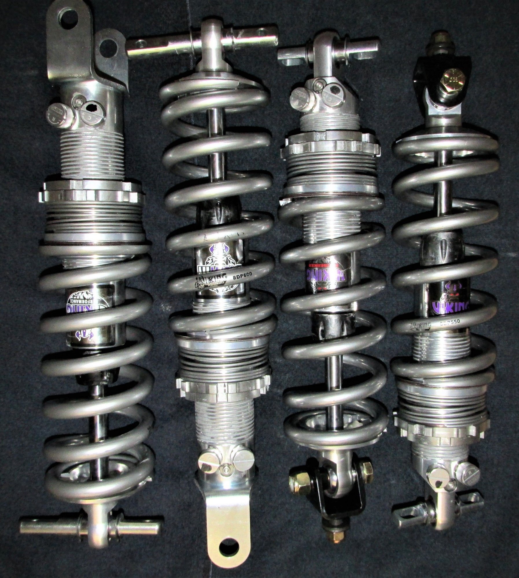

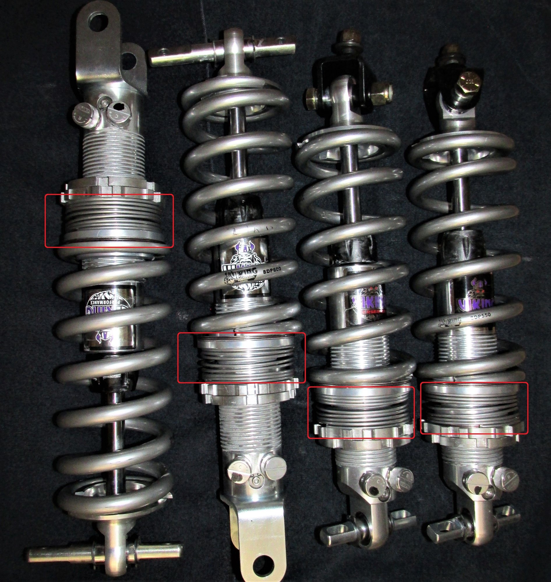

For a show car that is intended to be driven at legal speed, they certainly are interesting and if price is still in the range of what it cost me at this time, still a good deal...
However, I had two sets that leaked on me at speed you don't which your best enemy to handle..., that was at less than 80 miles on them.
I saved the car on the first set (front right leak), talk back to people at Aldan (many interlocutors I had there, some with some understanding, others with limited knowledge), I sent them back and got a new set, and a rear left leaked and almost crashed again at less than 70 miles on them.
That said, OEM and even Bilsteins, PFADT, Kony's. AFE didn't resist and endure run after run what the Viking are enduring...after the Viking my next set was Ohlins TTX36 (never ask for the price...) AND NO NEED!!! (THAT MEANS TO BE CLEAR I AM NOT GOING TO SELL MY VIKING BERSERKER)...
Again, for a show car that doesn't see a lot of load and a lot of speed Aldan's might be helpful...!
Christian
