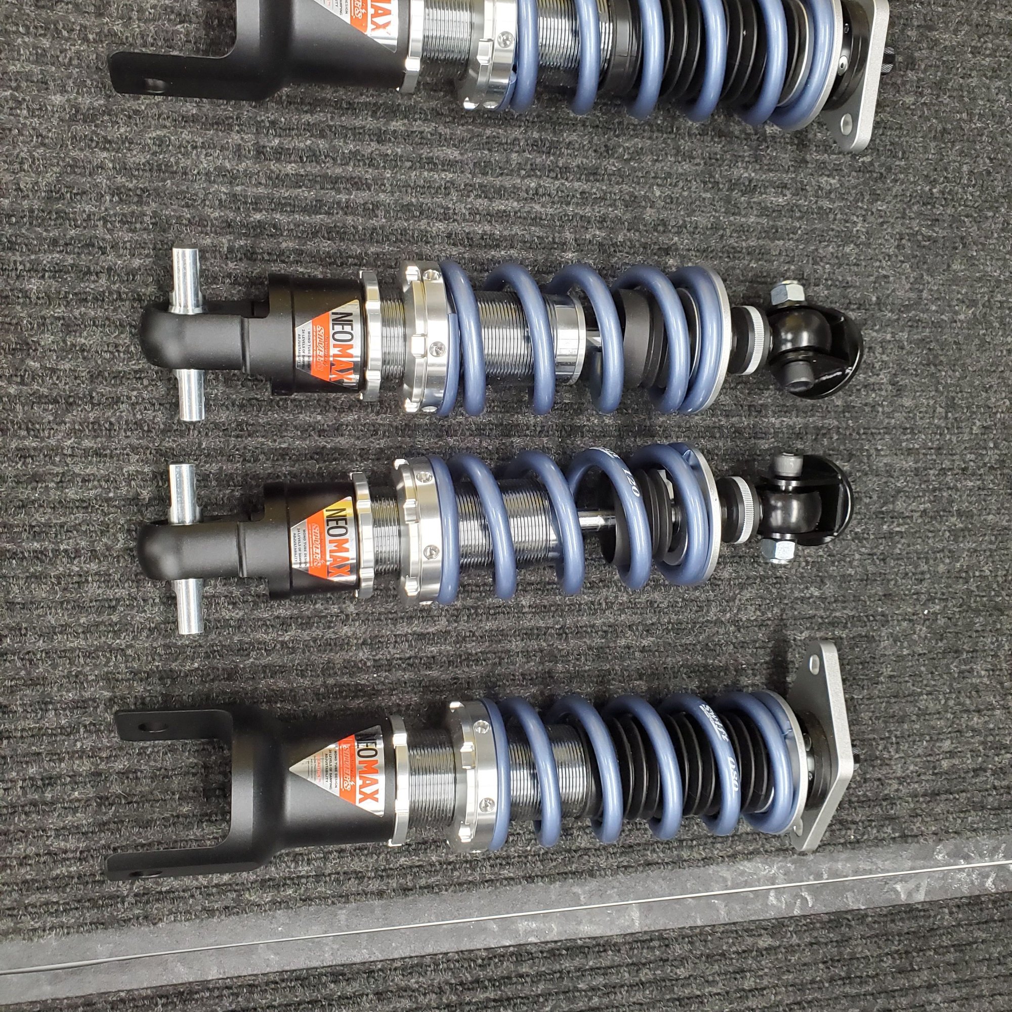

I have a 2000 C5 coupe with some bolt on mods (corsa full length headers with xpipe and corsa extreme full exhaust, cats removed, COW tune, vortex airbox, thats about it but it sounds amazing). I don't autocross or take it to the drag strip. I drive it occasionally but it is not an everyday driver. When I do drive it, I am driving with a heavy foot and a big grin. I'm tossing around the idea of getting a set of coilovers. Currently I'm on lowered bolts on the factory setup and have the lowered look but the ride is horrendous on most roads. Rides like a horse and buggy. I was hoping a good set of coilovers would achieve both the lowered look and a good quality ride. I can't make my mind up on which coilovers to get. Started out looking at Aldans (saw quite of few people have some complaints) then on to BC racing (couldn't find many recommendations for them) and now looking at the Silver's Neomax. Budget is around $1,500. What do you all suggest and where would you suggest I get them from?

Ridetech HQs have been great for me. The car has both good manners and impressive handling. Yet, not in your price range.
Check out Silvers. Not sure if he's an approved vendor here, but Brian Rosenberg of FI Performance which you can readily find on C5 Modified FB forum is moving them left and right.

I went ahead and purchased a set of Silver's Neomax coilovers from Brian yesterday. I hope I don't regret it.

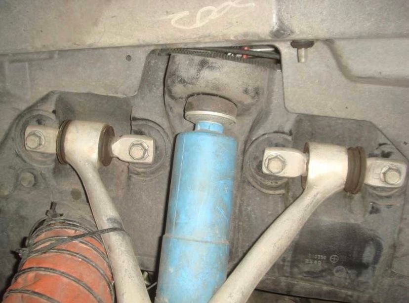

I went to Bilstein B8 on lowered stock and the ride characteristics improved significantly but still has terrible side effects.
Overall ride is much better and firmly controlled but It still can bottom out hard and oppositely almost lift you out of the seat over a sharp rise. Not sure spending money on composite leaf’s would compensate but I also can’t speak about a decent Coilover either.

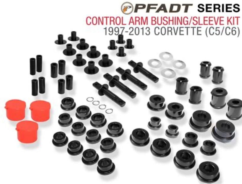

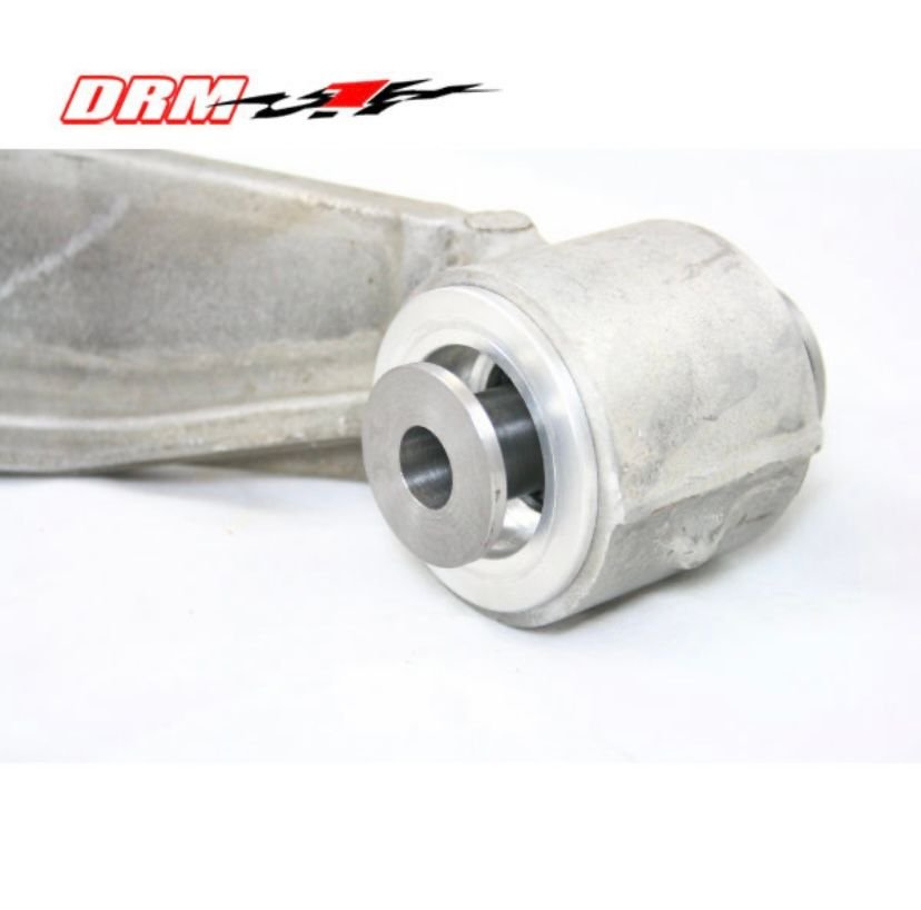

There is a benefit from replacing control arm bushings with Poly or new oe whichever way you choose
