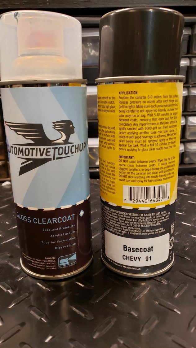

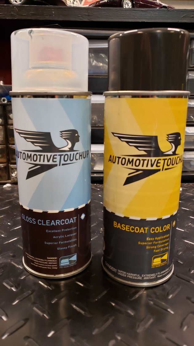

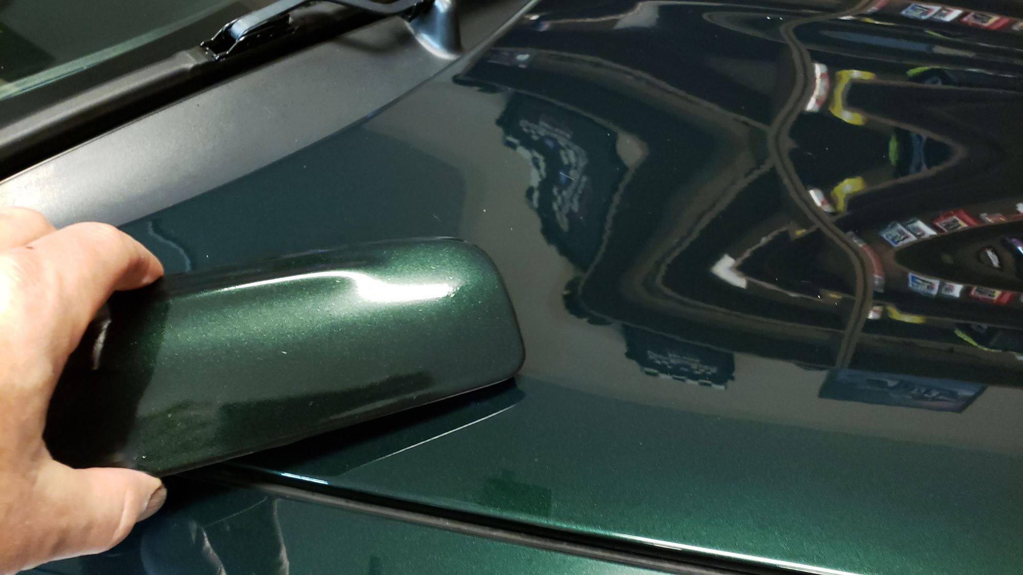

Tony, I've had a proper color match with automotive touchup. Com
As you can see, I ordered the "chevy 91" and it was a dead on match for our Dark Bowling Green Metallic.
I think Dr Colorchip is better for non-metallic colors, as the application process doesn't really allow the metal flake to "blend" evenly. Hope that helps!

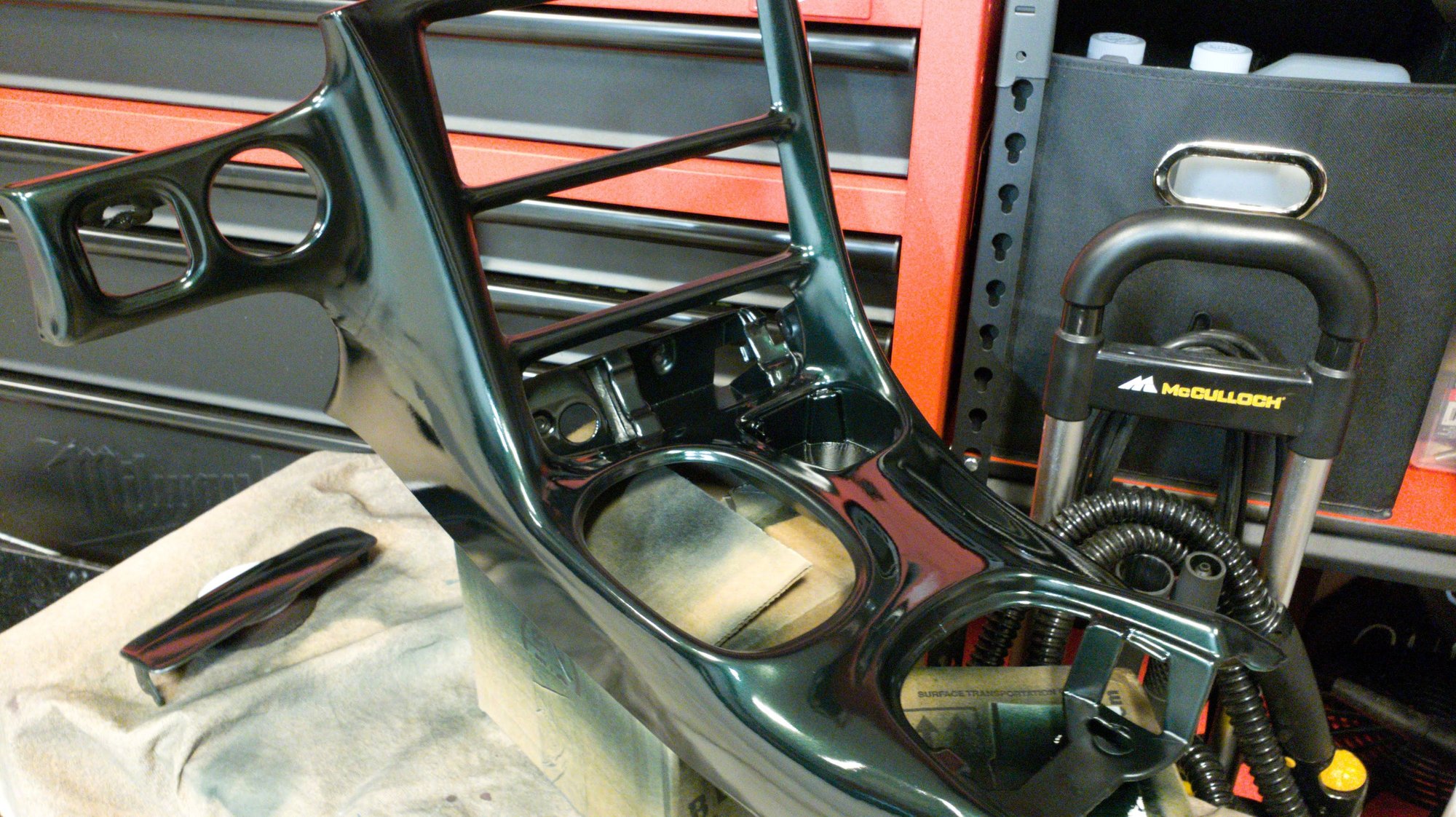

Here is the center console I painted with the product-
Do you have any pictures of the painted console installed in your car? I'm intrigued by that idea.
