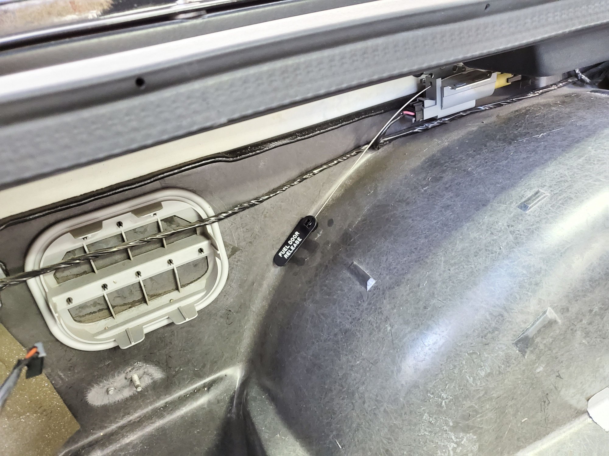

Yeah, can be a pain to get that sucker hooked back up. If for some reason that does not work, take a paper clip and use it as a jumper between the two contacts (I believe it's a four slot connector but only two slots are used) and that should pop the door. If that doesn't work, there is a cable behind the driver's side wheel well that will pop the door manually.
