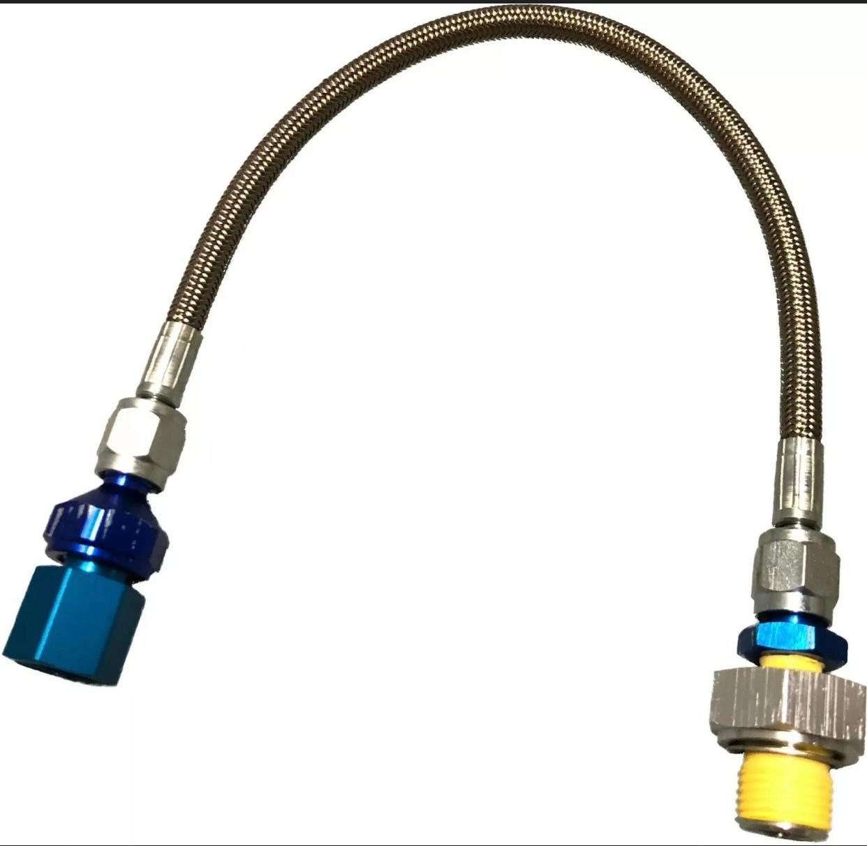

Originally Posted by jdmvette
My sending unit went out again last week. I originally replaced it somewhere around 2005 so it lasted a good while.
I ordered this relocation line that was fairly inexpensive and should prevent going thru the hassle in another 15 years or so.
there are other posts on the forum with the exact parts needed for less the half the cost...for those who want to save a few bucks.

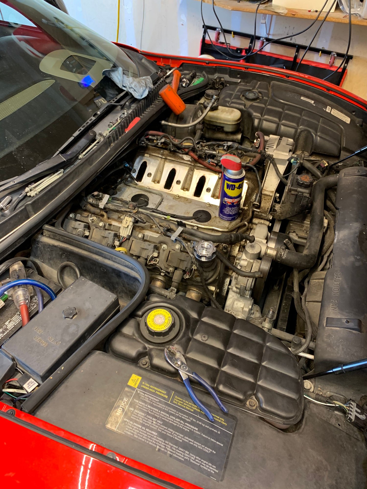

Originally Posted by grasshopper645
Am I the only person who's replaced the sender without pulling the intake?? just use a swivel adapter and a deep socket, reach in with long needle nose pliers to pull the connector off. Bit of a pita to get it back on, but easier then pulling the intake lol.
In my case, I had several other things I wanted/needed to do that would require pulling the manifold. I had cracked the PCV hard lines (which had become brittle over the years) trying to install a new PCV valve and to replace the hard line unit, the intake has to come off. I was pondering doing it when my oil pressure sender went out. Then, once I had decided to pull it, I also decided to replace the knock sensors and their wiring harness and the AIR check valves. Also decided to put in an oil catch can, although that doesn't require intake manifold removal.

jdmvette's Avatar
jdmvette
Night Owl for life
Joined: Nov 2003
Posts: 24,699
Likes: 4,542
Putting in that relocation line this afternoon so I won't need to worry about it in the future
