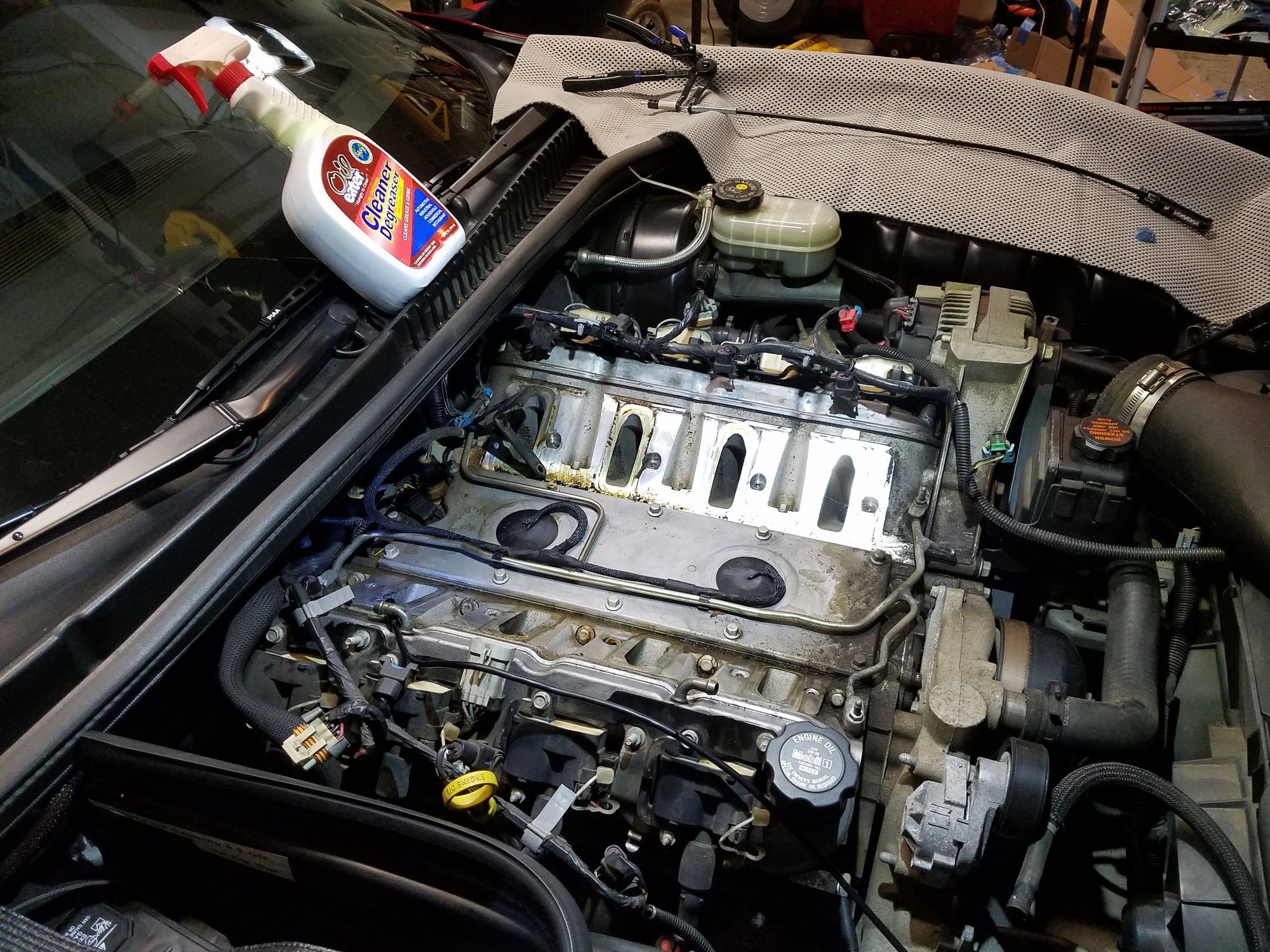

I did mine a couple of years ago. It is not as cut-and-dry as an oil change or even, rotors and pads, and those passing it off as easy are coming at it with significant experience. To a mechanically-inclined but not trained and inexperienced advanced beginner, it can seem a bit daunting - disconnecting fuel lines, removing a big component like the intake manifold, wires everywhere, cats and dogs living together, mass hysteria! (Sorry, got carried away).
I decided I would install a relocation kit as, despite my OEM sender lasting 18 years, I have read enough to know there is a fairly high failure rate on replacement sending units and I wanted it to be an easy change if it became necessary. I decided that while I was in there I would also replace a bunch of other bits that you need to remove the manifold to get to - knock sensors, AIR check valves, changed a bunch of hoses and clamps, managed to damage the Throttle Position Sensor during the process so had to replace that, PCV hard lines, and added an oil catch can. I researched it thoroughly beforehand, read many articles/DIYs/threads and put together my own step-by-step checklist. It went well, with the typical unexpected items that always arise (the Throttle position sensor, stripping out one of the intake manifold bolts on disassembly so had to order a new set, delaying the job for a couple of days) and car ran great, no problems . . . for five months. But then started getting a knock sensor code. So, everything came off again and . . . I guess I hadn't torqued down one of the knock sensors and it was loose. Ah, well, the Doofus Factor at play.
All has been good since and the experience gave me the knowledge and confidence to do an intake manifold upgrade on my BMW 328i E91 daily driver (stock 328 engine put out about 230 HP but same engine in other BMWs gets up to 260 HP with a 3-stage valved manifold and a tune for the new setup).
I have the step-by-step checklist saved so could share it with you if it would help.
K9Leader aka Rob in Delaware
Pulled apart
Cleaned up and new gaskets
Put back together, although this was before I put on the oil catch can
The oil catch can completed the job

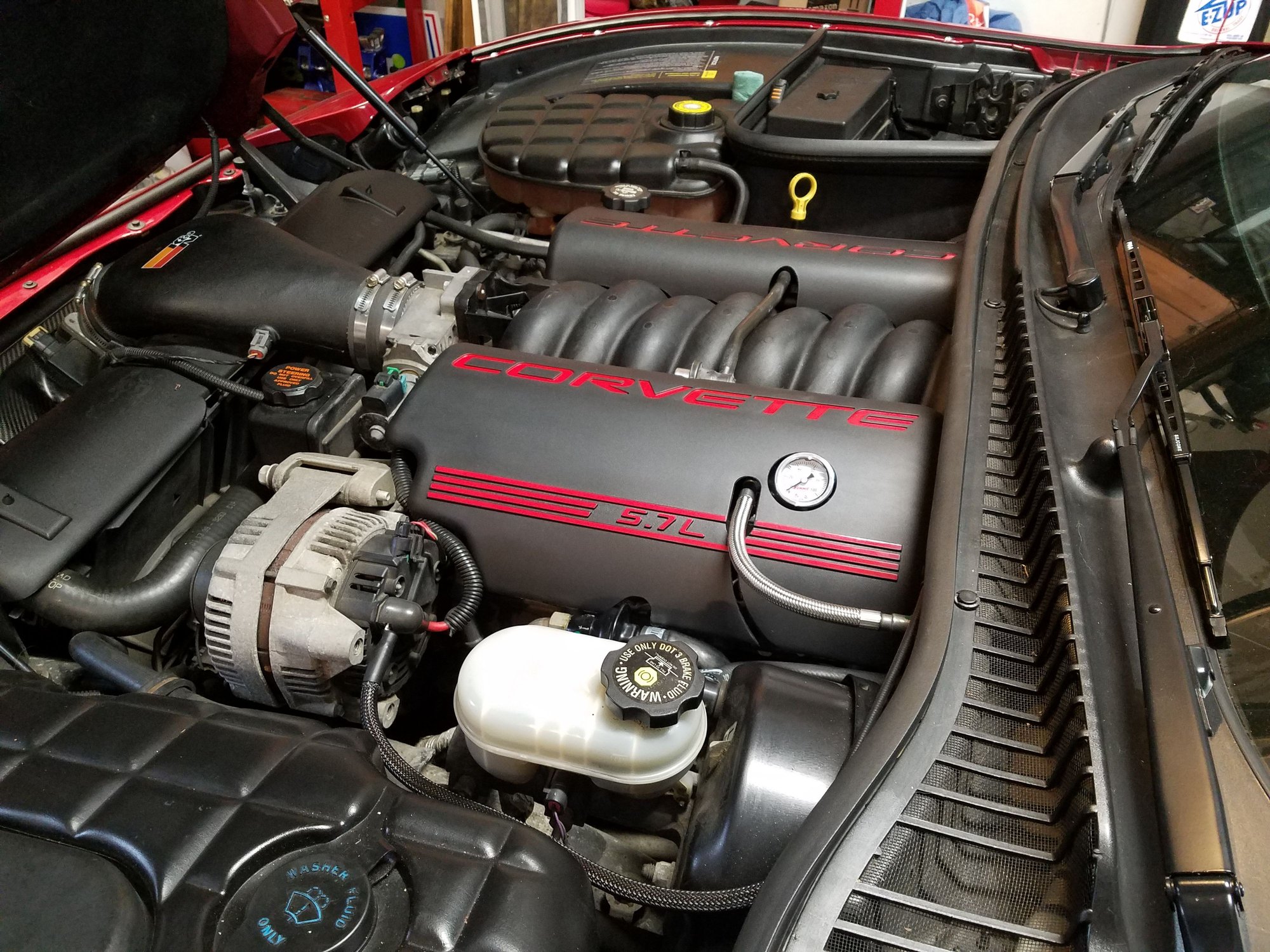

I relocated mine in August, 2017, added a mechanical gauge under hood. The relocated "new" sender unit failed early 2019, took me 10 minutes to replace it.

Can anybody explain the purpose of the two "foam" seals that are at the ends of the manilfold? When I replaced my oil sender, a couple of years ago, I removed the OE foam pieces, in order to install a DEI heat insulation shield, and I didn't think there'd be enough room for both items to fit in there and properly compress, so I left the foam out. Later on, I thought that maybe it was a mistake.
Any ideas?
Any ideas?
their purpose is to keep debris out.
I left them out when I removed the ribs converting to an LS6 manifold.
i also feel that it was a mistake not putting them back in with new ones.

Yeah they help keep debris and water out of the knock sensors.
I always seal the knock sensors with RTV, that way the foam seals have less importance.

My old knock sensors were pristine - no signs of water at all so I did not RTV seal them. But the foam does act as something of a barrier, although mostly for dust and other solid debris.

My sending unit went out again last week. I originally replaced it somewhere around 2005 so it lasted a good while.
I ordered this relocation line that was fairly inexpensive and should prevent going thru the hassle in another 15 years or so.
