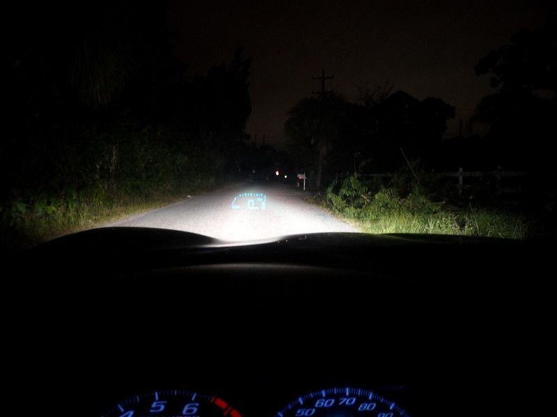

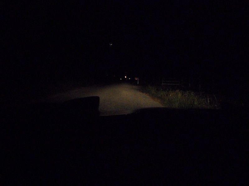

I'm the opposite, majority of my driving is at night. and my street has no street lights
I went with projectors. the difference is literally night and day. I went with the stealth light cannons. the pics comparing low bean vs low beam.
light placement is major key if you want actual functional lighting.

That's an amazing difference!
