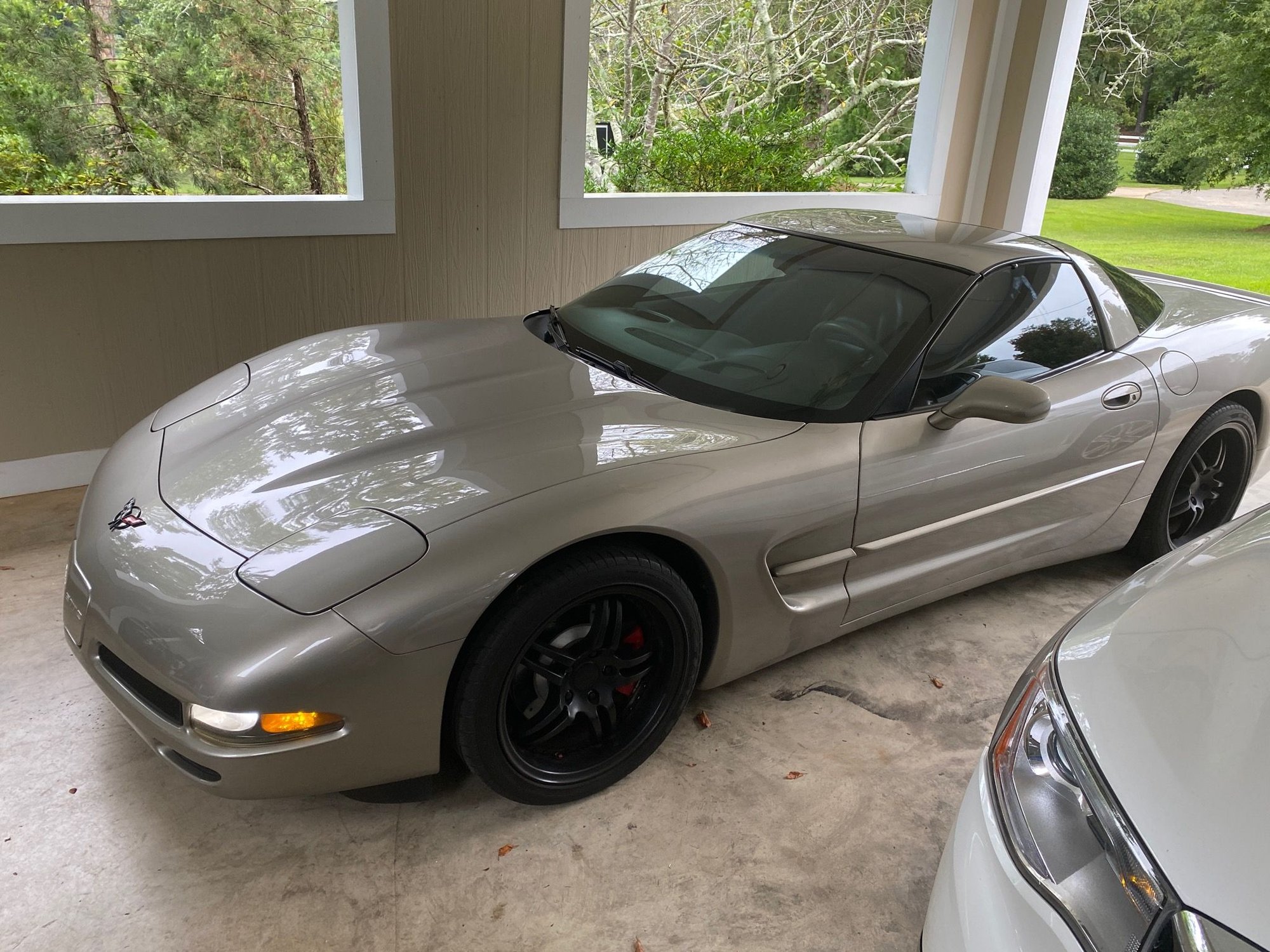

Post a picture of your car, so we can see how high/low it currently sits.

Just purchased it... it has only 35K miles on it. The owner had it already lowered it. I want to raise it back to factory. It seems bumpy to me... but it could be the tires...

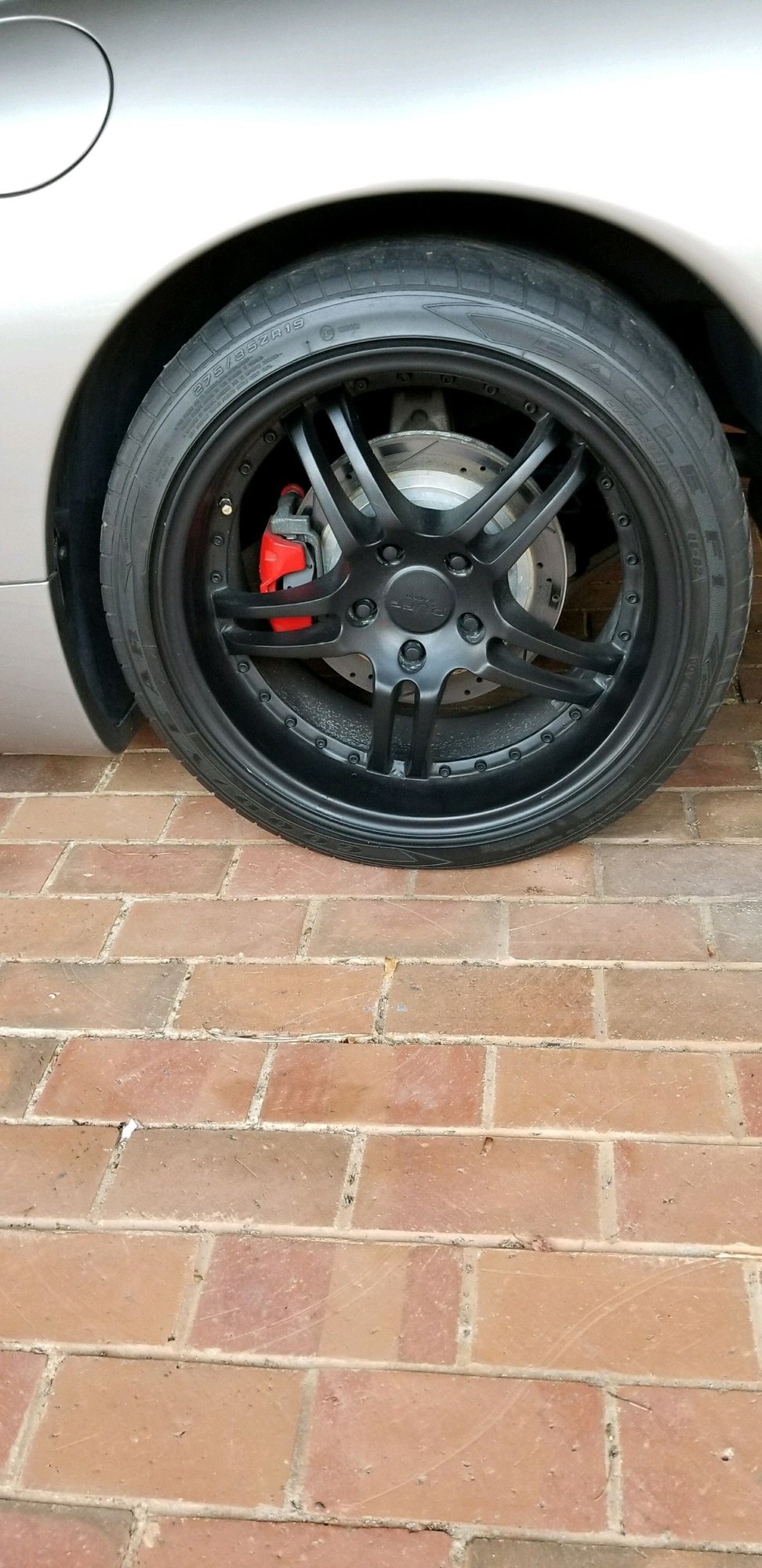

Nice looking car. Overall, it doesn't look all that low, and the front looks higher than the rear, which isn't good for the aerodynamic balance of the car. If you're insistent on raising it, I'd bring the rear up about 1/4-3/8", and leave the front as-is....
