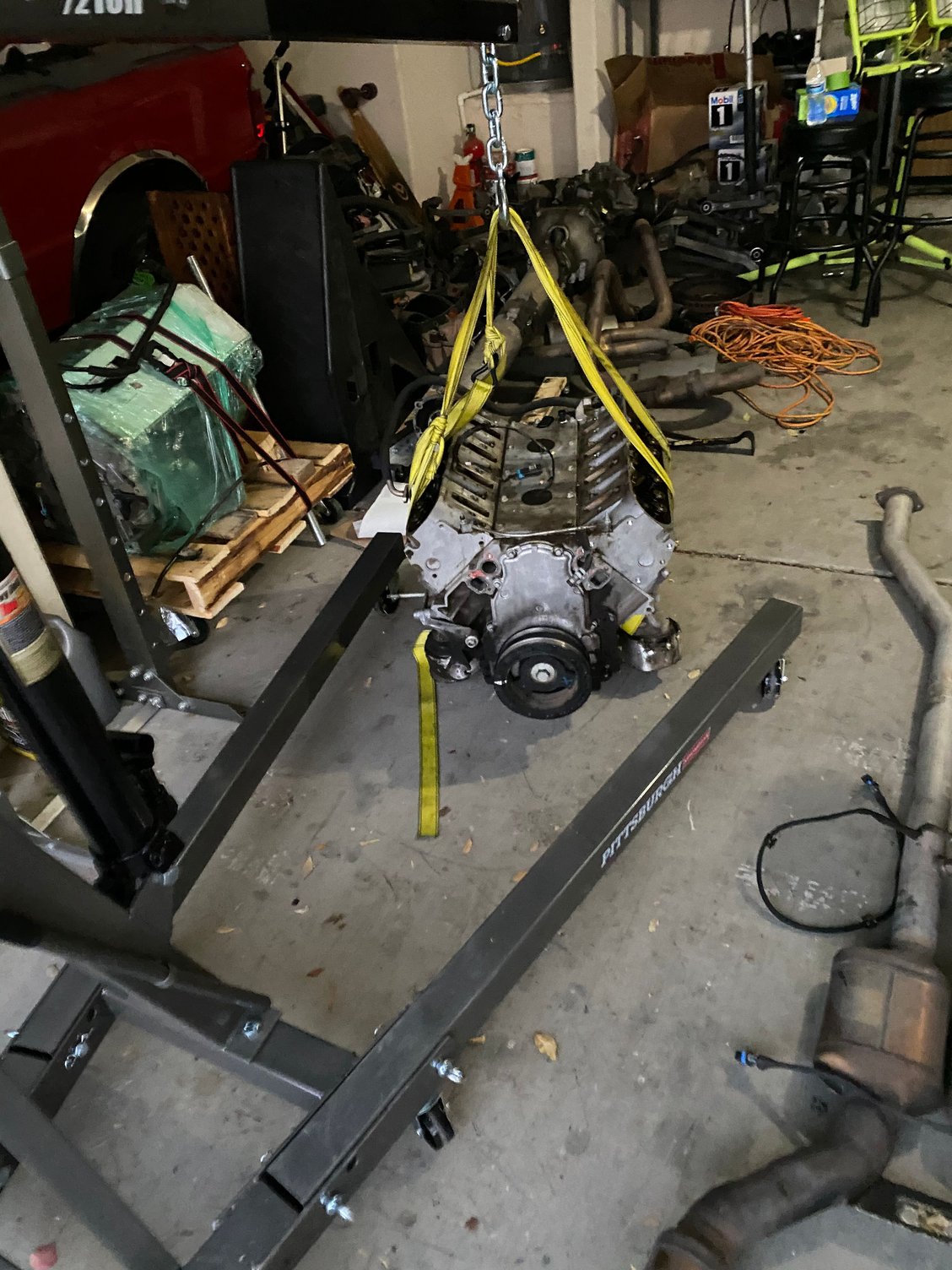

Originally Posted by mrwick01
Let me ask a dumb question what is a harmonic balancer and where is it in the path of the AC belt.
think of it as the crank pulley. The big black wheel on the bottom middle that drives both belts.
The only one left on this engine.
