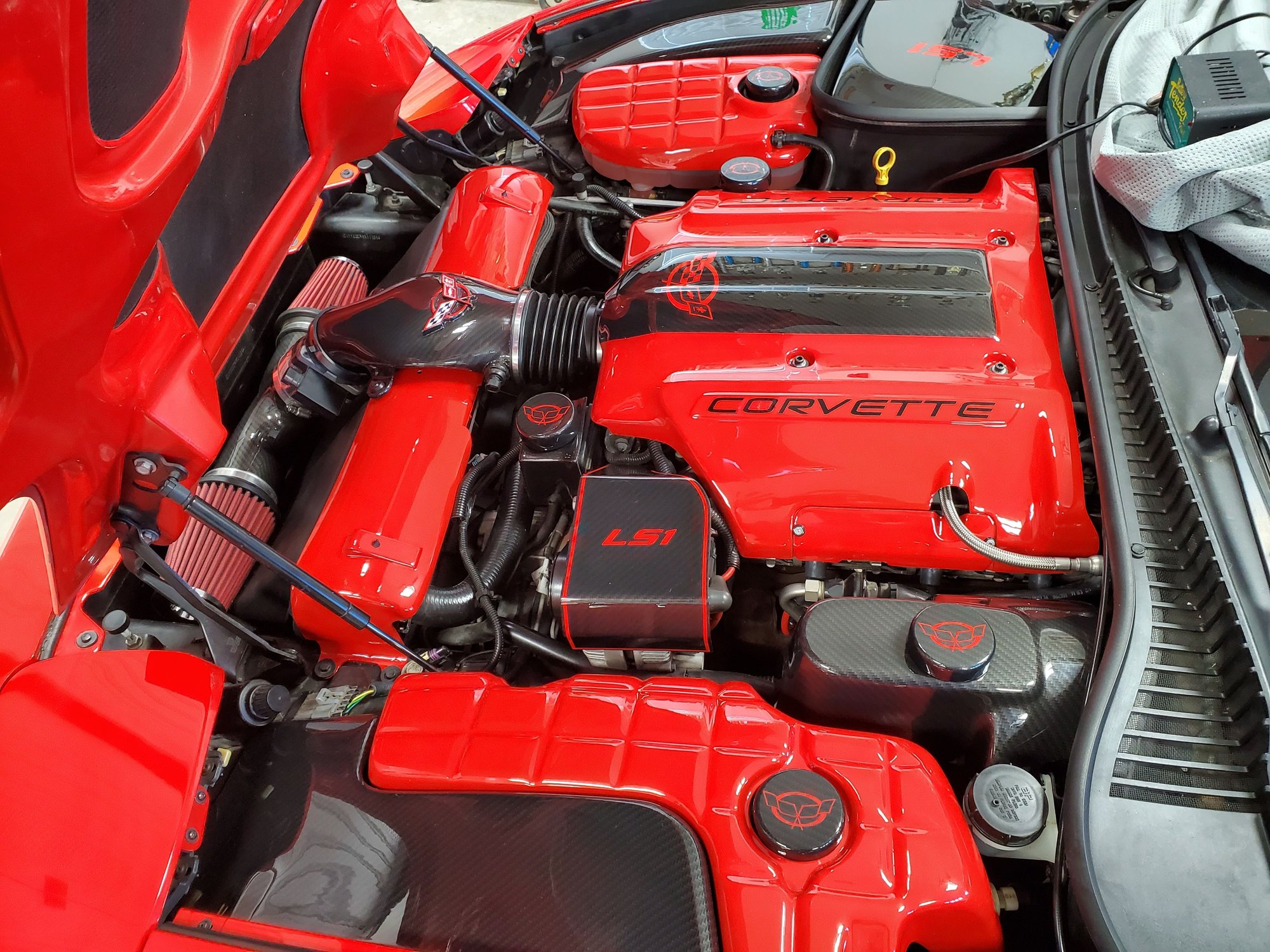

I have one like that in my red 99. They "claim" to increase horse power by like 15. I seriously doubt that, maybe 5 at best.
@knewblewkorvette Damn you're engine bay looks awesome. You should have made more room in your new garage just for your trophies!
