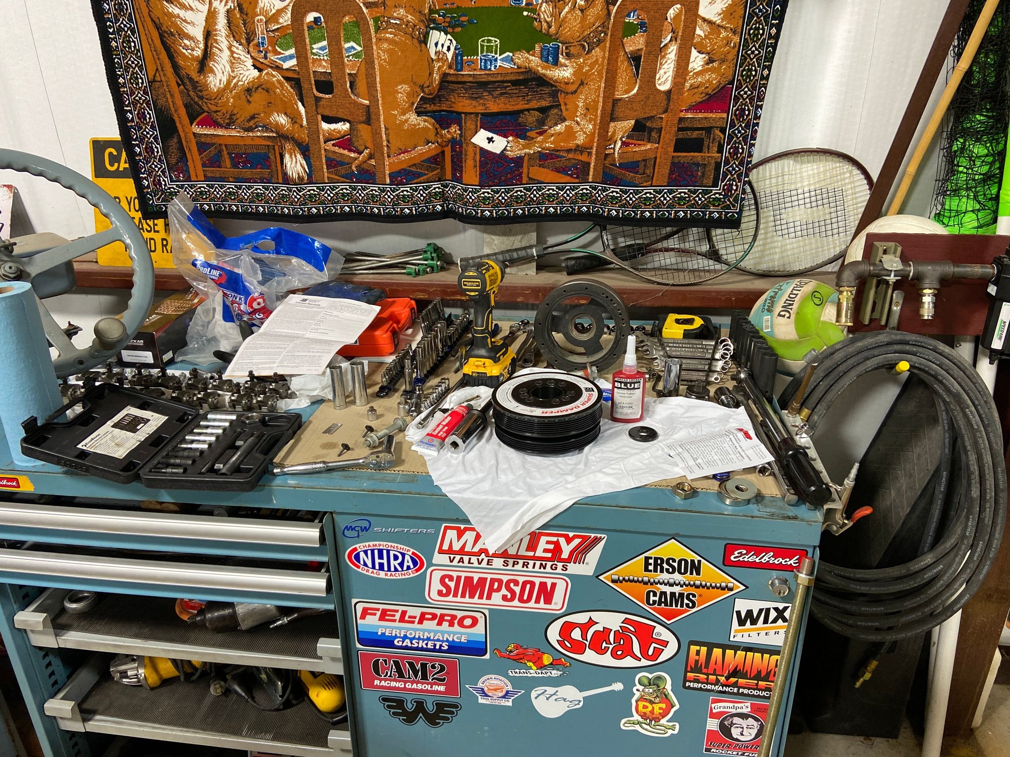

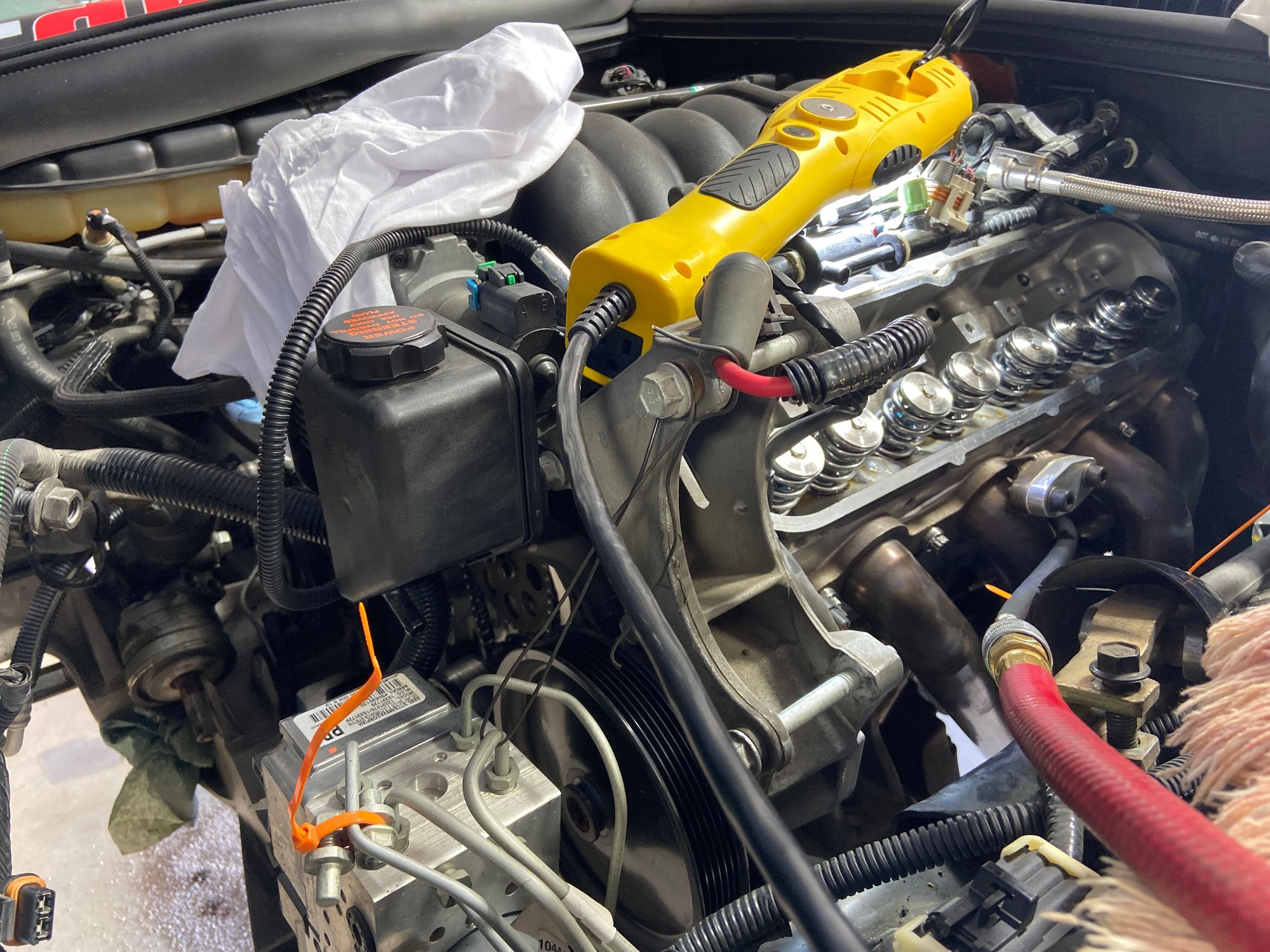

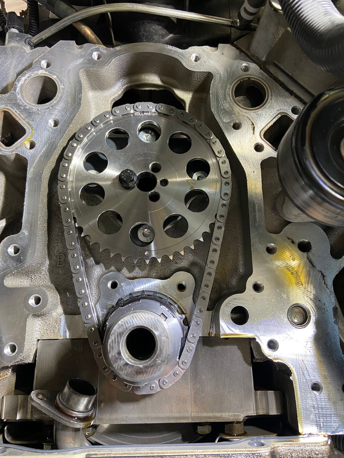

Finished installing my new cam last Friday. Taking it to get tuned next week.
New dual valve springs, seals and titanium retainers
New timing set
New Melling high pressure oil pump and ARP cam bolts

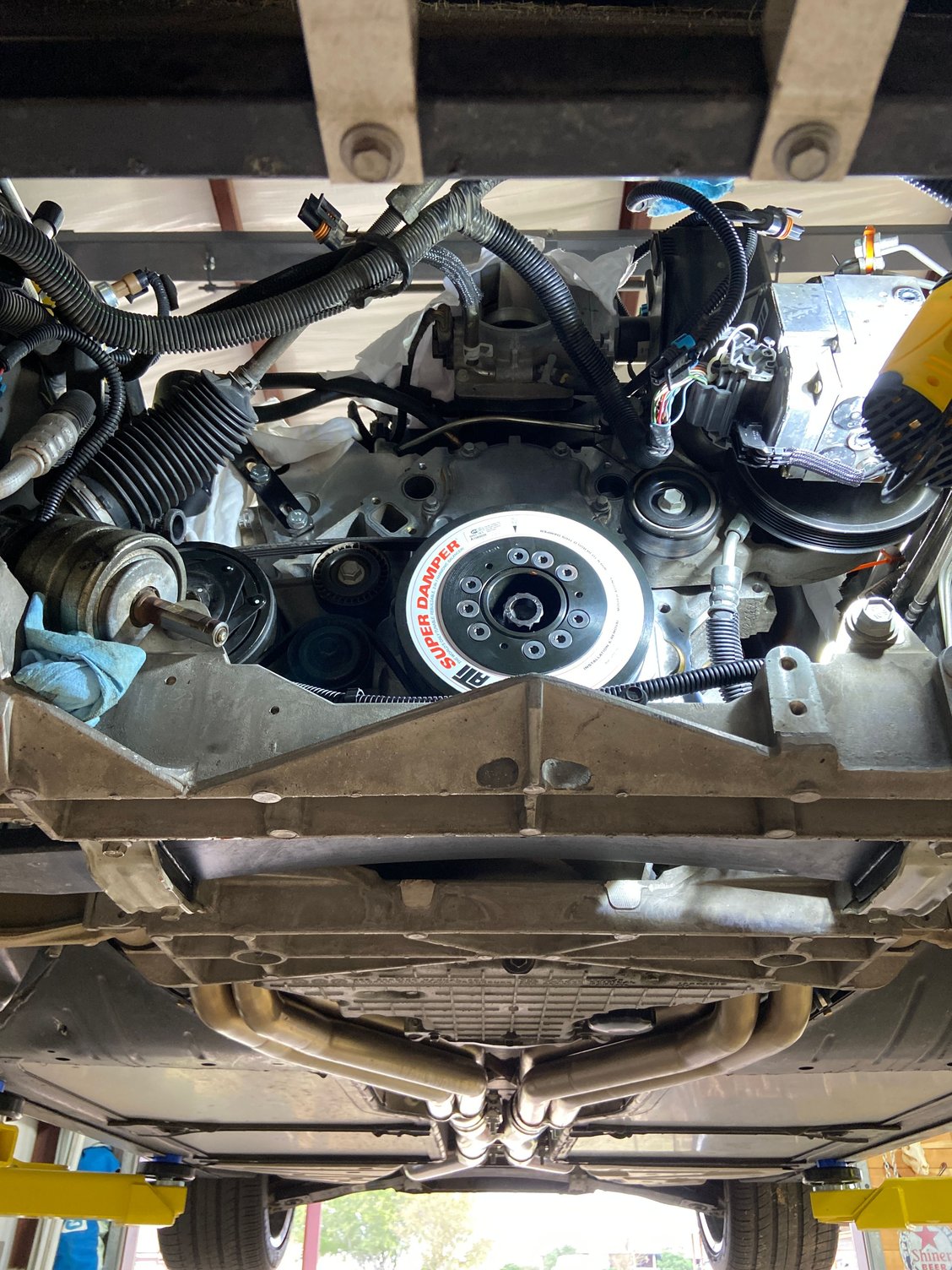

New ATI super damper and ARP bolt

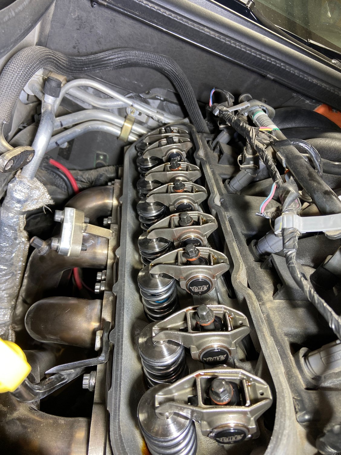

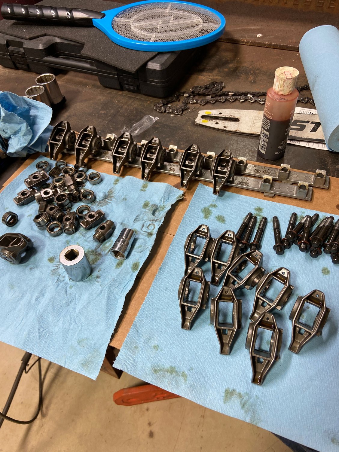

CHE trunnion kit
Assembling trunnions
Rockers with new trunnions

Nice work, was this your first time doing these upgrades? What’s the difficulty level and how long would you say it took?

First time doing it anything like this. I have the service manuals and watched videos and read up on it. Talked to my tuner and Texas speed beforehand. Everything went smooth, not like the horror stories and problems I was reading about. I guess you never hear about projects that go well. I had my parts and tools ready before I started. Lots of disassembly to get to the cam but I took my time, kept track of hardware, everything came out and went in perfect. Probably a week start to finish. Maybe one full day and the rest after my normal job in the evenings.
Was pretty nervous when I turned the key to start it. I’ll try to upload the video of it running when I get home, it’s not letting me here for some reason.

The pics were while I was working on it in case I wasn’t clear. It’s all back together and running. Didn’t want to post pics before I was done n case I effed it up. Just waiting for a tune appointment next week.
