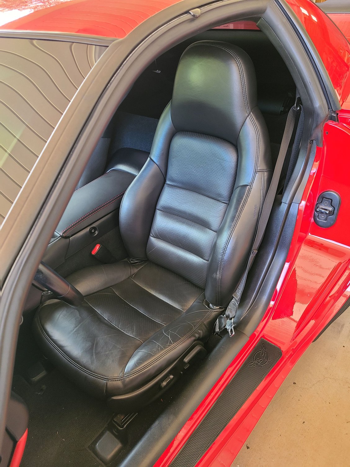

I put c6 seats in my c5. They fit great and are alot more comfortable. I used the harness in the link above for power. I found my c6 seats on facebook for $500.

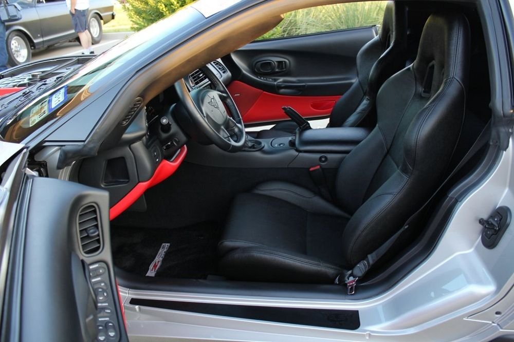

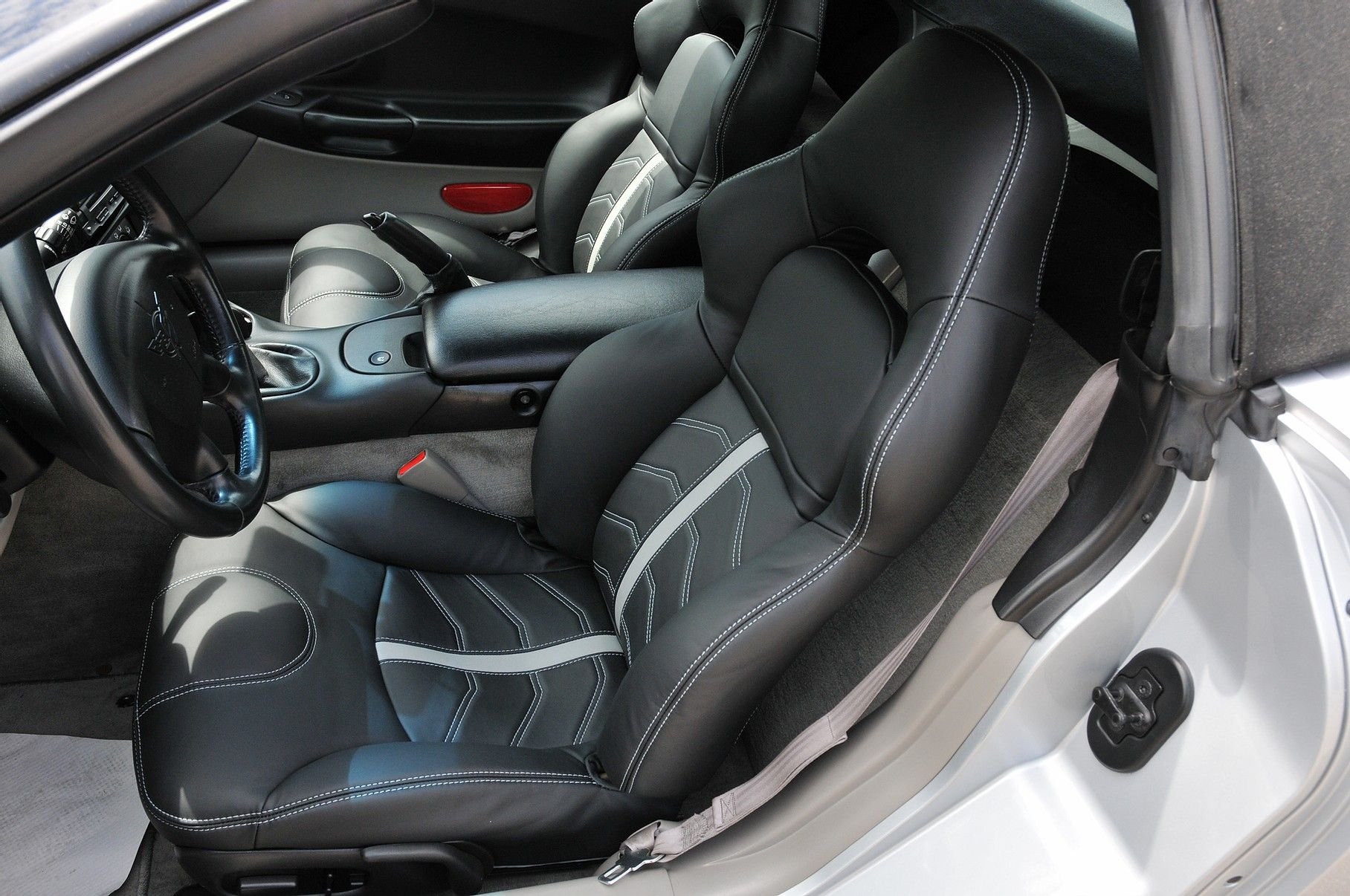

From an aftermarket perspective, Corbeau A4s are a popular and economic option at $1200/set for the black leather version. Another more expensive option are Caravaggio C5 sport seats at $3400 which are entirely rebuilt seats off the original C5 seat frame so the power controls are maintained. Caravaggio claims that they fix the rocking seat issue and also incorporate better padding, support frames, and denser memory foam underneath their custom (Ferrari-style) skins.
Corbeau A4 (Black Leather)
Caravaggio C5 Sport Seats

The c6 seats are definitely better made and are heavier. The backs are solid. They also offer more side support but not quite as much as racing seats. I'm kinda of a bigger guy. I have very wide shoulders and cannot get comfortable in after market racing seats but the c6 seats are perfect for me. If I was a slimmer build I would have gone with the Corbeau or Braum seats.

While the C6 seats look bulkier and definitely feel more solid, they're actually not much more than a few pounds heavier. I weighed mine when I switched them out. IIRC they were ~5 lbs heavier per seat. This was C5 Sport power seats vs fully loaded C6 3LT seats. I'm probably an average build (5'11" ,180-190 lbs) and the inflatable bolsters in the C6 seats do come in handy.
If you're patient and vigilent, some good deals on C6 seats pop up on occasion. C7 seats are nice, but I had no interest in paying anywhere near what they go for lol.

I just finished putting C6 seats in my C5. The C6 seats were full power, my C5 seats were full power and I purchased the adapter from vetteworks.
The adapter took about 2 weeks to arrive and it was plug n play. I was extremely happy with how easy it made the hookup until I found out the telescoping wheel doesn't work. I didn't mind not having memory but the wheel being all the way in is something I don't like. Dan from vetteworks told me as well that he's working on a solution but I couldn't get a timeframe. I have to wonder if someone has figured out which slot on the adapter power could be added to to get it
to work.
The only other thing I had to do was remove the C6 seat belt receivers and bolt my C5's in their place. I also had to cut off a threaded stud on the outside of the seat near the hinge so the seat could slide all the way back, the stud hit the trim where the belt slides out.
It's an amazing change in comfort, wish I would have done it along time ago.
