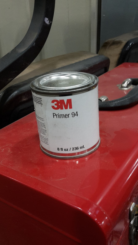

If you want to double the adhesive strength use some 3M Primer 94 a clear solvent like liquid that dries quickly and can be put on with your fingers or a rag.
You can buy it in tubes on Amazon or eBay
