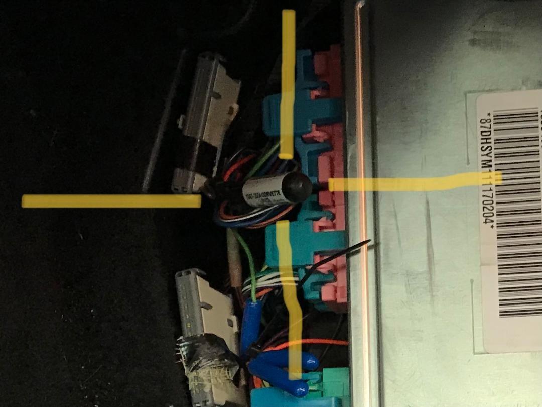

Does the LMC5 remove the locking ability of the steering column? My car never had the locked column problem. While it was in a shop having some other work done, someone apparently bypassed the lock somehow. Because now it doesn't lock. I got no itemized bill on the work at all. They also cracked my radio bezel. Since I did NOT notice the cracked bezel, or the inability of the column to lock, once I left the shop, I can prove nothing. They will do nothing, either. So I'm no longer communicating with anyone there. Is the LMC5 the reason my column doesn't lock? Thanks guys....
Without speaking to the shop or having an invoice for the work they did, it is hard to know what the shop did to your car or if the column lock was correctly disabled. If one follows the directions on the LMC5 installation, one will end up disabling the column lock. Here is a photo I took after installing the LMC5. I put some yellow cross hairs directing you to the device. If your car has had this installed the LMC5 might not be in this exact location, but it should be close. You will need to pull the carpet back on the passenger side footwell to look at your body control module (BCM). The LMC5 device is wired into the BCM. Hopefully this helps.
Lastly, you should be aware that there are/were other devices out there to address this problem, I suspect none accomplished this mission as easily or as effectively as the LMC5. See for example this one, "Dr. Don's":
https://www.youtube.com/watch?v=3jrmFvQmVpA
Thank you for making the extra effort. Am I correct in assuming that if the LMC5 is installed correctly,, I could remove it, and carry it in one of the rear compartments in my 2000 Vert? My column NEVER had any issues before. I'd like to have all the VATS working. If there were no problems before, there shouldn't be now. My car is an A4. Wasnt this a bigger issue for the M6 cars?
