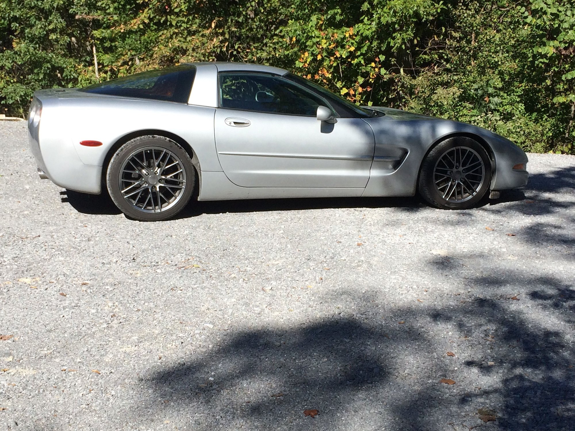

Originally Posted by jackthelad
I run 18/19's lowered. I lowered on OEM bolts (about an inch) so that the wheels were centered in the openings - i.e., the "air" over the tops of the tires was about the same as the air in front and behind the tire. I am running standard C6 tire sizes - 245/40x18 up front and 285/35x19 in the rear - as there are a lot of options in those sixes. I chose Michelin Pilot Sport All Season - we get winter here and I drive it all year round. And they have more grip than you can safely explore on public roads. Even got me home in snow a couple of times.
was just searching thru threads you replied in, hoping to see a pic of your setup. struck out. care to share one here?
Your back tire siZe is what i have decided on. the fronts i'm leaning to 255/40.

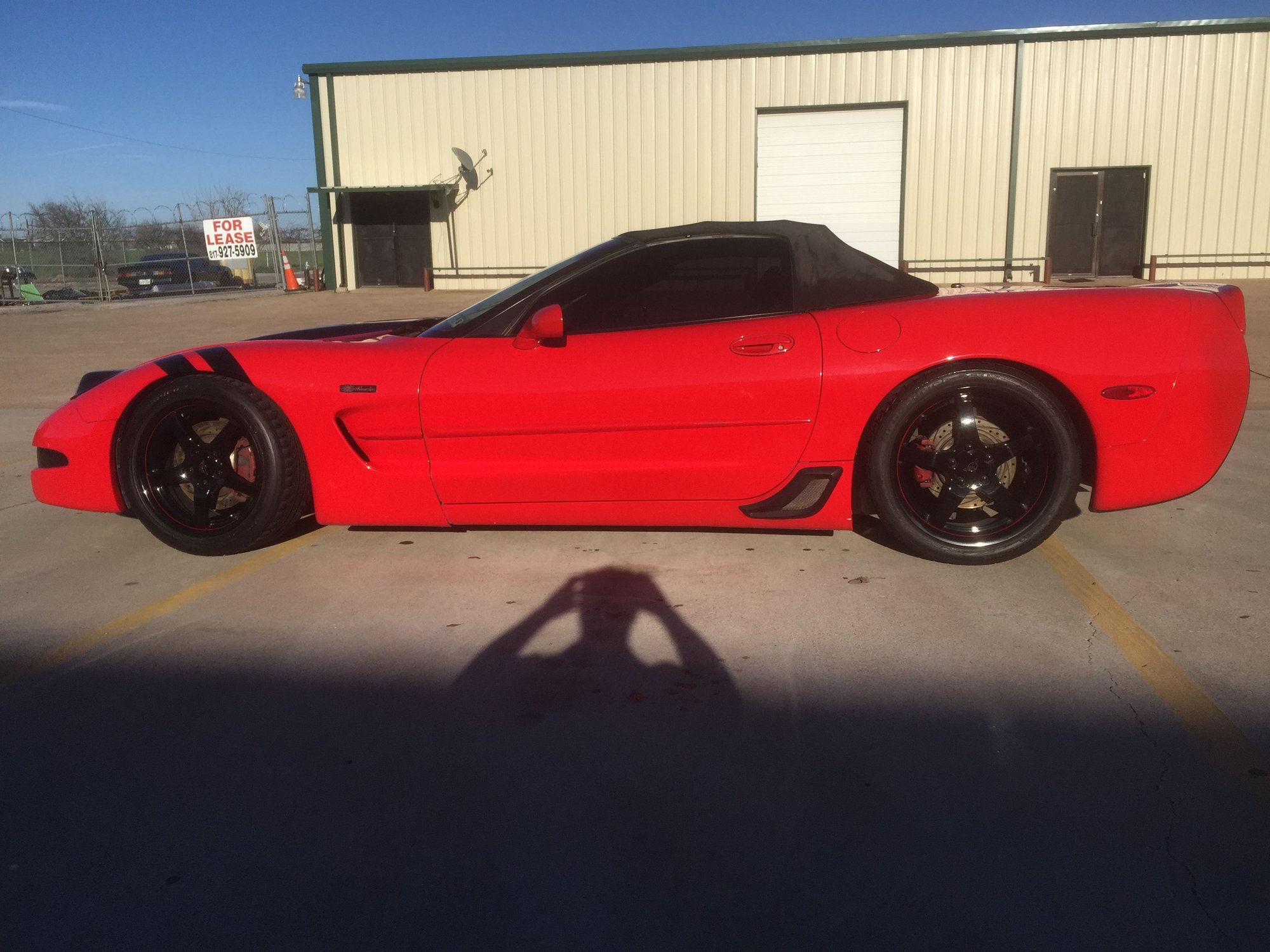

This was my same set up as well before I snagged my CCW's. Here it is for reference for you. I'm lowered on coilovers but this is still the same ride height was at when I was lowered on stock bolts as well. Make sure and look up the all 19's look as well. If I had to do it again there is a good chance I might would run 19's in the front as well so that both tire wall widths match. BUT the 18's with the 40's do ride smoother over bumps and pot holes, etc.

Here's a quick pic. I went with the 245's up front to maintain the front/rear ratio and because it's a size widely used.
