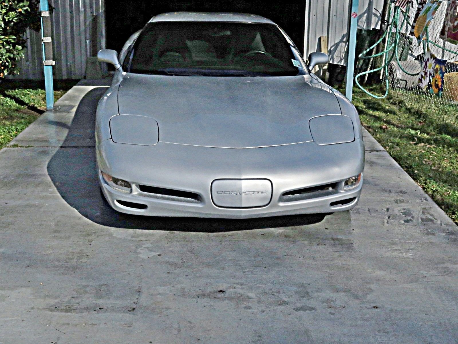

And, as of about 9AM today, Da Vette is a done deal.
A trip about town, coffee and conversation at the Fire Station and back home to wash Da Car.
All is good.
And Da Truck gets a break!
If I ever had to do this job again, I would do it a different way for sure but with cold weather and lots of rain, it was get er done and back on the road.
Total cost was right at 859 bucks from start to finish. llllllllllllllllllllllllllllllllllllllll llllllllllllllllllllllllllllllllllllllll llllllllllllllllllllllllllllllllllllllll llllllllllllllllllllllllllllllllllllllll llllllllllllllllllllllllllllllllllllllll llllllllllllllllllllllllllllllllllllllll llllllllllllllllllllllllllllllllllllllll llllllllllllllllllllllllllllllllllllllll llllllllllllllllllllllllllllllllllllllll llllllllllllllllllllllllllllllllllllllll lllllllllllllllll

Remember I started with this.

Congrats on a job well done! She looks good as new.
