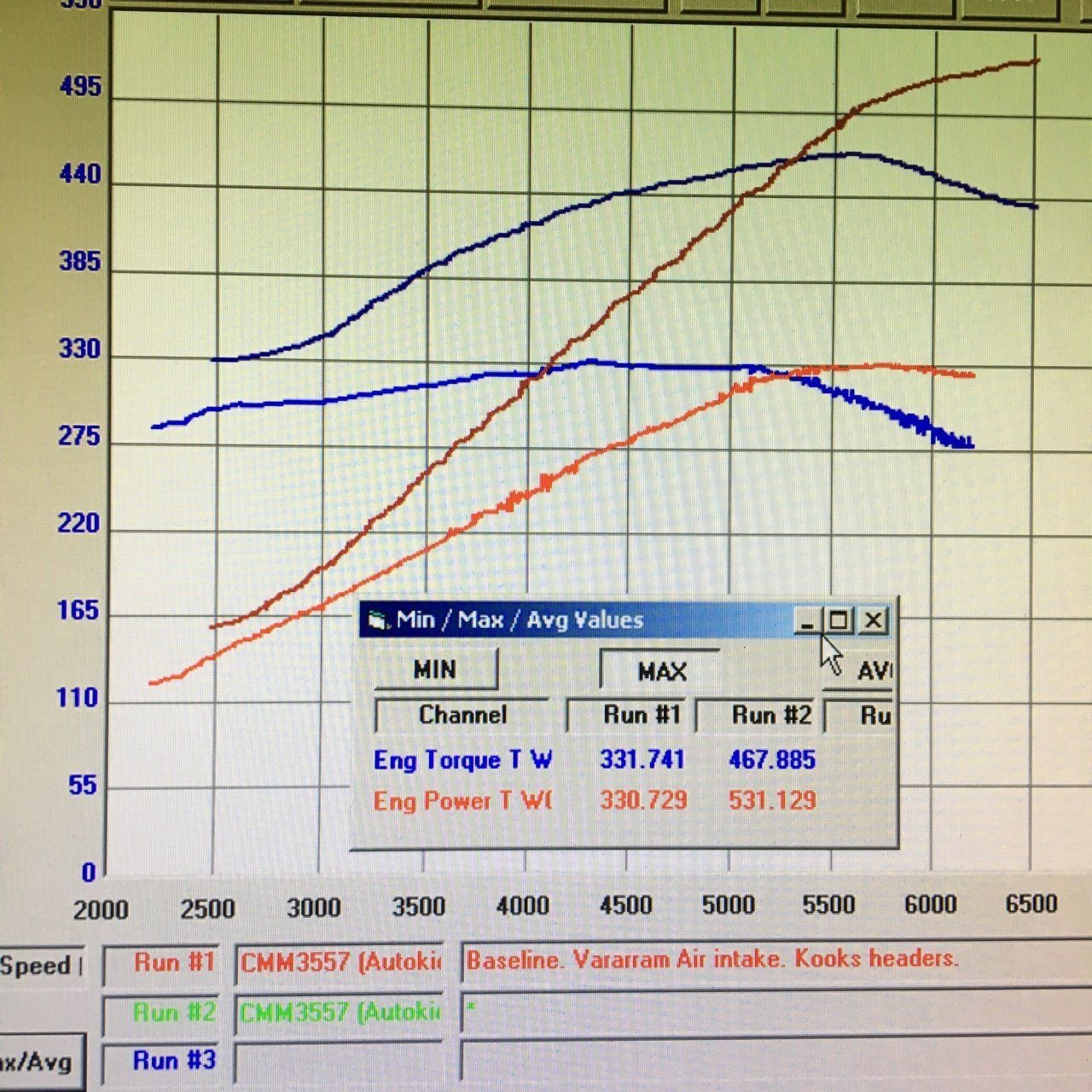

super charger.
Here's a before and after curve... before curve had headers, cold air intake, manifold, z06 cat back, and a tune.
After curve is all that with a super and a cam.
