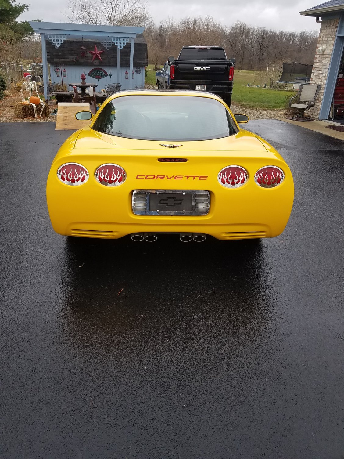

Hello..I just purchased a C5 with the stainless flame inserts on the tail light lenses..how are these removed? Will they leave any damage behind on the lenses? Thank you

Unscrew the tail lights on the bench and use heat and some fishing line to pull them off, if they are adhesive backed.

A picture of them would help

It looks like if you remove the tail light screws they will come off

According to the vendor that sells them, they are stuck on with adhesive backjng

Use a heat gun, gingerly as you don't want to mess up the housings.

I m worried about them leaving adhesive on the lenses

I’ve seen some oem tail lights sell for less than $100 so if you can’t get them all the way clean you always have a back up.
or you could spend a bit extra and get some nice LED tail lights to upgrade.

I wouldn't be too worried. Some goo gone and PLASTIC razor blades can take care of any leftover adhesive. Worst case, scuff them up with 600 grit and spray 'em:

Goo gone and done if the are stick on

remove lenses, try a hair dryer first, work them off & clean off the goo
I've had to remove many emblems/decals/stick on doo-dads over the days, it's very doable without damage

Goo-B-Gone or 3M Adhesive Remover will make short work of the residue. An old credit card makes a good scraper.

I have lots of stainless steel on my 02 show car but even I find those Looks like there are caps over the screws so pop those off. Unscrew and I'm guessing 60/40 that there is no adhesive (at least my SS covers do not use adhesive)

I think u are correct..I talked to the seller last night & he said the same..thank you
