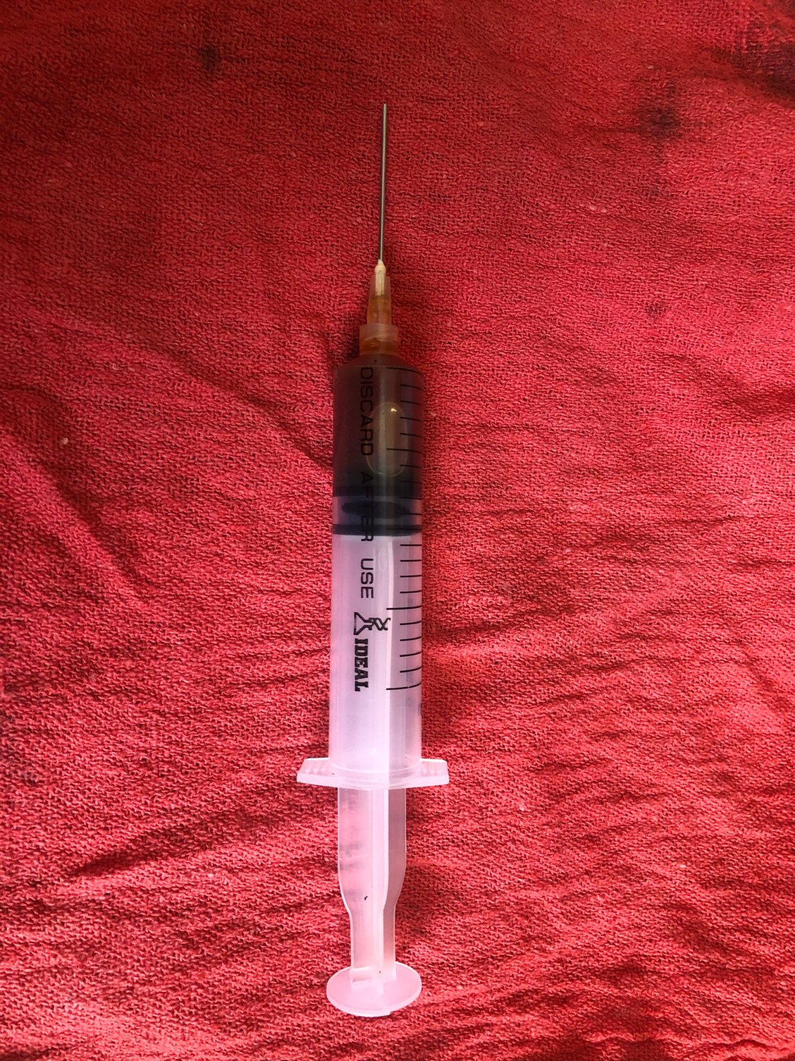

Man, I've been a big believer in oiling hinges for years. Can't stand a door that sags! Go to your local Farm Supply store and get a syringe and needle. This one is over 10 years old, but they are very inexpensive. Allows you to get the oil just where you want it. I'm old school and use straight non-detergent 30w oil, but I'm sure there are others. The needles are extremely sharp and you may want to file it down a little.
that seems a little aggressive for lubing a hinge, but hey what ever works for you. Lol.

Originally Posted by Chogan835
im not lubing anything on my car with whats currently in that thing. Is that tar?
Chogan....The syringe has new 30w oil in it. Its lubed many hinges over the years and allows oil to get into the hinge surface and roller pins while making a minimal mess. I'm glad you got a good rise out of my post.
That tool reminds me of clock oilers, for those of us who still have mechanical works inside the clock that need occasional lube. It allows pinpoint oil delivery. FWIW.... I use 3 in 1 oil, partly due to the small stem delivery point. I can see where a thicker oil would lube and cling to the desired areas once inside. It seem this might be a perfect spot for motorcycle chain lube that has a 'straw' for pinpointing delivery. It goes on very thin to reach the desired areas, then in a short time later, it coagulates into a thicker, almost grease like substance.
