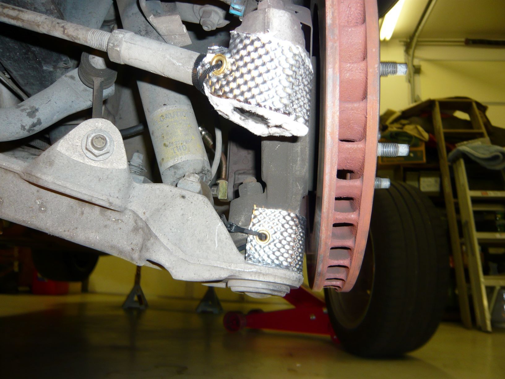

- I always ease off the pace for the last cool down lap, use the Cool It upon exit, park with the hood open to cool the drivetrain between sessions. I've measured front rotor temperature at 550 deg after cool down lap and parking, so I insulated all tie rod ends and lower ball joints:
