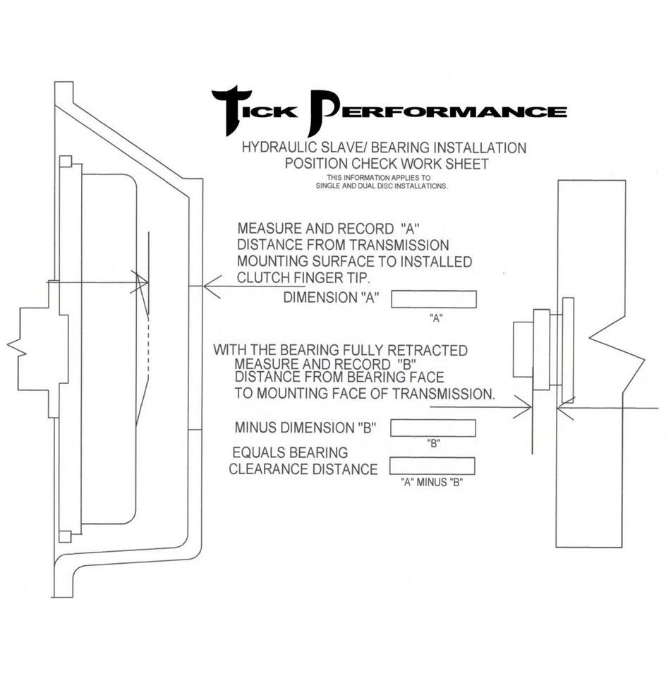

I got a monster stage 2 single disk clutch, this is my first clutch install, ok the friction plate came with a cardboard material on both sides, do you remove it? And it looks to be glued to the surface what do I do? And how do you all measure the new slave cylinder gap? Thanks
