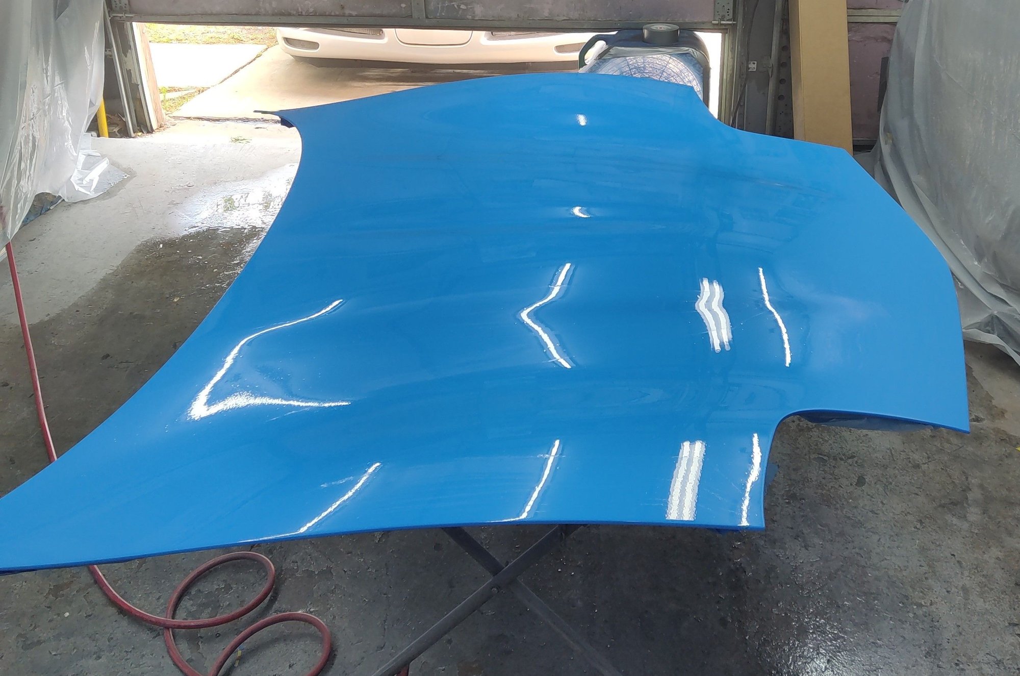

well shes almost all back togethor now. got a few odds and ends to finish up. this is about 15hrs after it was sprayed and just put back togethor. still has to be wetsanded and buff the whole car. theres 3-4 coats of high solids clear on everything blue. son as i plan on reclearing the black top this coming week just so its all nice and fresh. i believe this is day 7 or 8 since i started this project, all done entirely by me and i have a full time job so weekdays arent always productive.
and heres what she looked like a few weeks ago..

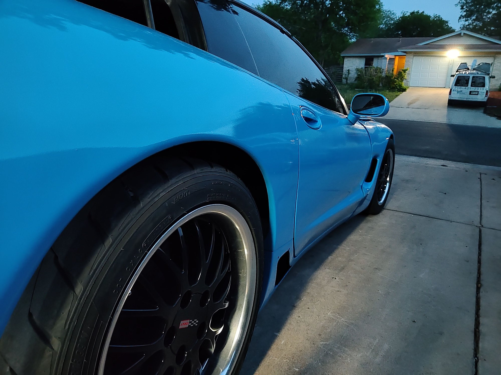

heres a little teaser. working on jambs now and debating on wether or not to pull the doors.off. are c5 door hinges usually sprayed body color like most GM's? Reason I ask is one door has black hinges and other door theyre painted to match. i kinda like the idea of them being black would be easier to keep them looking clean

Nice of you to save this car -- it's in great hands. I haven't seen a C5 in this scheme myself, and I like it. Are you considering stripes on it?

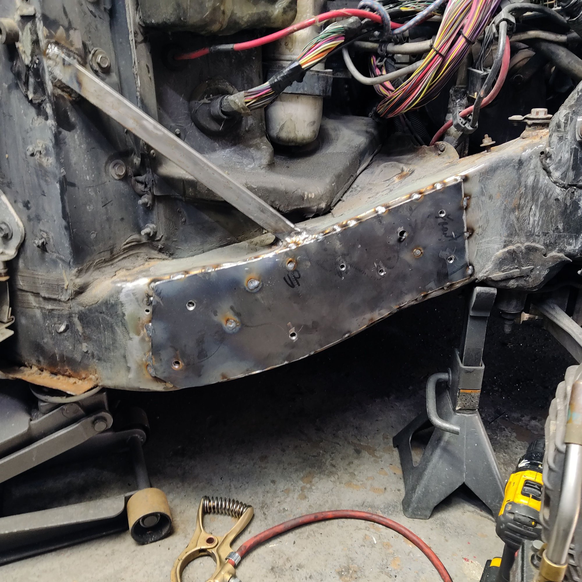

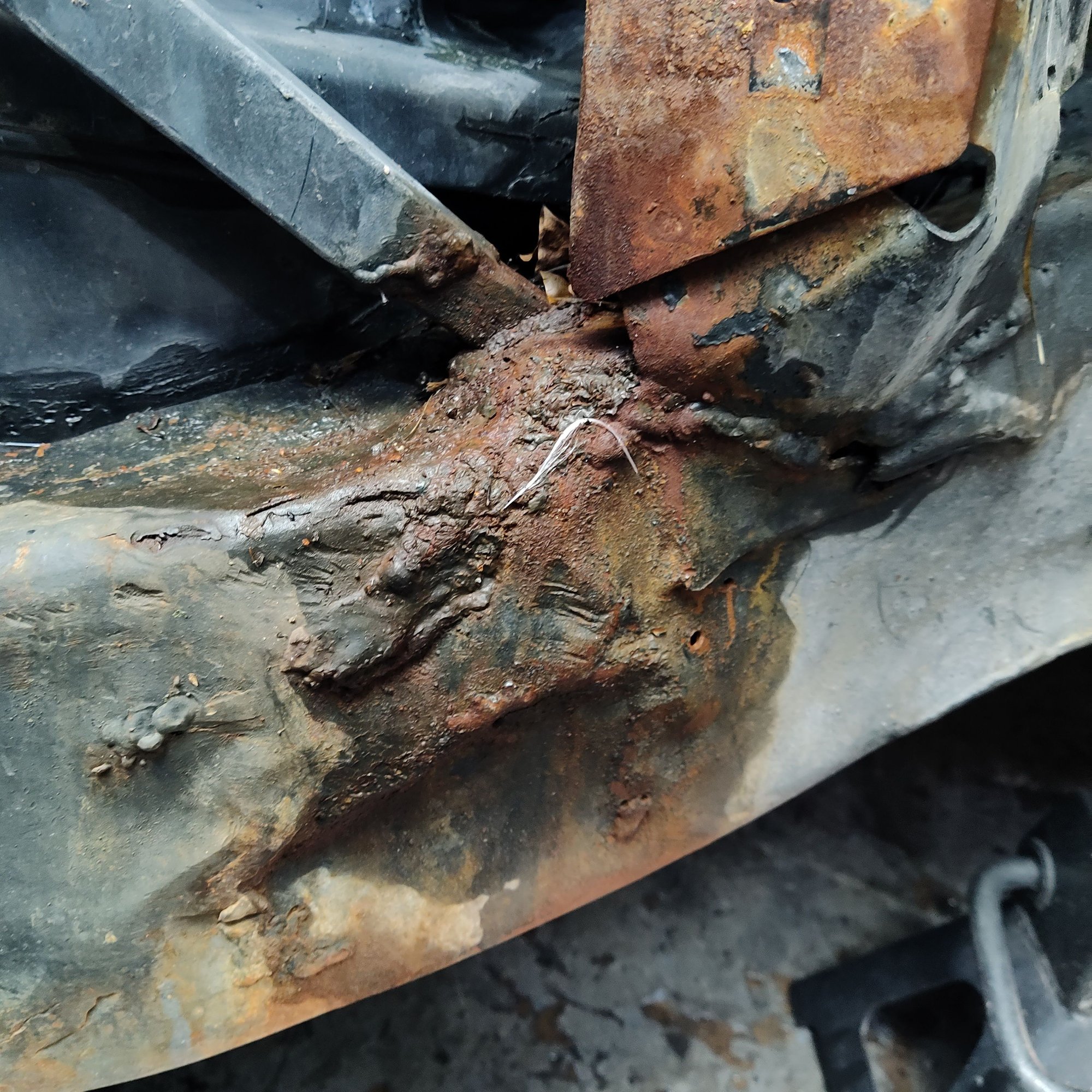

well i wouldnt say ive saved it as it was totaled in 2001 with under 20k miles. and someone else "rebuilt" it and its seen several owners since then. i did however make it safe to drive and im working on breathing new life into it. I've got pictures of the right front frame that was "repaired" by someone who had no business using a mig welder. i was amazed the car made it almost 50k miles the way it was. I'll post some before and after pictures of the frame here in a bit.

That repaired frame is special -- I left the bicycle industry before hydro-forming was implemented -- it is an awesome process that enabled all kinds of new "twists" to a lot of industries. I am wondering about the strange shapes the people repairing it must have had to match. Probably a pretty challenging act compared to 90 degree flat surfaces all day.

i have no clue what they were attempting but what i did is probably better called reinforcing than repairing as it was already bent back to shape. however what i did was i made a cardboard template to match the side of the rail then transfered that onto flat plate and cut it out. then i started at one end and tacked it down then everyone 3"-4" i drilled and tapped holes in the frame for 1/4-20 bolts and used those to pull the plate into the shape of the frame one area at a time. tacking it down as i went along the edges, then i removed the bolts and plug welded the holes up.

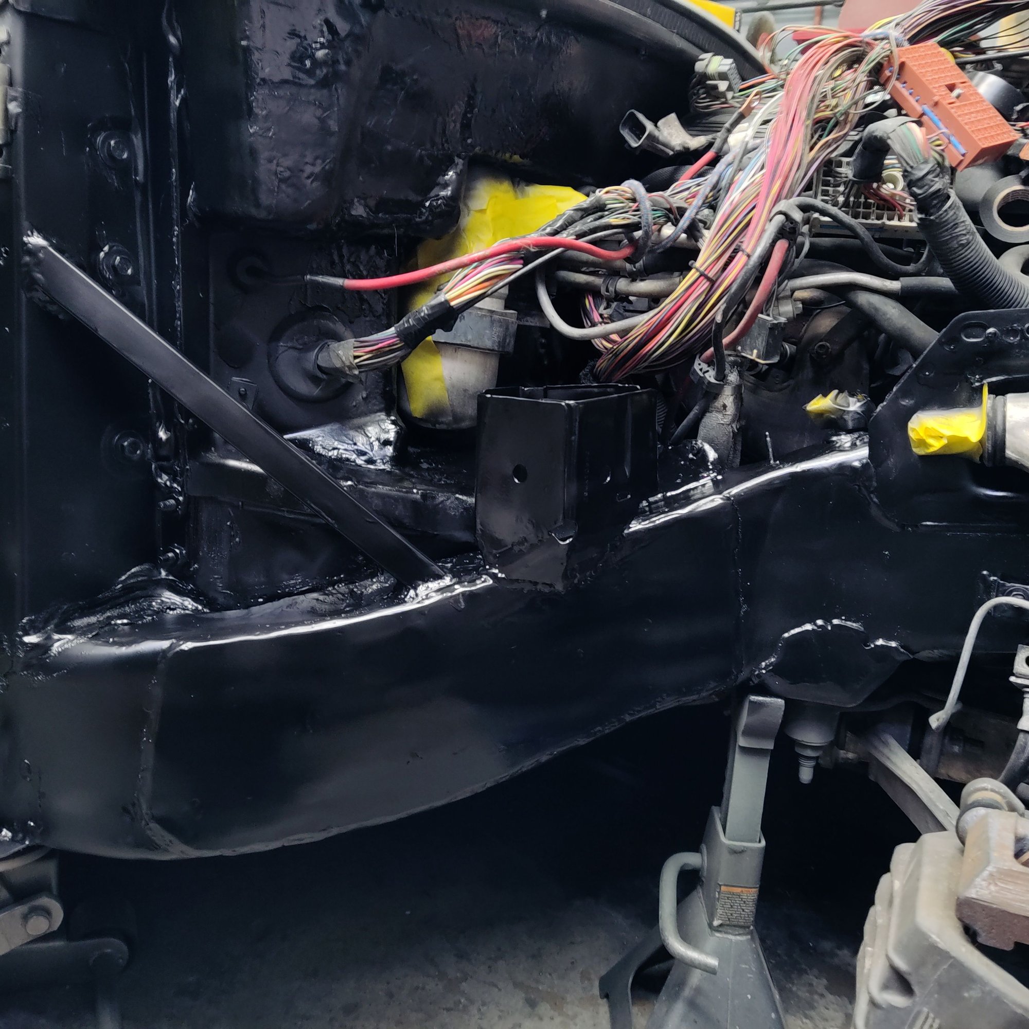

been meaning to post these but ive been busy working on finishing the color change. car should be bck togethor this evening so plenty of rapid blue c5 pics will be up soon. in the meantime here's a little before and after of the nice surprise i had when i removed the fender to gain access to the vacuum canister when i was fixing vacuum leaks. As youll see vacuum leaks were no longer a priority, and I began making what i consider to be a much safer repair.

Wow! Much better! That's a repair you can be proud of.
