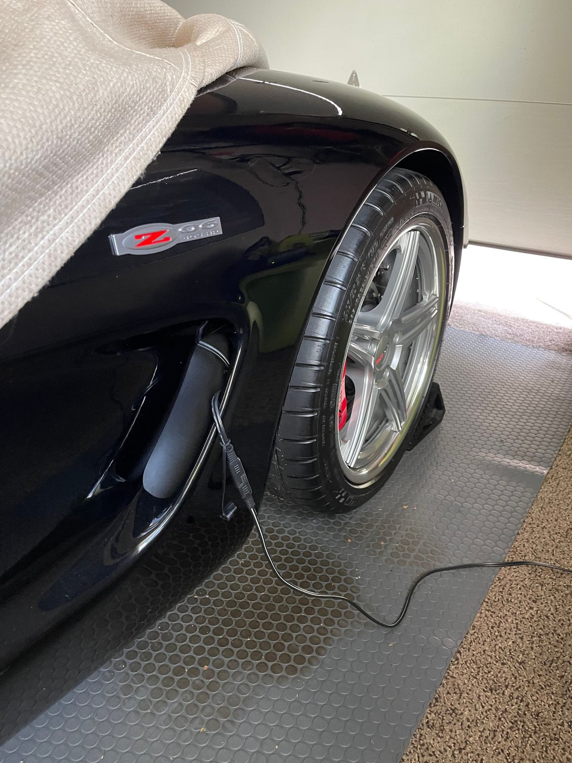

This is what I did.

That looks great Lead One, but because of my situation it would have to come out of the left Gill. Are you able to fish the lead directly to the gill or do you have to drill a hole some where. Also, how do you secure the connector so it does not flop around while you driving?

I don’t see why your idea wouldn’t work. You’ll need to lengthen the dual wire some and you could attach it to the firewall or hide in under the wiper tray. It’ll work!
BTW… no holes drilled just need a coat hanger to snake it through to the cove.

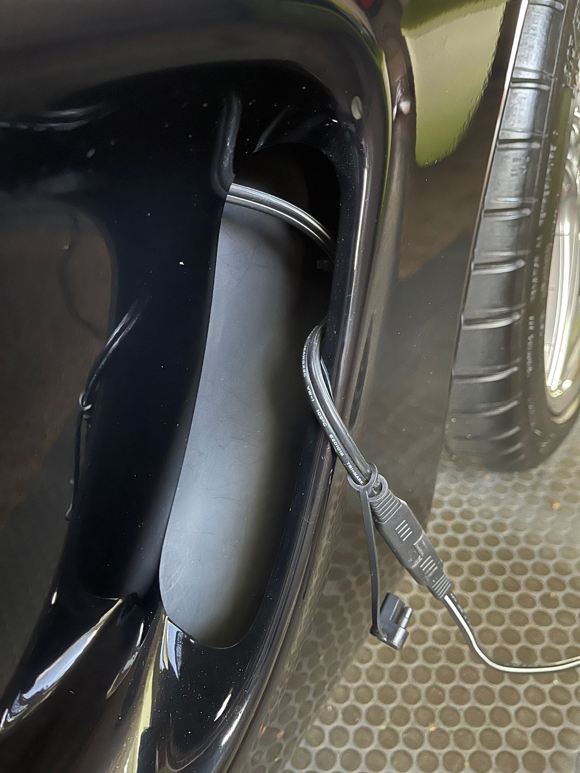

I ran wires to the passenger side fog light cove and put an SAE socket there for a SAE connector from my maintainer. When I am ready to go, I just pull the plug from the cove and back out of the garage.
