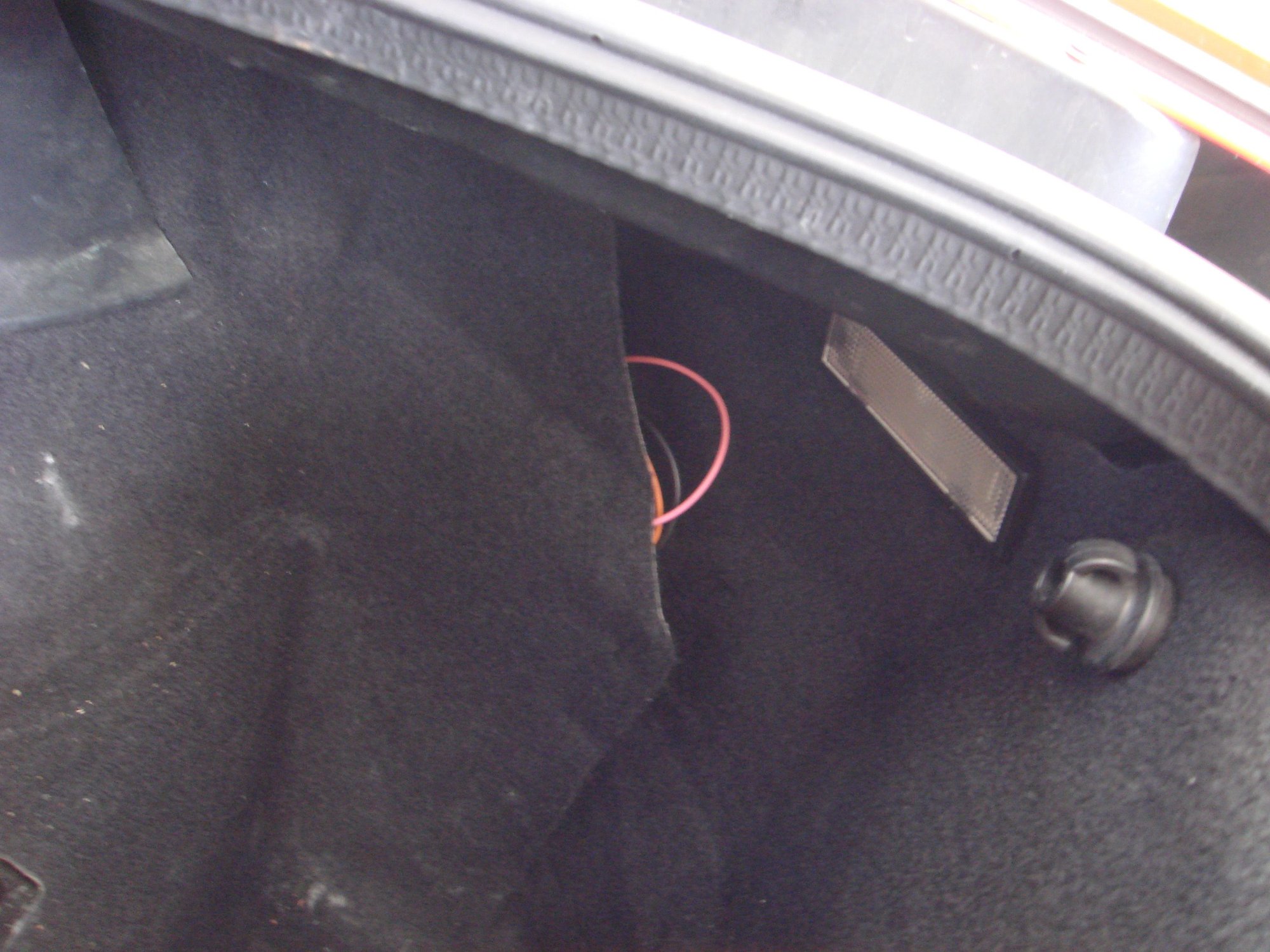

The carpeted panel is easy to remove to get access to the antenna. The pink wire is the power wire.

I started this thread and have tried all of the suggestions from my fellow Corvette Forum members. I removed the far right taillight and could not see where the antenna plugged into a harness and thus could not disconnect it. I removed fuse #24 and the antenna did not rise. However, the CD player does not work without #24 inserted. Finally, I removed the carpeted panel after removing the trunk lighting fixture and the two cargo net holders by unscrewing them. There is the infamous pink wire... Snip and the issue is resolved. I don't like to cut any wires in my car but this, after trying all the other suggestions, was the simplest way to fix the antenna issue. I never use the radio and could easily reconnect the wire if necessary.
Thanks to all of you for the excellent information. BC
