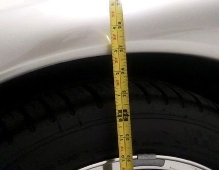

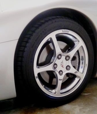

My front air dam seems to scrape on just about every bump or dip, and being in FL most driveways have some curvature...
The car is a 2004 coupe with stock size tires. I have had the car about 4 months and wonder if the previous owner may have lowered the front end. The lip of the wheel opening is about 26 3/4" off the ground. Thoughts???

Your car doesn’t appear to be lowered. That center air dam will scrape regardless of ride height. It’s a consumable part.

My unmolested 02 vert is 27" front, 28.5" rear with original size tires. (59,000 miles) Still challenged on some driveways and speed bumps.

^ this. You car looks to be at stock height to me.

I agree that it is stock height. I am stock height and scrap every single time I pull out of my driveway. Believe it or not, the car was actually designed to do this. Now, if you start scraping your radiator support, then you have a problem.
