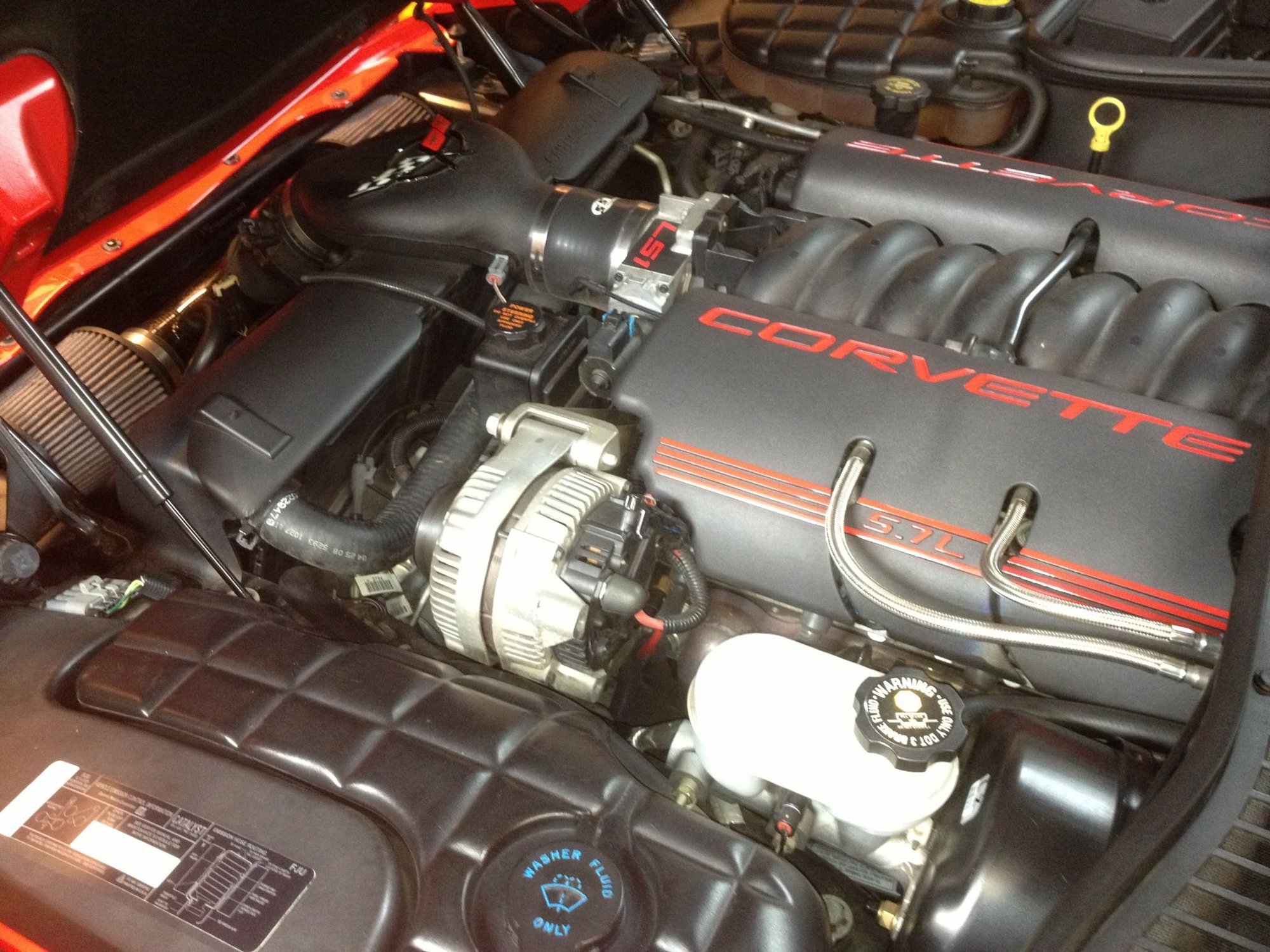

I detailed the nasty engine of my 02 a few weeks ago...
Full strength Super Clean all over. Agitate with a few different scrub brushes. Rinse off with a nozzle on the hose. Dry about 90% with the leaf blower. Fantastically cleaned engine bay with no ill effects... I think I re-treated a few areas that still had stubborn grease/dirt on them...
I guess I am not concerned about water getting into any electrical connectors since they are all weatherpack water tight(supposedly) connectors.
ETA:
It doesnt look great due to corrosion on all the aluminum from years of neglect, but its super clean of dirt and grime so all that corrosion shows through. I put some dressing on a lot of the black plastics and what not after this pic and re-installed the FRC's...

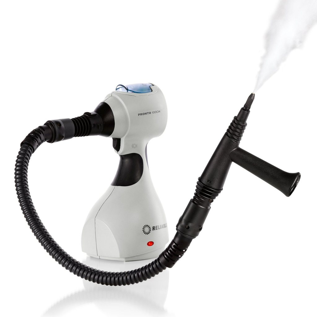

Anyone try one of those low pressure steam cleaners? supposed to work well, I have one sitting in the garage, haven't used it yet. cleans with water but very little.
To Engine detailing without degreaser.
