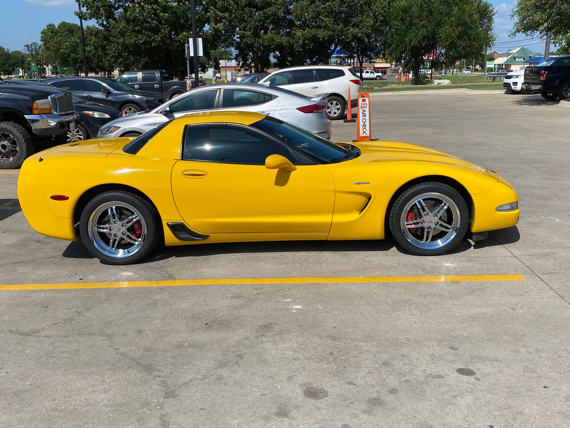

I bought an 02 6 months ago. Took it in for some new tires and low and behold the front and rear passenger side wheels were pretty damaged from a pot hole. Rides fine but one shows a small crack on the lip. One will not totally balance. So, I am getting to buy new wheels. Told the wife I have to! Stock size. Is there any advice you guys would give before I buy? I am looking at a black finish, its a yellow now with as much blacked out as possible. Any brands to stay away from? Any materials to stay away from? Any great looking wheels for an 02? TIA

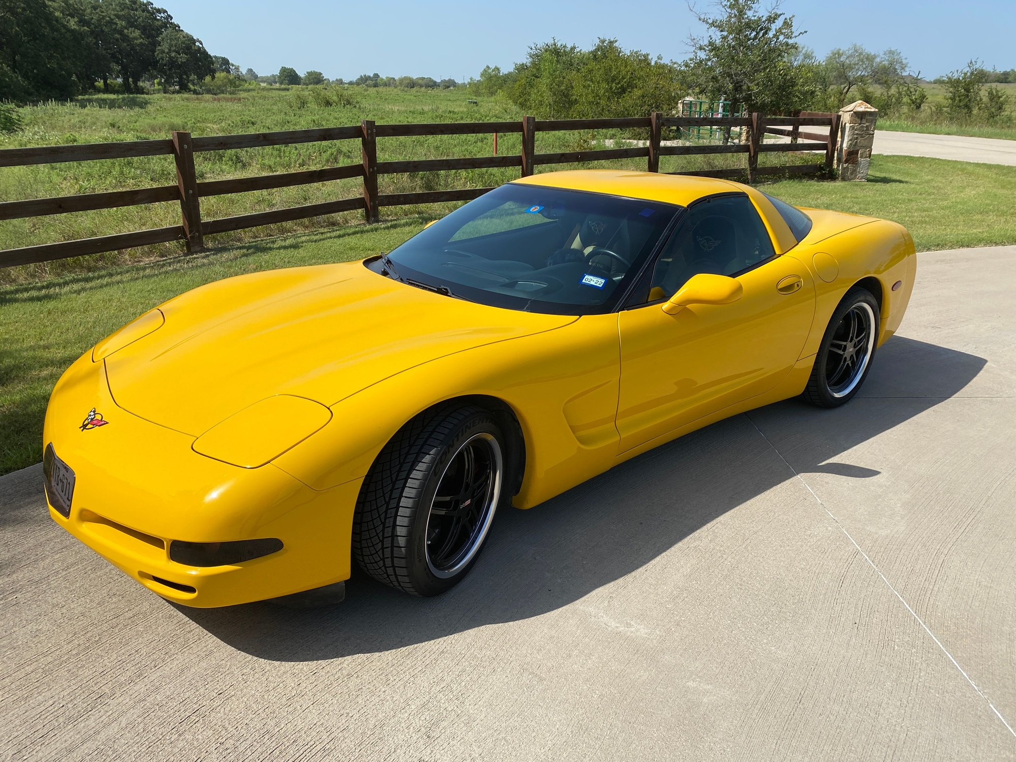

Thanks for all the help folks. I went with black cray scorpions. I learned a lot about wheels. I mounted Continental DW 06 on all four. 18" on the front and 19" on the back. The ratio is very close from front to back with the rear wheels .1 inch smaller in diameter. No rubs. No tcs issues. Thanks again.
