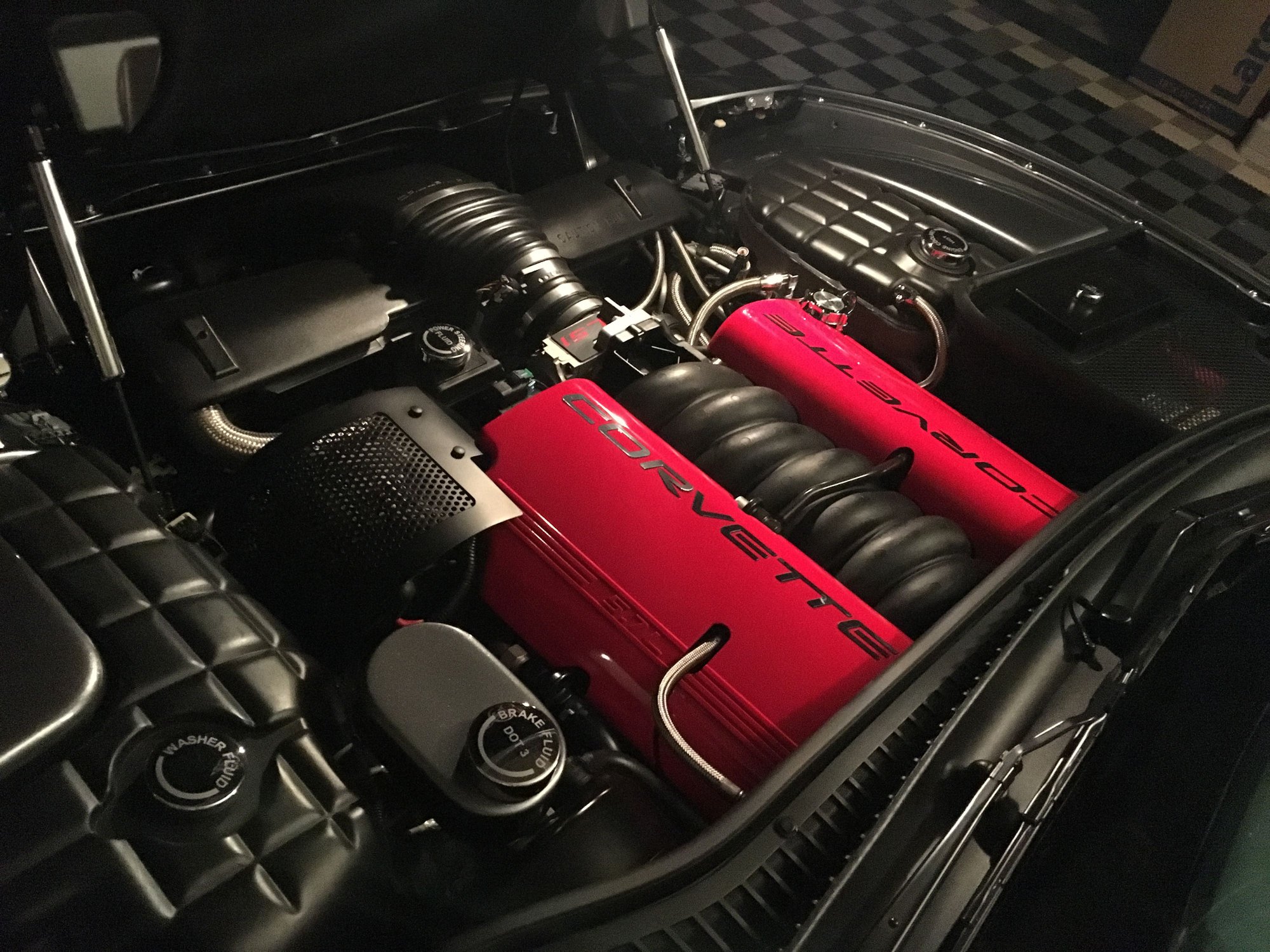

That really is not a cold air intake unless you open up the front fascia to allow cold air in. Otherwise it just takes air from the engine bay like the stock air cleaner does.
If you want a true CAI, look at the Vararam or the Callaway Honker (if it is still made).
And I agree, on a stock car you will not see a 15 hp increase with just that mod.
Callaway Honker!
Love mine because it expands on the C5 bottom feeder design. Hopefully they still make them.
