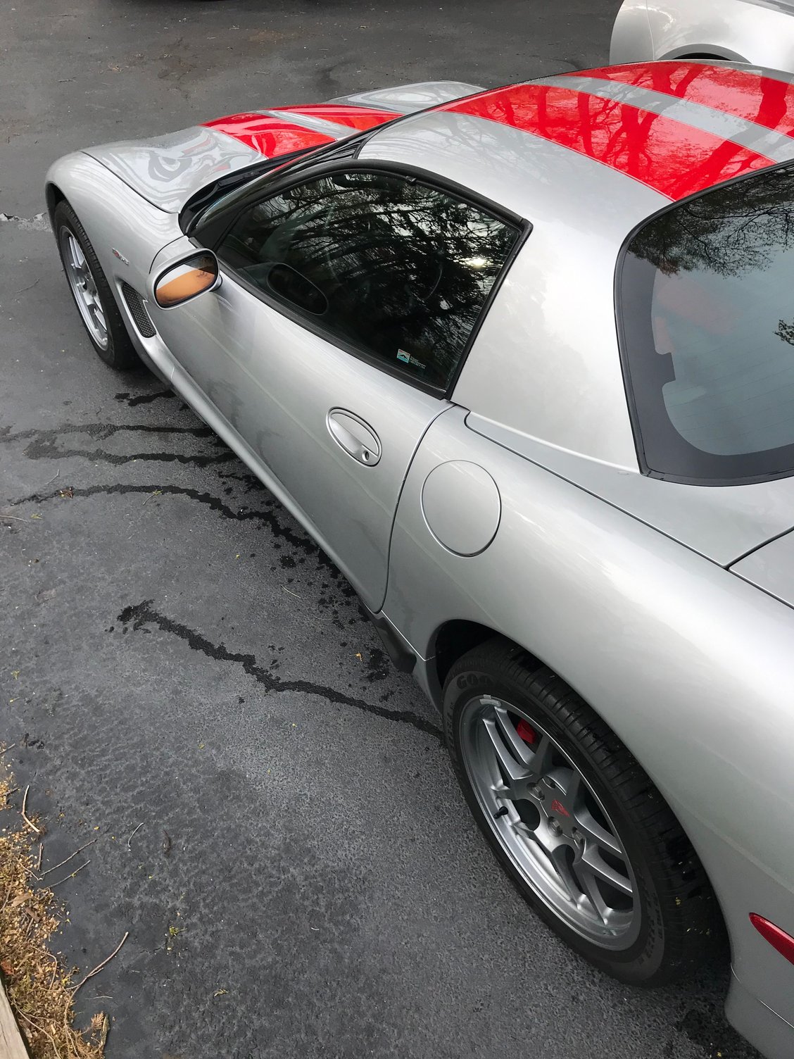

Just turned 20,000 miles on my 01. The only issue I've had, actually have, is a grinding headlight gear that I haven't gotten around to fixing. As far as H.P. , a bottom breather, headers which eliminate 2 pup cats, removal of the screen in the throttle body and a little tuning put it in the 405 H.P. area.
