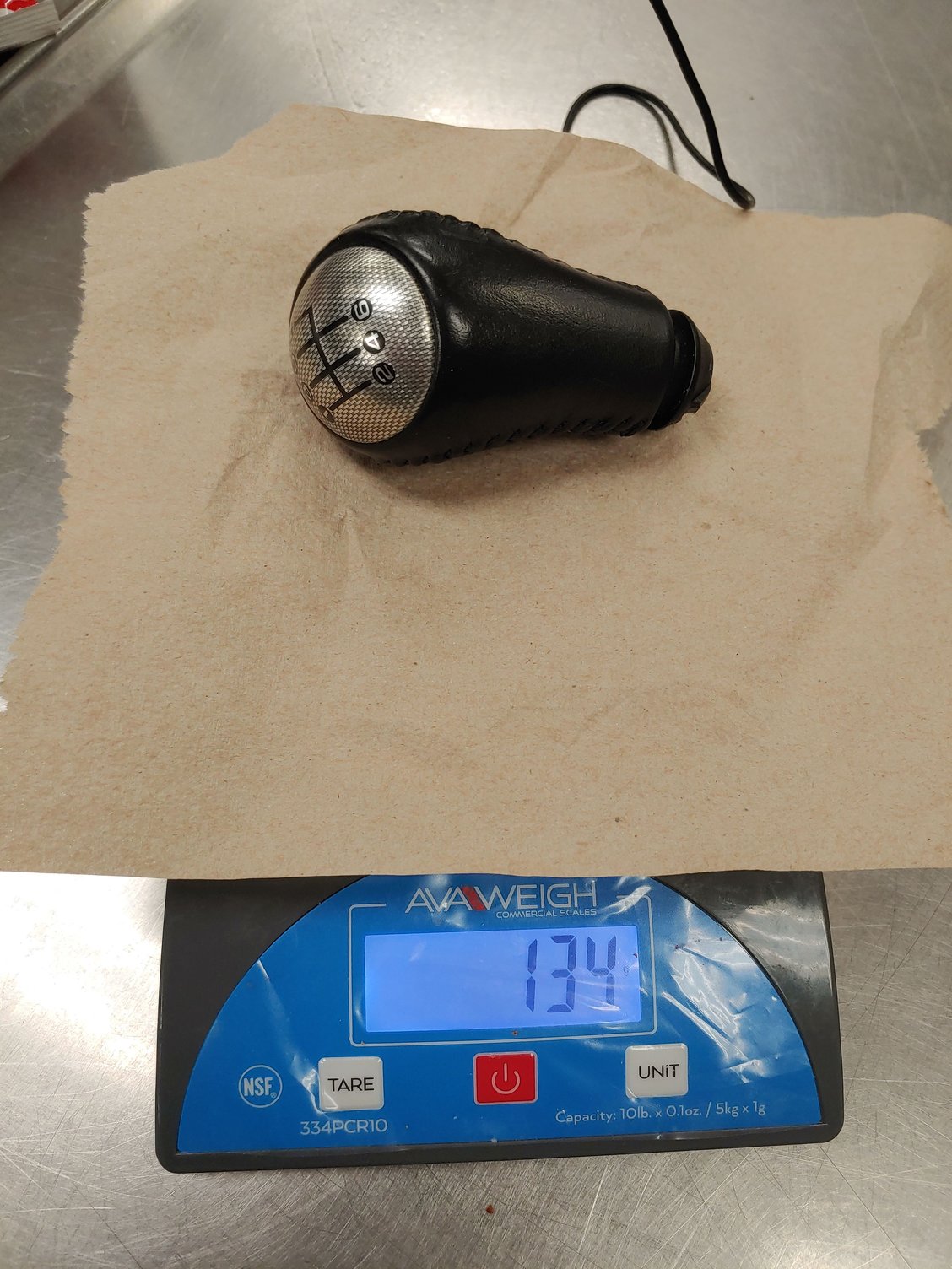

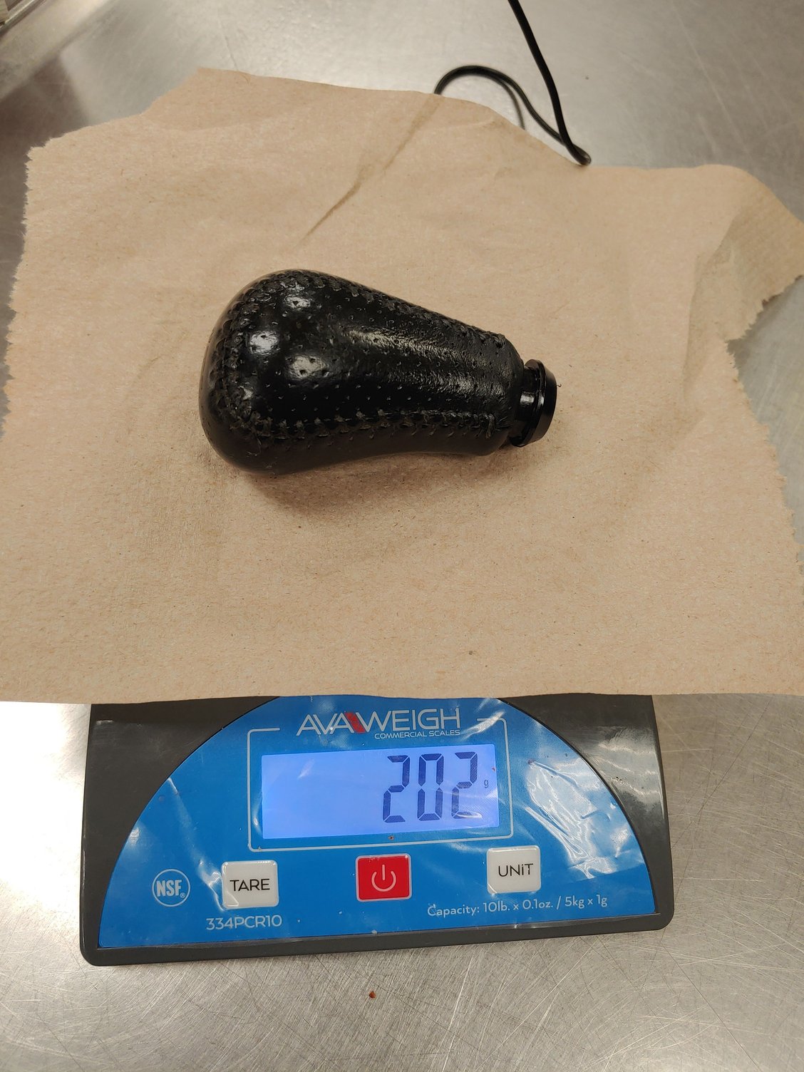

So got these weighed. Obviously some of the aftermarket shift ***** list weights, but I don't have a C5 **** to compare unfortunately.
stock 03-05 forester ****
Almost stock C6 ****(set screw hole cut off)

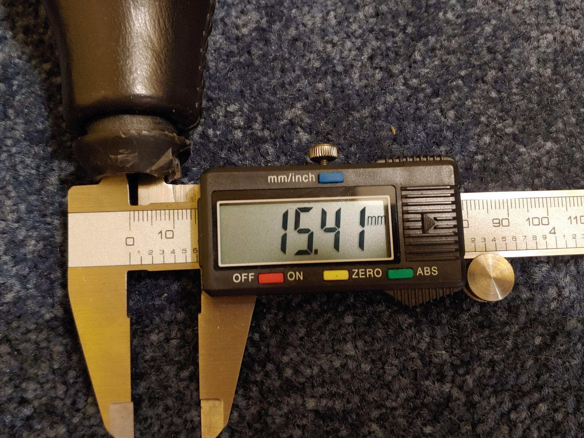

By feel alone, I'm surprised it wasn't double the weight honestly. For reference, most cue ball shift ***** appear to be 170-190oz based off what I'm seeing online. As far as dimensions go the inner diameter of the insert(keeping in mind there is a shim molded in half way up)
And the outer dimension
Or 39/64" and 53/64" if someone was looking to tap and add an outer/inner threaded insert to use directly on the 9/16" C5 shift handle. I will say, whatever glue is used to keep the insert in the shift **** if you wanted to swap it, it is IN THERE. Couldn't budge it with a pair of pliers.

Ha! You didn't miss anything valuable. Thank you for confirming the weight of the C6 ****. I read online it was about 130 grams. Which is close to where you landed. The stock Forester **** being heavier makes sense. The C6 **** weighs the same as a cheap **** from AutoZone. Apparently the C6 **** has a weight inside it. Must be minuscule.

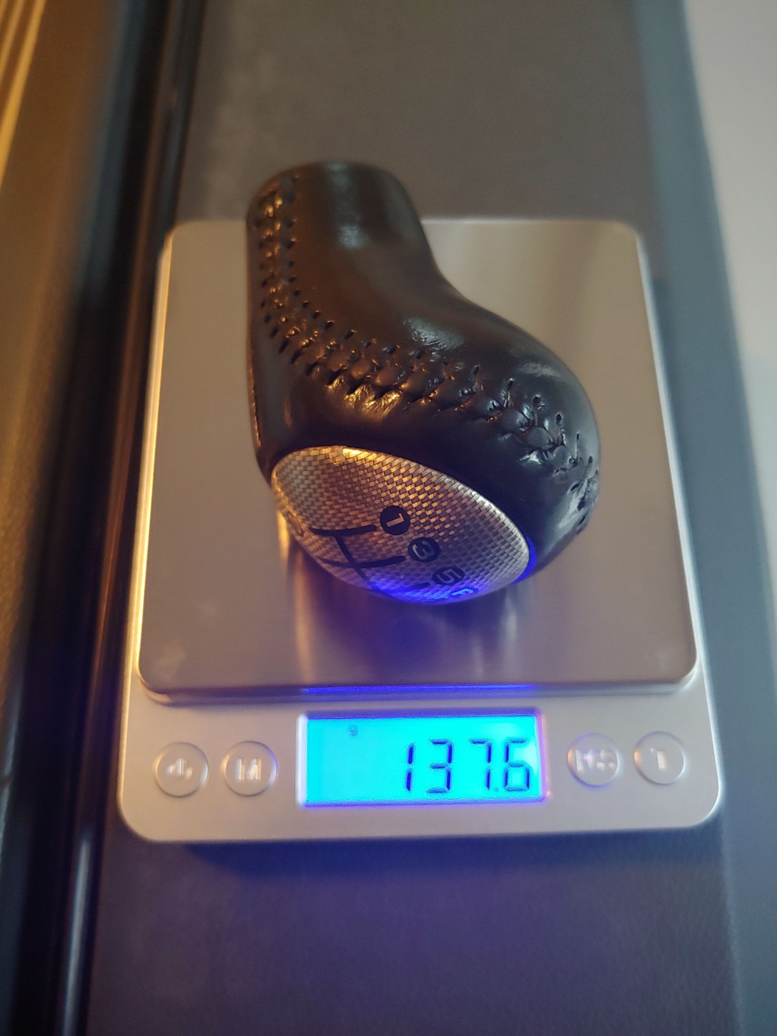

Here are my findings as far as weight on both the C6 **** and cue ball. The modified C6 for C5 **** (carbon fiber pattern cap) that I bought many years ago (2006 to 2008 timeframe) weighed in at 137.6 grams. The Twisted Shifterz cue ball weighs 112.4 grams.
