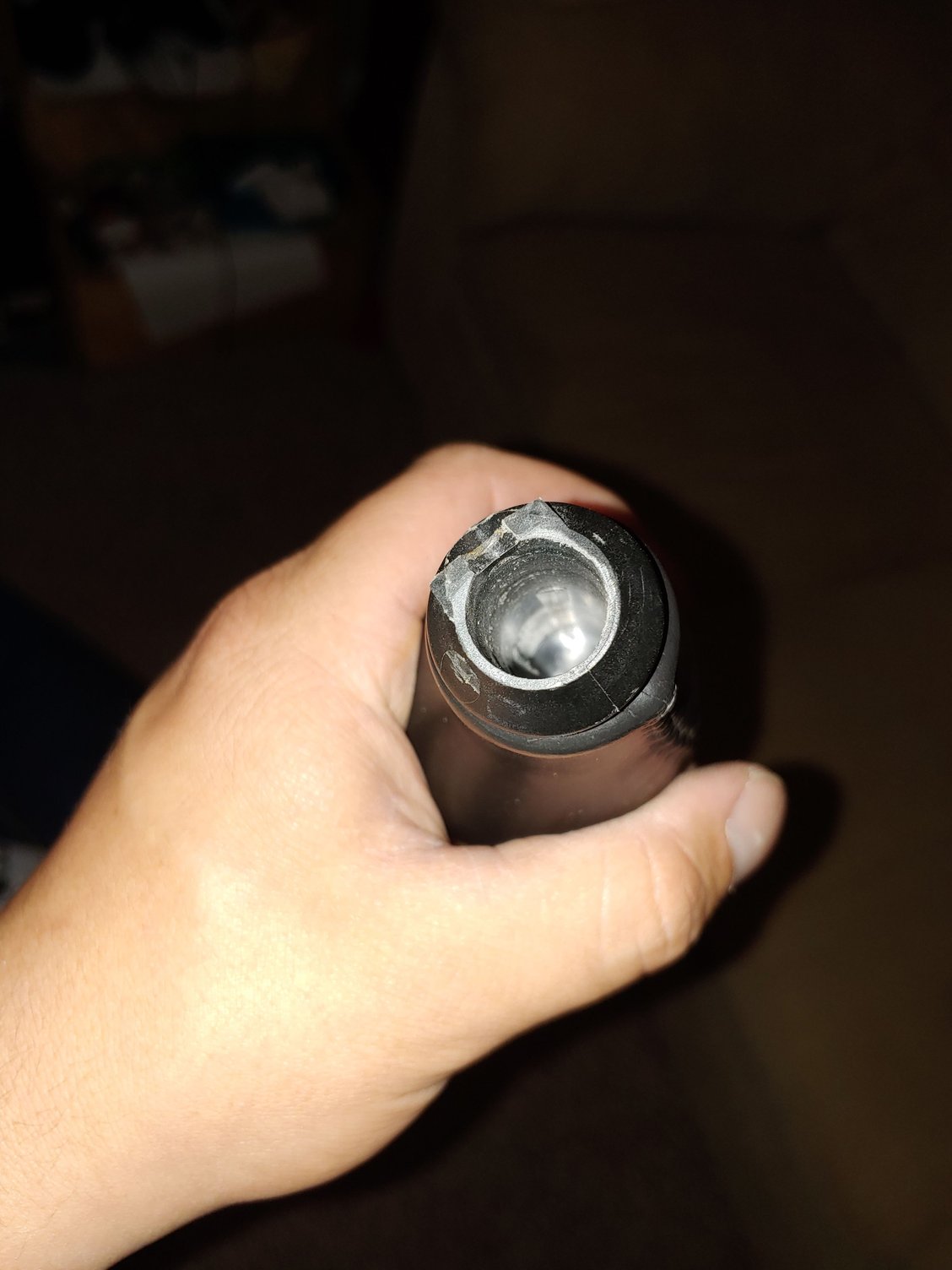

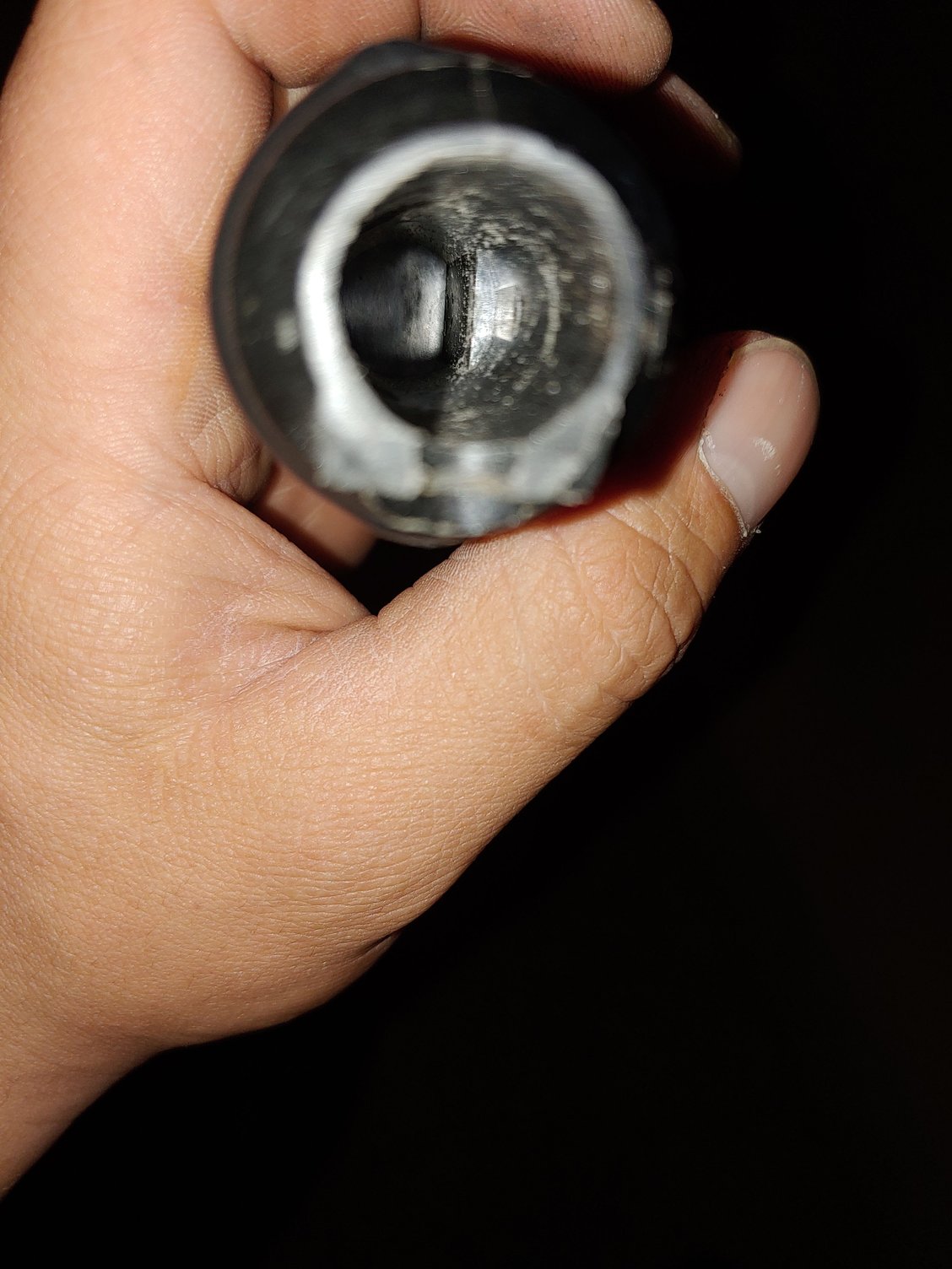

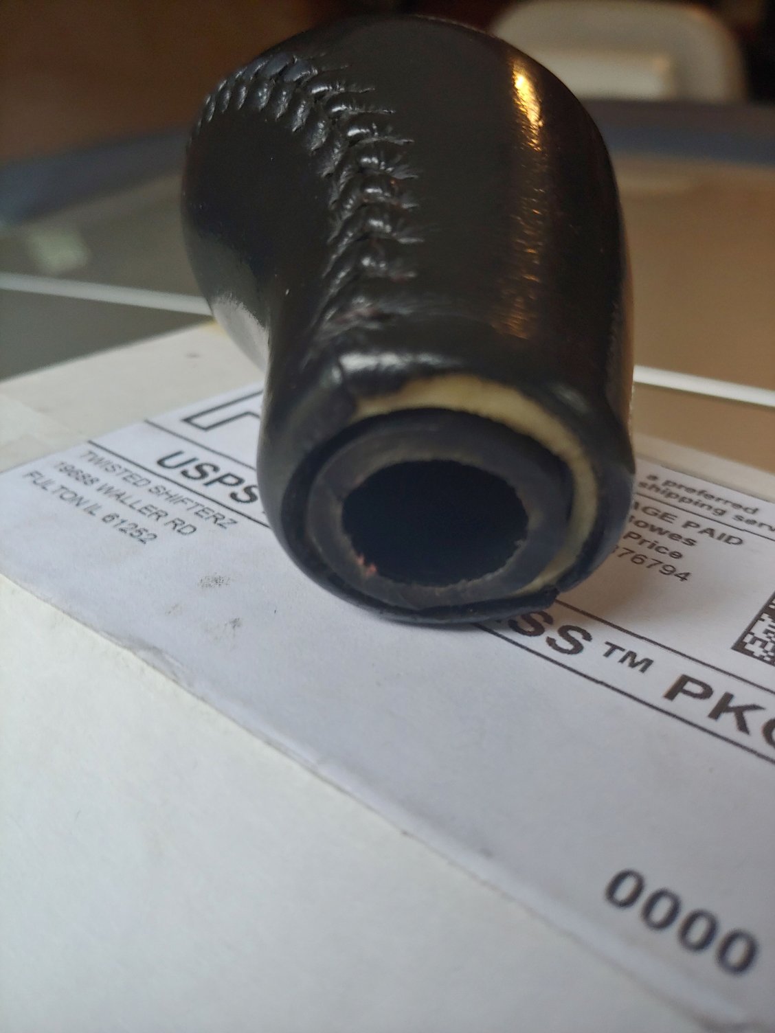

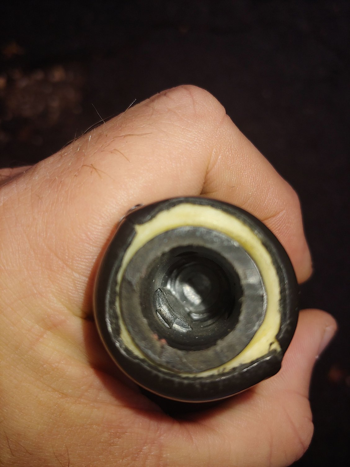

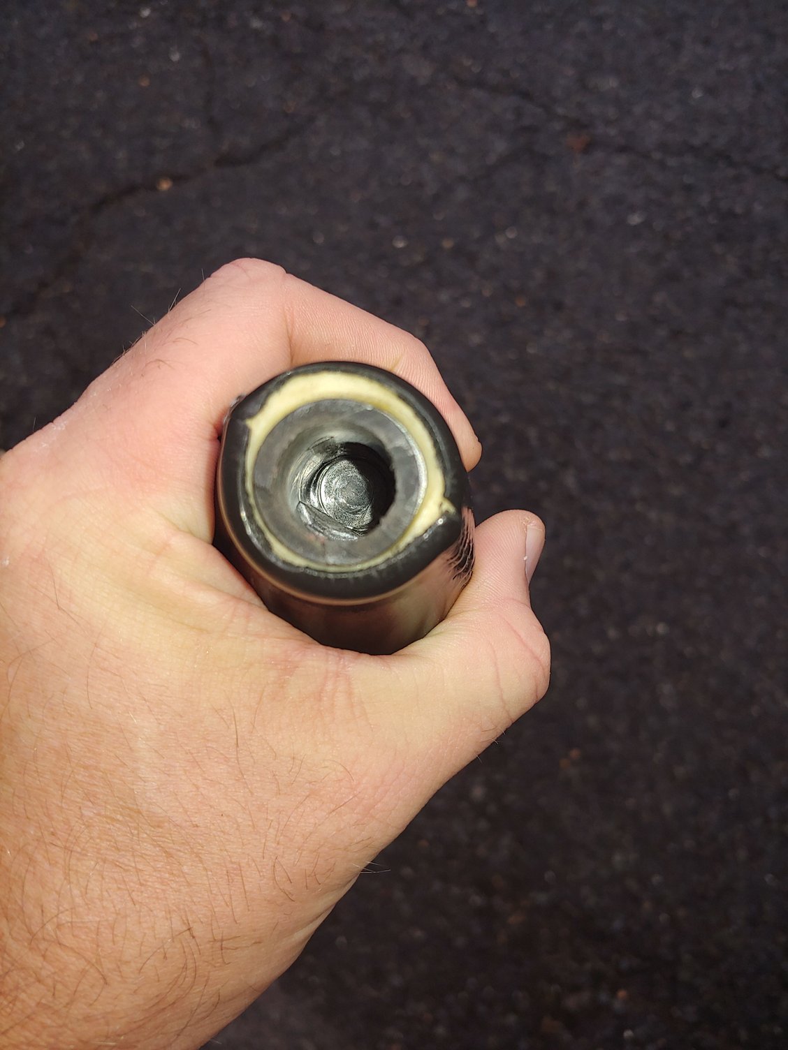

You're in luck, I just swapped mine out for a heavier weight **** (which isn't as aesthetically pleasing nor feel as good in my hand...but shifts twice as good as the lighter weight C6 ****).
To me it looks like the inside is shimmed and that causes the gear shifter threads to self thread the plastic that's left inside after removing the post.
Refer to pics below to see what I mean.
Looks to be shimmed

Gotcha. Interesting idea, don't think I can replicate it. To give it a bit of weight and really get it jammed in there, I think I'm going to go with some sort of adapter or maybe even just a lug nut

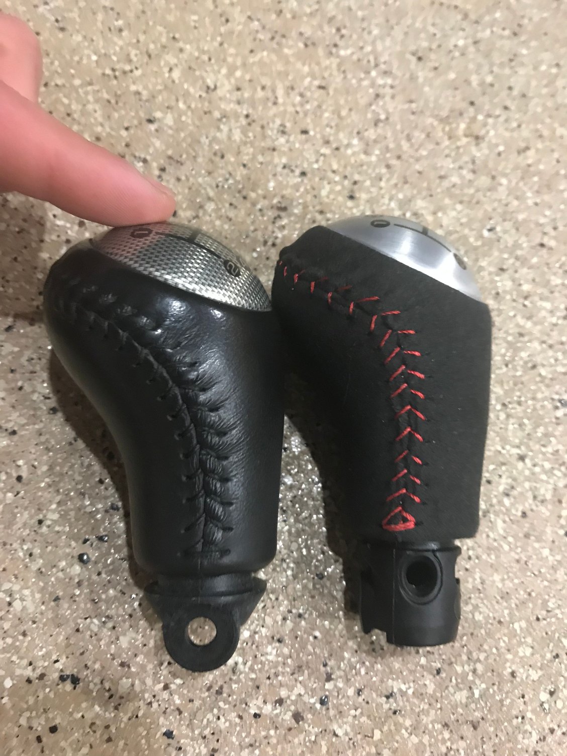

Well, if I'm seeing things right, the whole "modified to fit" may or may not be a scam 10 second mod​​​​​ by the companies that do it. Once I filed off the screw hole tab, I took a peak inside and sure enough, looks close to if not identical to yours.
I think all that is done, is the entire collar is cut off and you just thread a stock C6 shifter onto your C5 shifter handle lol.
This is going on my forester, and I was dumb founded to feel the factory shift **** honestly feels close to 3x the weight of the C6 ****. None the less, this seems like a pretty simple project. Both have a collar with the same dimensions and are the same depth, the C6 **** is just hollowed out wider. So I'll either remove the plastic insert entirely in favor for a metal female adapter or just get one that threads into the plastic, much in the same way it sounds like yours is.

Nice work! I guess "modified to fit" just means gutted. Lol!

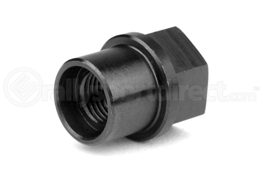

Same. I have a bathroom scale and that's it, fortunately I'm sure one of the shops at the tech school I'm working at has a gram scale, maybe even the nursing program.
I wasn't intending to remove the insert, as we saw it was shimmed, making threading it in the easy option. Unfortunately, the corvette shifter is 9/16(~14.2mm) and my shifter is 12mm. There isn't a single 12 to 15mm female/female adapter out there, nor a threaded sleave to accomplish the same thing. 12 to 16mm are near impossible to find(one on Amazon that'll arrive in weeks or 2 months), and I don't know if the plastic insert walls are thick enough to bore out almost 2mm.
So... to keep this semi-corvette related so this doesn't get deleted, there are multiple companies that sell M18 threaded shift ***** with m8/10/12 threaded adapters so they can be used on most cars. Tonight I'm going to measure the diameter of the actual hole in the shift ****, and see if pulling the C6 style screw connection and replacing it with one of those would do the trick. I see some older threads saying their modified ***** eventually strip the threads if driven hard. If the plastic of the **** is harder then the plastic of the insert, it might be worth someone making an x/x" to 9/16" adapter instead. The upside is, although it would really be a small change, the insert would be steel instead of plastic, at least adding a little umph to the ****.

The M18 adapter may work. I also think Holley makes one for 12mm to accept a Hurst Shift *****. You can also look here:
