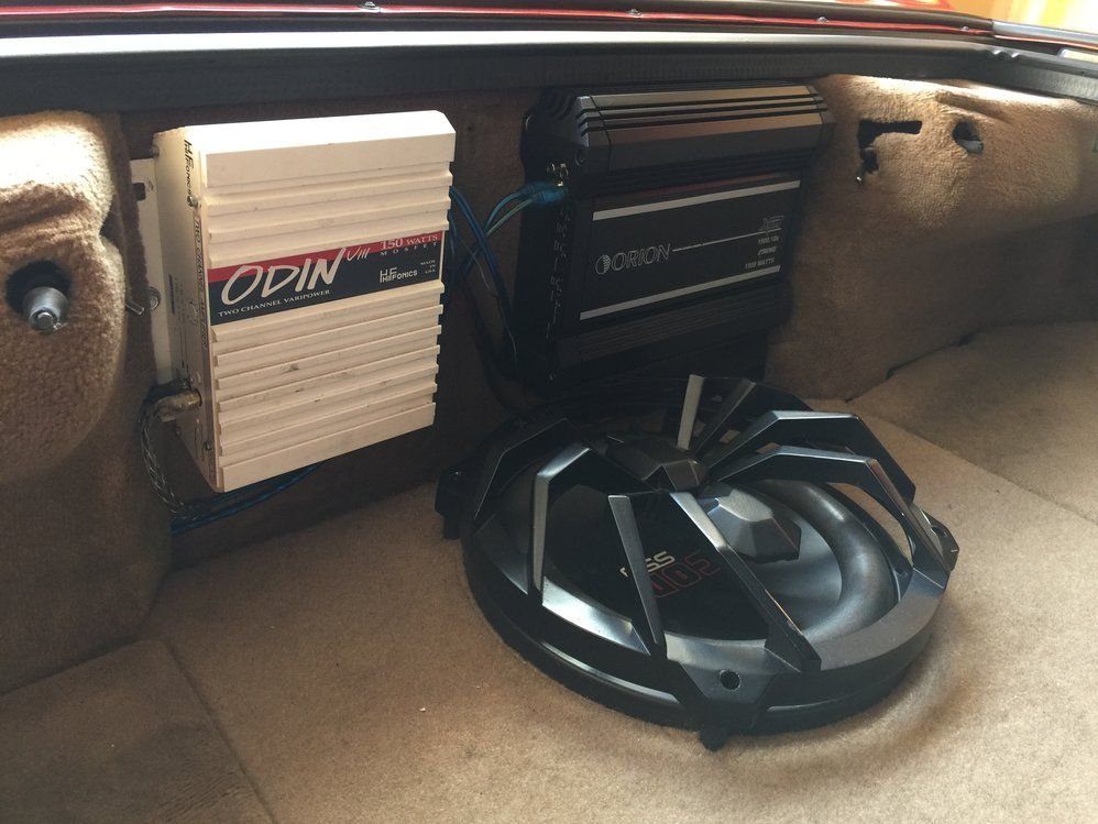

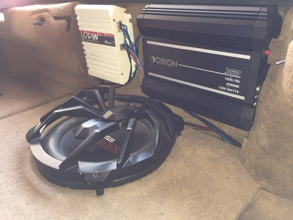

Ahhh that Orion amp was tested by either BigDWiz or Budget Gem or Budget Bust and put out way more than rated power. Good pickup there.
I am both. My car is shockingly loud, but from the outside, there's no rattles or noises. I'll have to take a video of it now. haha
Old Nov 1, 2021 | 08:39 PM
jdmvette's Avatar
jdmvette
Night Owl for life
Joined: Nov 2003
Posts: 24,717
Likes: 4,555
Yeah this Orion amp is insane. Easily handles my 1750rms SSA sub.
My circa 1992 original Hifonics Odin 2 channel amp is no slouch on the dyno either!
I'm the original owner and bought it back when I was 17 in high school

Dang! That's amazing. I was two.
Surprised that XCON has enough room to breathe in there!
