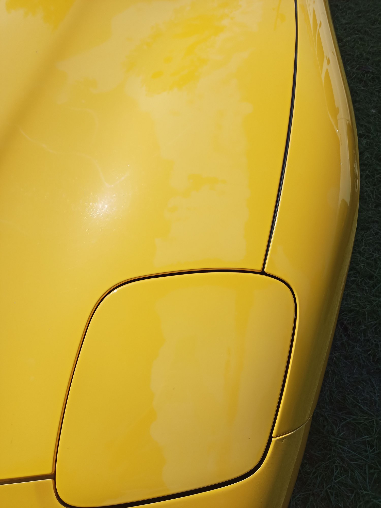

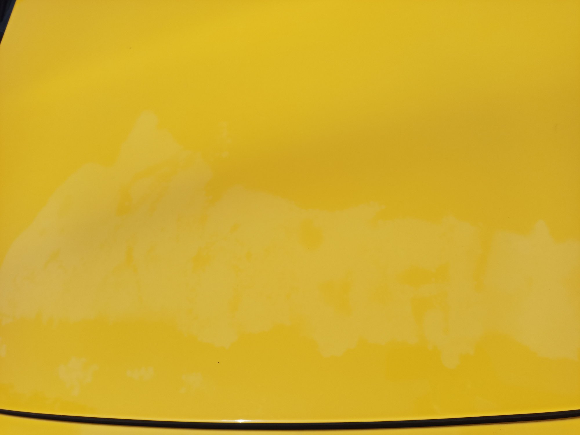

Old Oct 9, 2021 | 03:57 PM
My Vette Life's Avatar
My Vette Life
Joined: Mar 2015
Posts: 3,638
Likes: 245
Kinda hard to see but I see it and that is definitely clear but I'd say first layer or so. You be wasting you time and money trying to wax or compound it by hand. I'd get a real DA unit and some compound like meguiar's
or an all in 1 compound from 3D with a cutting pad.
Harbor freight has a DA system that's good to start with and I been using one for 3 years now.
Get some pix of the hood in the shade @Jammer4ut

Almost looks like a stain but hard to tell with yellow.

Thank you for the advice. I will try the DA and see what happens. I still can't help but think the cover lifted the color, but don't understand why it would have. I'm going to contact Seal Skin and see what they have to say.
